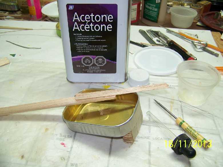

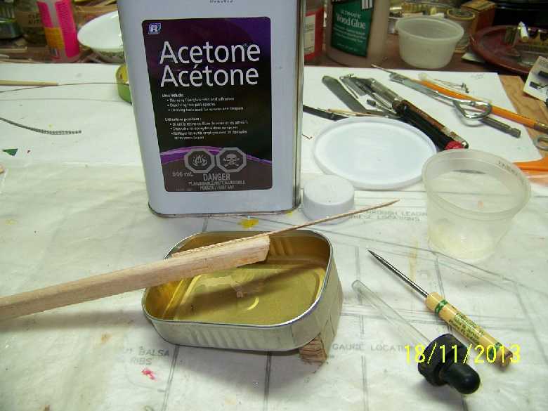

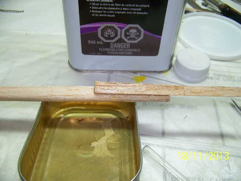

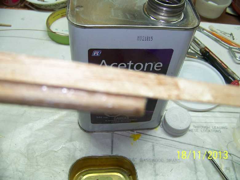

Zor 11-18-2013 08:26 PM
4 Attachment(s)
Originally Posted by Toysareforkids (Post 11665753)
I have used acetone on the job every day, for the past 40 years. I don't know of anyone to have a problem with it in my trade, of Tool & Die and machinist, and I know alot of them. There maybe someone, but I never heard of them. Plus I use it at home, and so does the wife to remove nail polish.
Pat
Hi Pat,
As I predicted I would read negative comments.
I do not read the type of usage nor the possible amount used.
Women use just a few drops to remove their nail colors.
That nail color is like dope not like CA stuff.
I have experimented in softening CA with acetone. I had to keep it acetone-wet for many minutes which meant to keep applying the acetone as it evaporated fast. This fellow has a whole length of leading edge to unglue if I understood well his predicament. I do not know what method he was thinking of using to apply the acetone. I can only figure that a whole length of 12" to possibly 30" or more. That would mean many square inches to keep wet until possible separation.
I glued a small piece of 1/16" thick balsa on a piece of scrap leading edge using thin CA. It does not matter in what format it is glued on but there is an area of glue to be softened and get separation of the pieces. I first applied acetone to the section not glued to see how long it would take to have he acetone go right through the 1/16" thickness. It took less than a minute and I had my finger all wet passing it underneath.
I then applied the acetone to the glued area using the eye dropper and keeping it soaken wet for 15 (fifteen) minutes.
There was no way of separating the pieces. I then could only think of 12" or much more of glued leading edge sheeting.
I am satisfied with my experiment.
Zor
Edit to explain the last (right) picture. It was an attempt to show that the whole surfaces were all wet with acetone for 15 minutes. I must have used 3 or 5 table spoons of acetone to keep it soaken for that 15 minutes.
