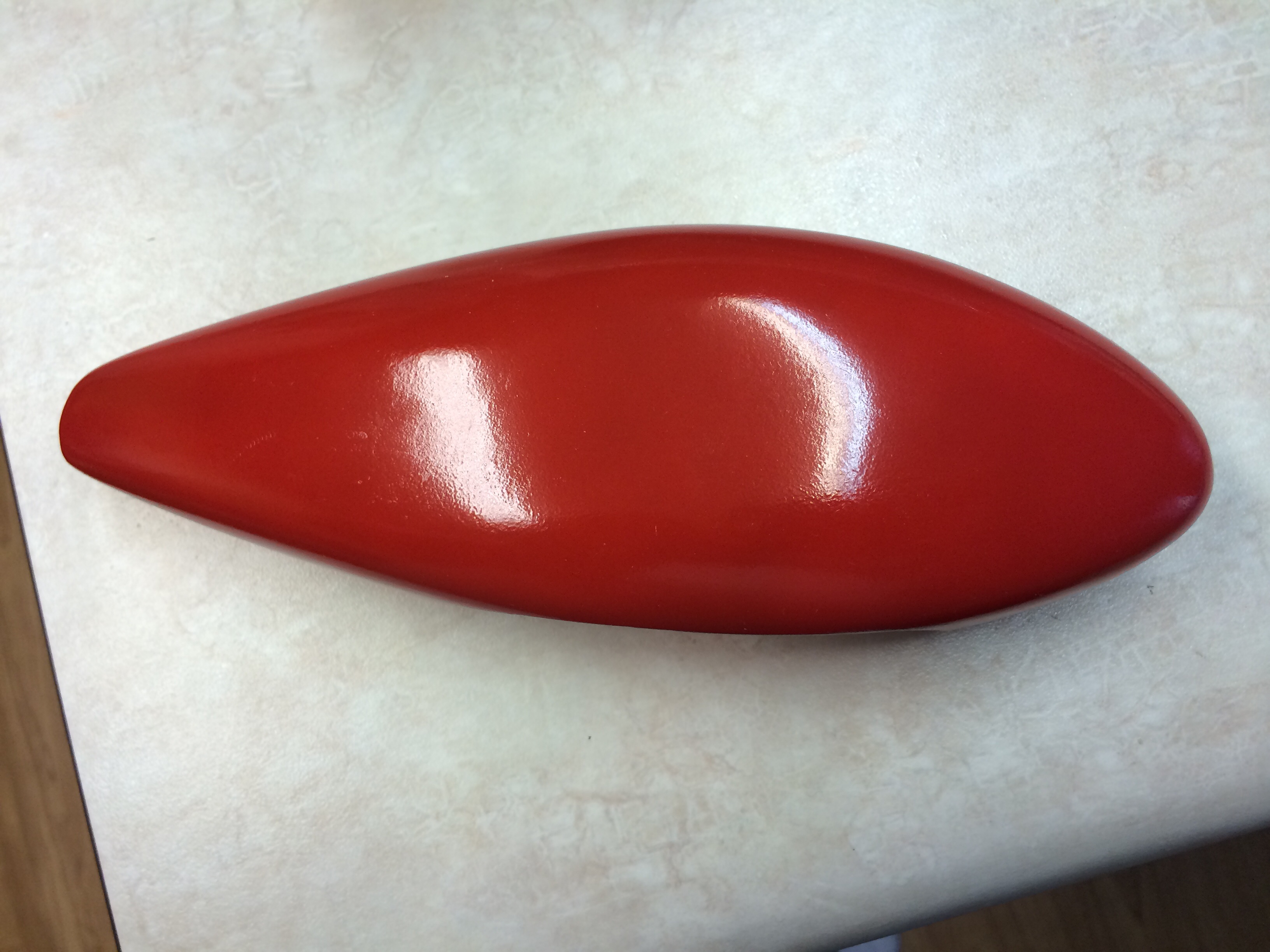

Lastly I spray painted the wheel pants last night and started to think that it's not fuel proof. Anyone recommend spray on fuel proof clear coat? I have seen some Testors brand clear coat but don't know if it is fuel proof.

Thanks for asking. I almost had it done. Gluing the canopy is giving me fits. The back plate has a little flex in it and I tried gluing it a couple times but still has a bit of flex. I had the canopy glued in place and when I put it on the plane it was at the wrong angle so I took it off, reglued it and this time I had it on but then moved on me. I was wiping the canopy glue off the canopy again and got debonder on it. So now I am in the process of just spray painting the canopy black with that Top Flite spray paint. Also I had the wheel pants painted with Krylon for Plastic and decided I wanted to put a clear coat on it so I wouldn't have to keep repainting it if fuel got on it eating away the paint. I guess I should have just used the Top Flite spray paint for it too but didn't think about it unti now. Anyway I had one layer of Top Flite Crystal Clear on it, it dried well, put a 2nd coat on it and on one of the pants when I was setting it in place to dry it fell on the ground so I had to remove the clear. In the process it took some paint with it so I have to repaint it. For the other wheel pant I checked it this morning and it has a haze on it. Don't know what happened there and don't know if that can be buffed to a shine or if I also need to remove it and repaint.

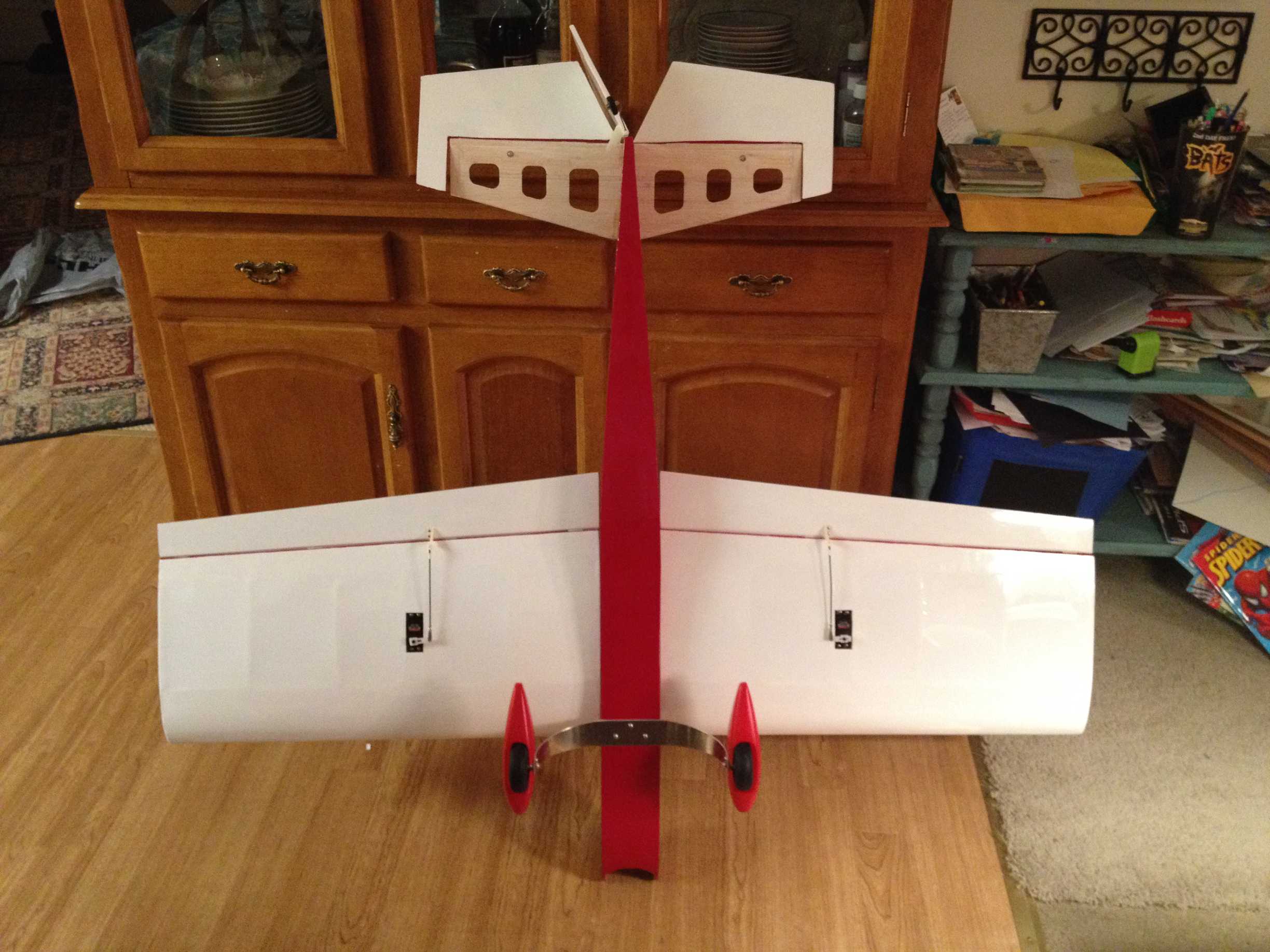

I'll post pics in a moment but from the hatch on back I have a white stripe. I am thinking about extending the stripe down a bit further so it looks continuous or just changing the white to red.
sideoftheroad 06-12-2014 09:26 AM
2 Attachment(s)
Looks like I don't have an updated pic of the bottom after I covered the back part but here it is. What do you think?http://www.rcuniverse.com/forum/atta...mentid=2004370http://www.rcuniverse.com/forum/atta...mentid=2004371
Rv7garage 06-12-2014 11:01 AM
Lol! We've all had those builds where the canopy doesn't fit, or the wheel pants get screwed up ....or the cats go into the garage to fight and end up knocking a freshly-covered wing off the table necessitating a repair & re-cover (long story, I really don't know how they survived :mad: :eek:).
I like the color scheme, and the control surface mods. I will be doing the same to my next SSE.

Here's one wheel pant done. This is the one that fell to the ground. I put what I think is a thick layer of crystal clear on it yesterday. I think it came out pretty well.http://www.rcuniverse.com/forum/atta...mentid=2004874http://www.rcuniverse.com/forum/atta...mentid=2004875
Rv7garage 06-14-2014 04:28 AM
Finish looks good. I like the color :)

Canopy is finally glued on. I also used trim tape to seal it off completely. That little locator dowel on the back of the canopy has been removed too. I glued in a magnet instead and it is holding real well. The other wheel pant is giving me fits still when I try to put on the clear coat. I am going to keep trying to finish it as a side project put don't need them on to fly. I figured if anything I can strip them both back down to plastic and respray with Lustrekoat but I am trying to avoid it. I am trying to finish it the way I am doing it now. On the K&B .45 it says to start with a 10x6 prop. What prop has anyone used with a .45 or similar engine on their SSE?
