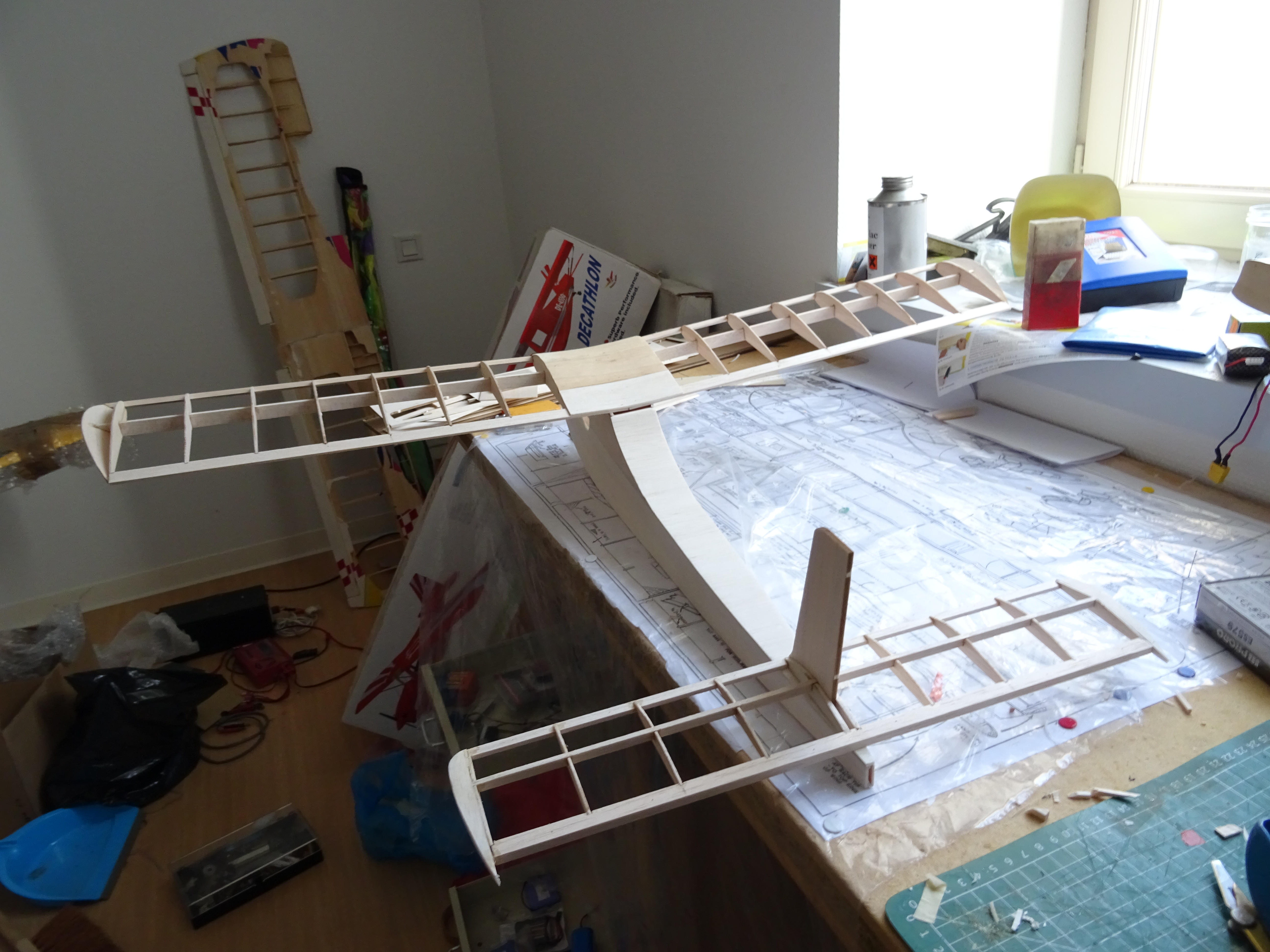

I am in the process of building a Veron Cardinal which is a little vintage high wing monoplane produced in kit form by the Vintage Model Works of London. In 1960, when I was twelve years old, the Veron Cardinal was the third model I built and by far the most successful, free flight of course on those days. Had it not been successful I would not be writing this now. It was powered by a Mills 75, that's 0.75cc or a little smaller than an 049. I am using the same engine in the current model but I will also be installing a couple of micro servos to control the rudder and elevator. I'm blowed if I'm going to be chasing it or climbing trees at 68!
I wrote an article about the first model for a British magazine and will post it if there's any interest.
Picture of my current model under construction.
