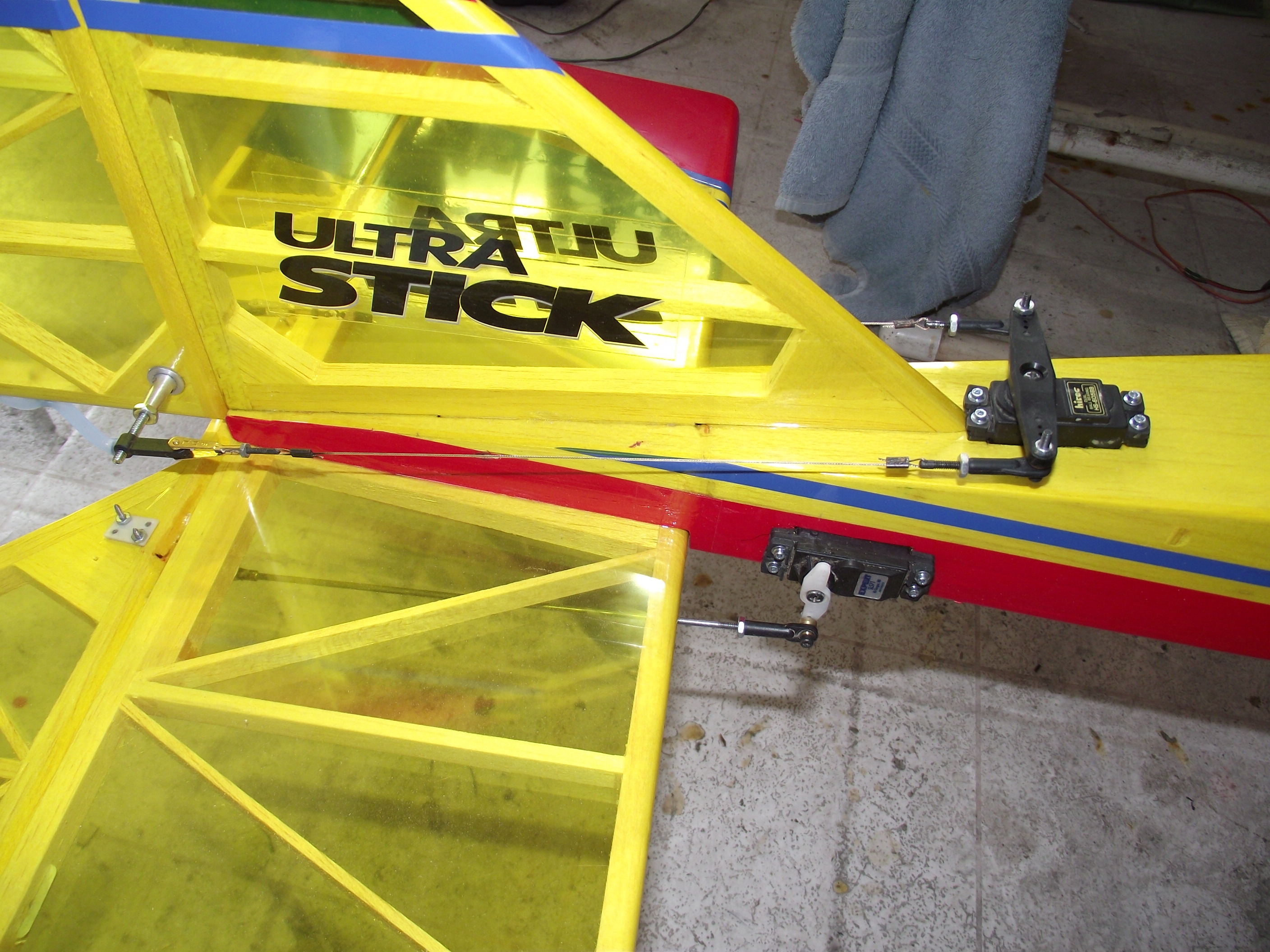

Gray Beard 09-12-2015 02:52 PM
2 Attachment(s)
http://www.rcuniverse.com/forum/atta...mentid=2119535http://www.rcuniverse.com/forum/atta...mentid=2119536 The plane is an Up-Roar, the controls are nyrod with an 18 inch run. I haven't had it out of the shop in a week, before that it was in my van for two weeks. It's my plane I keep in the van in case I want to pull over someplace and fly.

Gray Beard 09-12-2015 03:06 PM
4 Attachment(s)
http://www.rcuniverse.com/forum/atta...mentid=2119537http://www.rcuniverse.com/forum/atta...mentid=2119538http://www.rcuniverse.com/forum/atta...mentid=2119539http://www.rcuniverse.com/forum/atta...mentid=2119540 I'm heading out to fly in about an hour so just for grins I turned on the plane and radio, the trims are still set at zero, the shop is at 95 degrees and it's humid. I took a shot of an ARF I assembled to sell that I installed the elevator and rudder aft to get the correct CG and used a 4-40 rod for the elevator and made up a pull/pull for the rudder. It never changes trim either.
I pulled out a piece of the red outer tube and slid in some 4-40 rod, a lot of room left inside the tube but it will work. Also going to change the CG with the added weight. Then I pulled out a piece of the Nyrod and slid a piece of 2-56 rod in it. Perfect fit and slides well.
When I was in Calif. and flying a plane with the nyrod the trim would maybe go out a click/beep or two but nothing worth changing out the controls for.
If it's more then a little trim change you have some other type of problem. Something is shifting?? A little is normal. What are you calling a lot??

Gray Beard 09-12-2015 03:36 PM
2 Attachment(s)
http://www.rcuniverse.com/forum/atta...mentid=2119541http://www.rcuniverse.com/forum/atta...mentid=2119542 Sorry about two photos but my program only shows little thumbnails and I can't see them. The photo shows you the 4 anchor points on the guide tubes.
That really is way too much change and if you opened up the top or bottom of the fuse I would bet something else is wrong.
Removing the plastic rod is really easy and it would only take a few minutes to install a metal push rod to see if that will fix your problem.
It really is a fast thing to do.
Another thing I used to do a lot was make push rods from carbon fiber arrow shafts. You can eliminate all the braces and guides. A lot of the old kits gave you a dowel to make the control rods from.
You do have a problem but it's an easy fix!!;)
