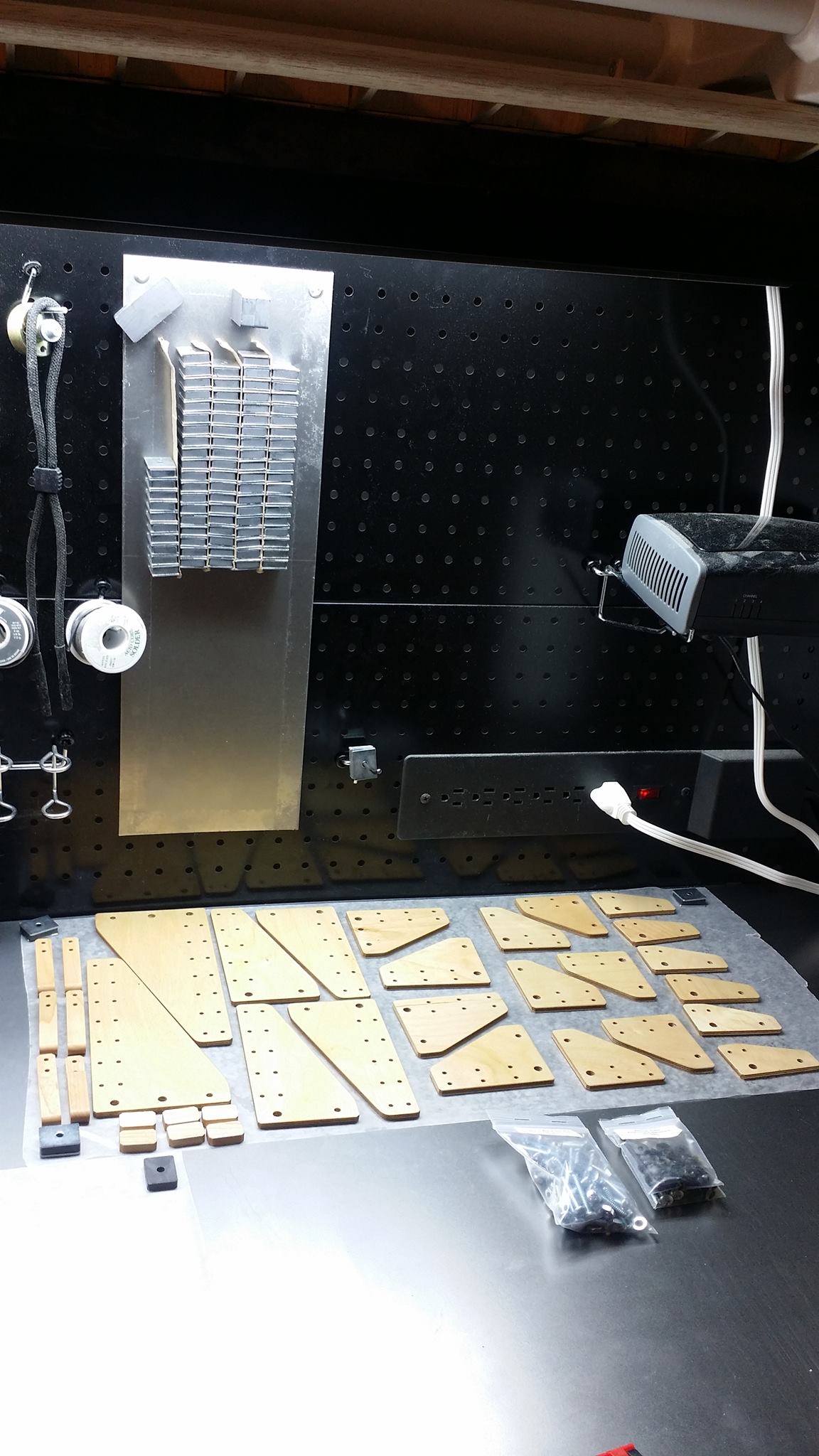

DaleJEckart 12-12-2015 03:30 PM
Ray - I got my sheet steel, 24X48" 16 ga., and it seems to want to lift on the edges. I'm thinking about gluing it to my bench, which is a Sears workbench with a (finished) particleboard top. What glue did you use and how should I go about it? Anyone else have any suggestions that would work instead of gluing it?
DaleJEckart 12-12-2015 03:50 PM
1 Attachment(s)
Got my building set from Paul @ http://www.airfieldmodels.com/index.html ... Medium set... Danish Oil finish applied, ready to go in 1-2 days
