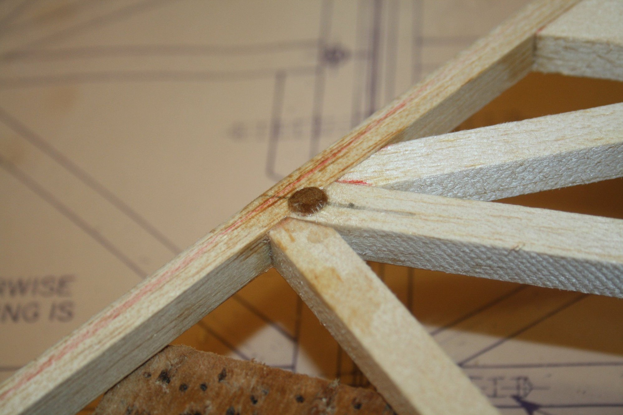

erans 07-16-2023 11:09 PM
I glued the "half ribs" (the front portion of a rib covering the foam where the fuselage is inserted). I used two old batteries and a wedge between them to press/hold the half ribs securely in place while the glue dries.
I also dressed the spar with sheeting (top and bottom).

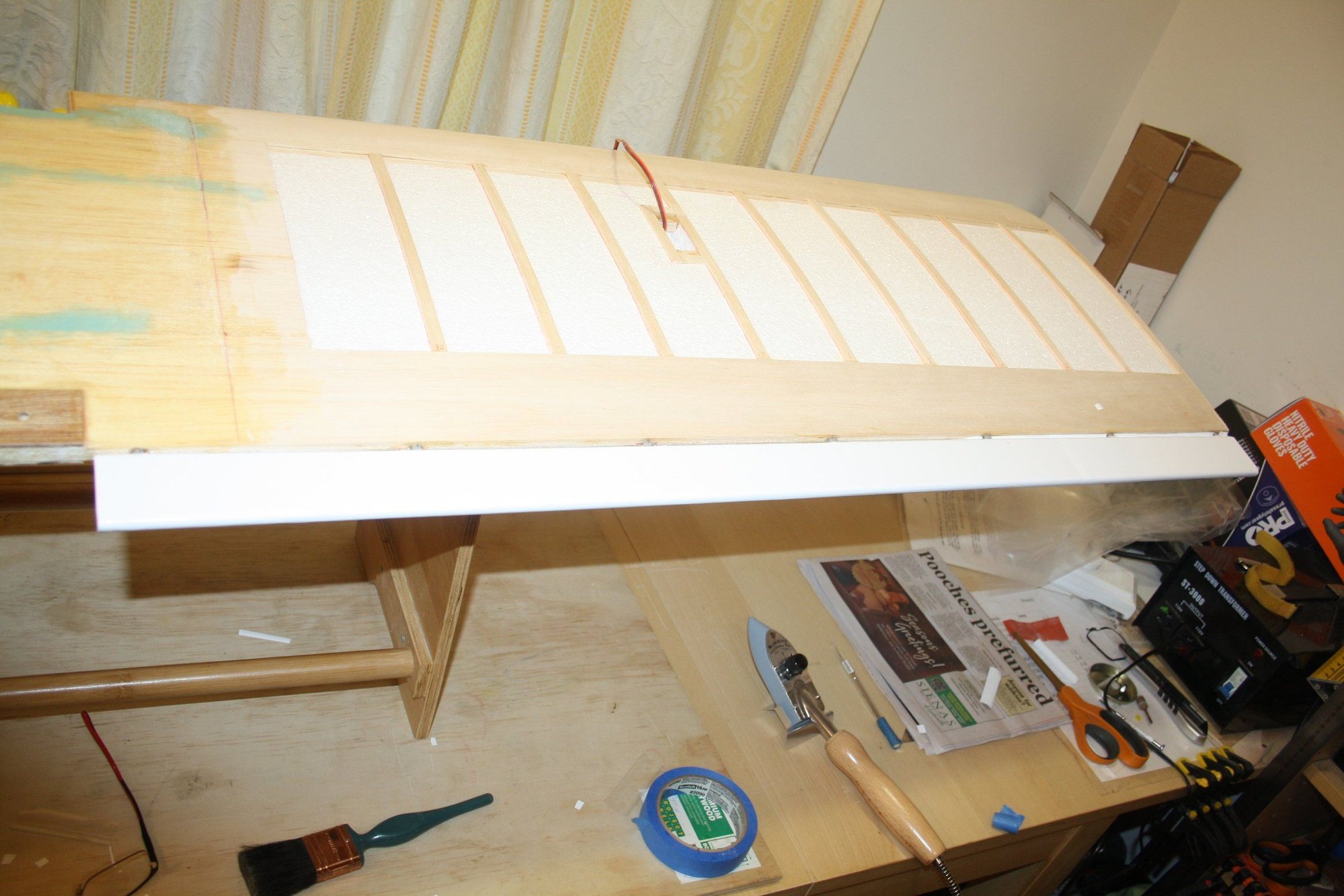

erans 08-26-2023 09:10 PM
I had one aileron with a severe bow in it. I therefore installed more hinges then shown on the plan.
During the glue setting period I forced the bowed aileron into submission with a clamp. To prevent the Epoxy from gluing the hinge pin I am using Vaseline.
The result of forcing the aileron into position was that it is mostly straight, however, it is not moving as freely as I would like. I will need strong servos to operate it satisfactory. I should have made a new aileron...

I then decided to take a break from construction and to do some covering. Starting with the ailerons.
I decided to go with main colours of white for the bottom and Black on the top side.
https://cimg6.ibsrv.net/gimg/www.rcu...2e6a0263e0.jpg
https://cimg7.ibsrv.net/gimg/www.rcu...d2cdd7b314.jpg
https://cimg8.ibsrv.net/gimg/www.rcu...4d32a7d7d3.jpg
https://cimg0.ibsrv.net/gimg/www.rcu...46cb4932f2.jpg
https://cimg1.ibsrv.net/gimg/www.rcu...03814d25fe.jpg
https://cimg2.ibsrv.net/gimg/www.rcu...ee6adc46ae.jpg
https://cimg3.ibsrv.net/gimg/www.rcu...2e1770e792.jpg
https://cimg4.ibsrv.net/gimg/www.rcu...8b6ef920d2.jpg
Cheers,
Eran
