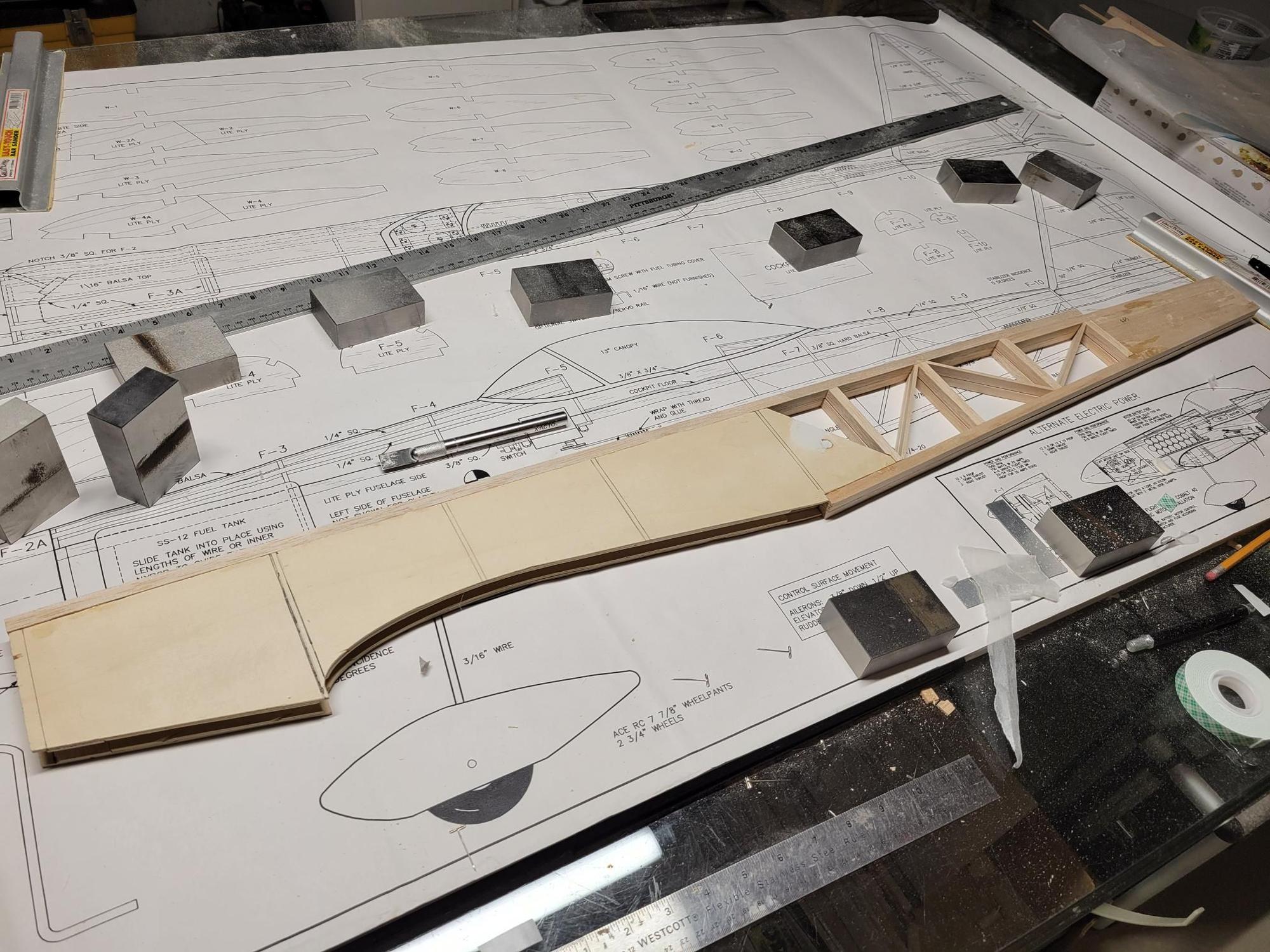

Getting too cold to fly here in north Utah, so back to the building board. I picked up a Ace Cloud Dancer 60 by Fred Reese a while back and wanted a new sport plane. Have not posted a build thread in a long time so bear with me as I try to get the pics, etc figured out.
Here is the subject
https://cimg2.ibsrv.net/gimg/www.rcu...7ac2f1ebeb.jpg
Bottom of right wing:

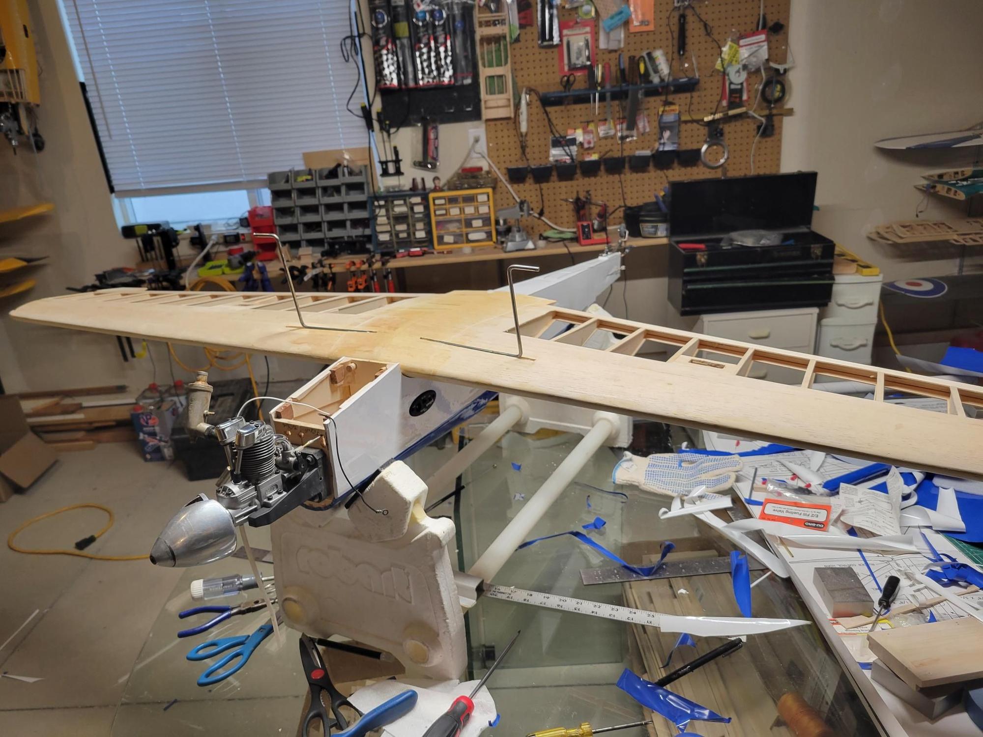

https://cimg6.ibsrv.net/gimg/www.rcu...a666000fe9.jpg
Wing is now mounted
https://cimg8.ibsrv.net/gimg/www.rcu...ad5cd74501.jpg

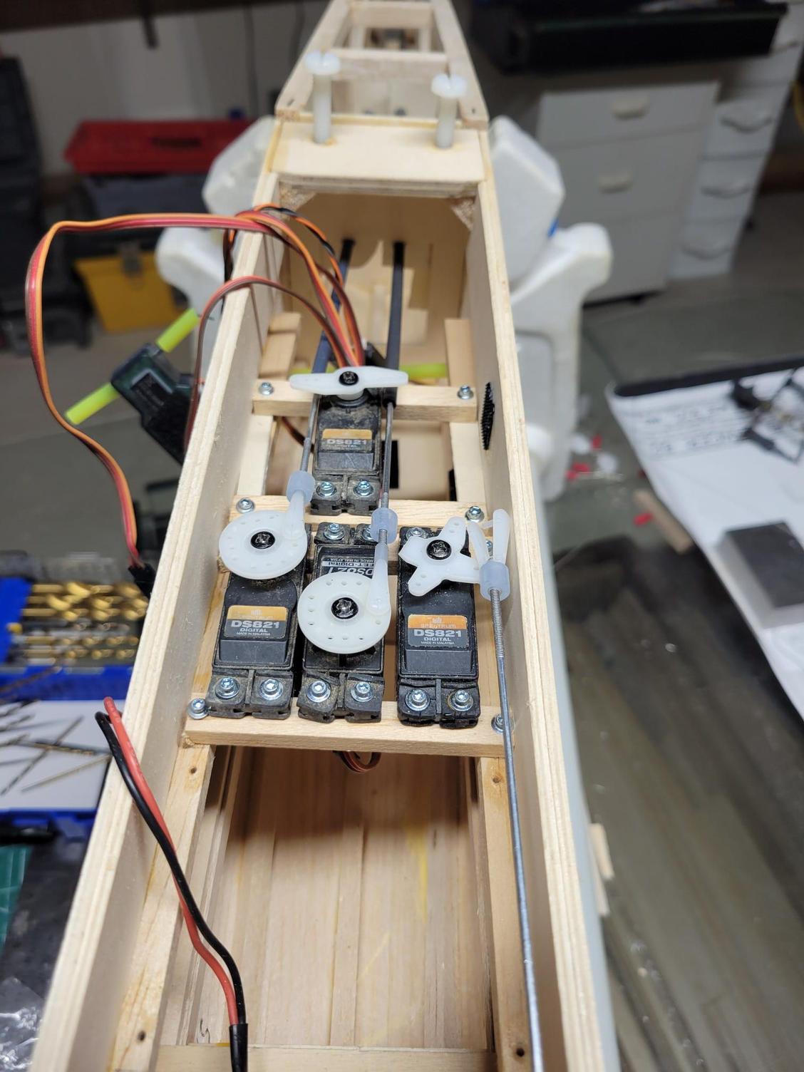

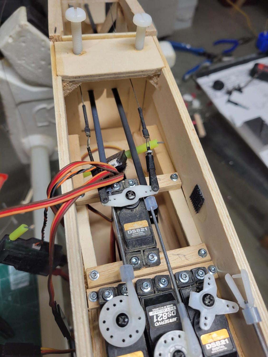

https://cimg1.ibsrv.net/gimg/www.rcu...b4dbd4fc41.jpg
Another alteration. Not comfortable with the tail wheel setup. So decided to go with a pull-pull system. Added extra servo for tail wheel linked by y- harness with rudder.
https://cimg0.ibsrv.net/gimg/www.rcu...2073177ea1.jpg
So as to make room w/o interference I elevated the servo 1/8 inch. perfect fit
https://cimg8.ibsrv.net/gimg/www.rcu...d80080200c.jpg
run some tubing (scrap from throw rods) through the 3/8 square and no kinks in the lines
https://cimg2.ibsrv.net/gimg/www.rcu...098f646aac.jpg
Added platform to attach the pull-pull tail system
