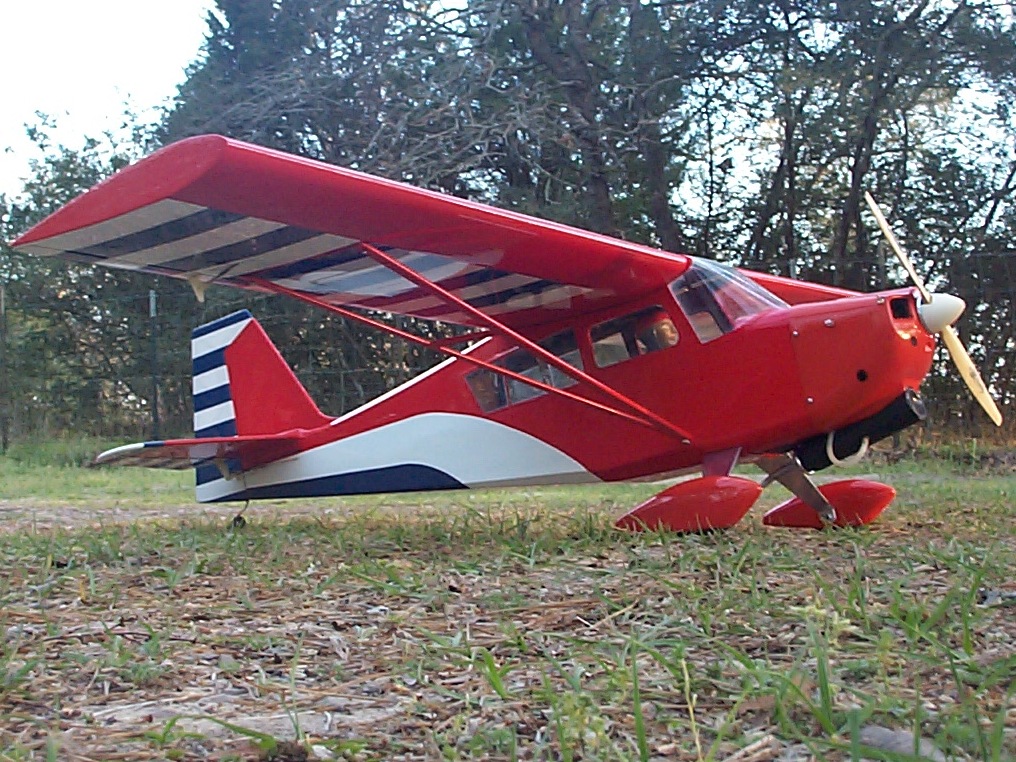

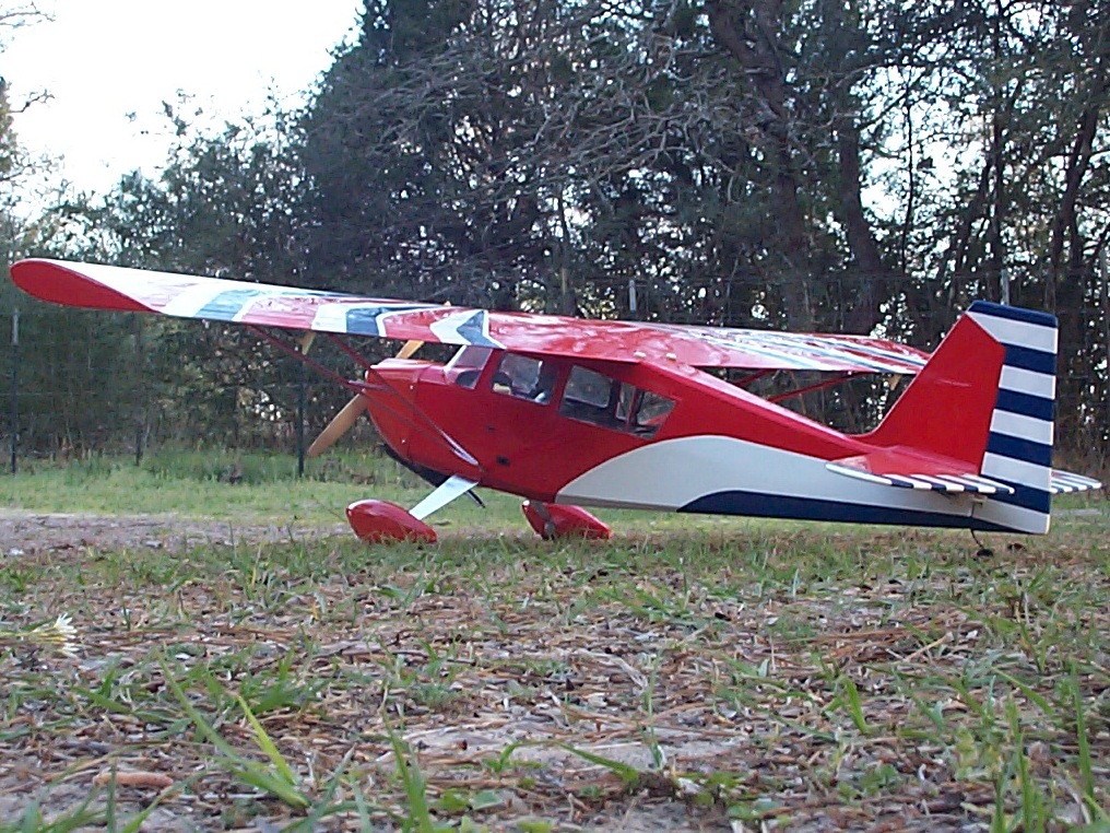

1 Attachment(s)
I hate to sound like a downer but this plane is garbage. I have built it and the ailerons are so small, it will stall very easily and spin into to its untimely death. It's happened to many people I have spoken to about it. I would suggest holding out for a .40 size Pilot Decathlon on ebay and grabbing it. It builds a whole lot easier and is more scale and flies like a dream. Here is a photo of mine. You can usually find one on line for about $150 and you may a bit more but you at least know that when it takes off it should land.

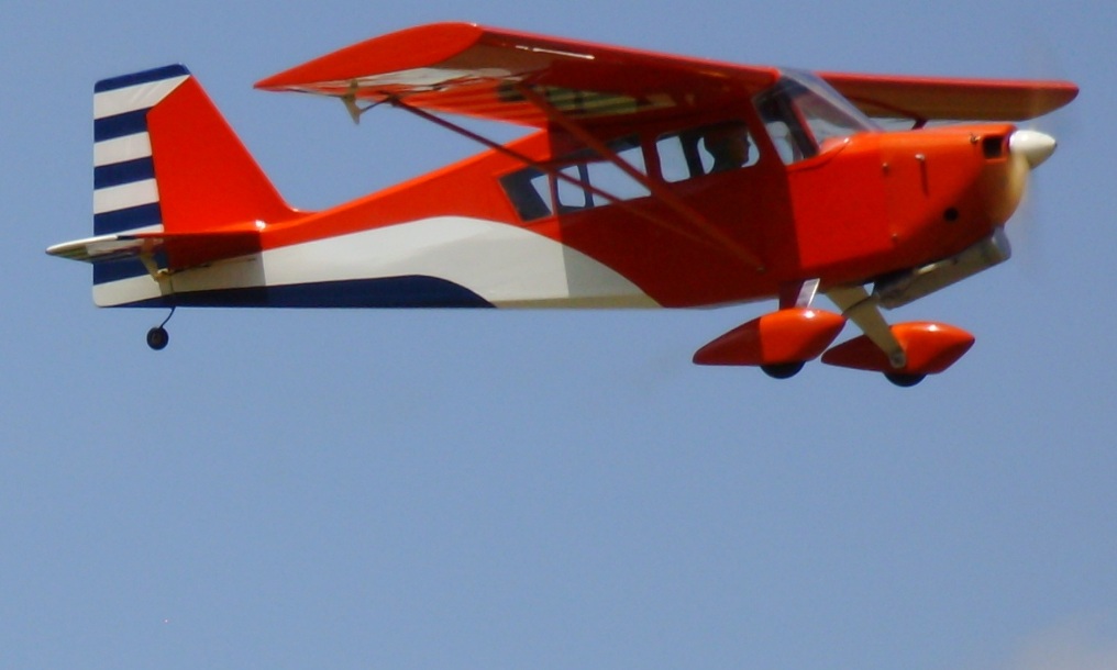

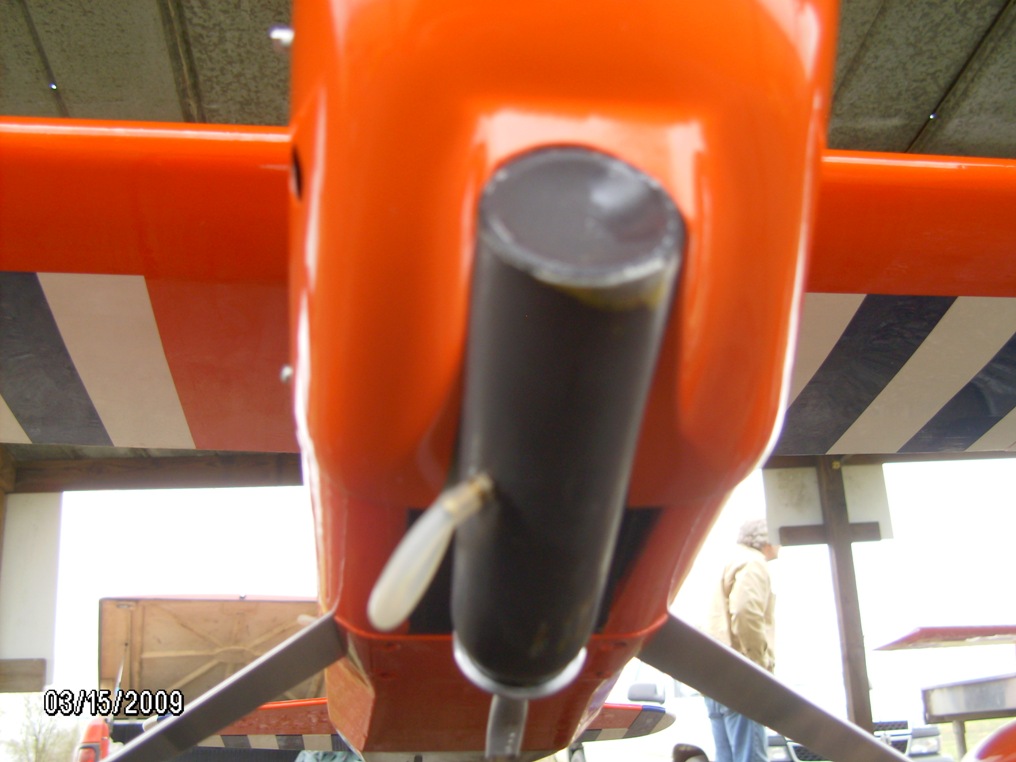

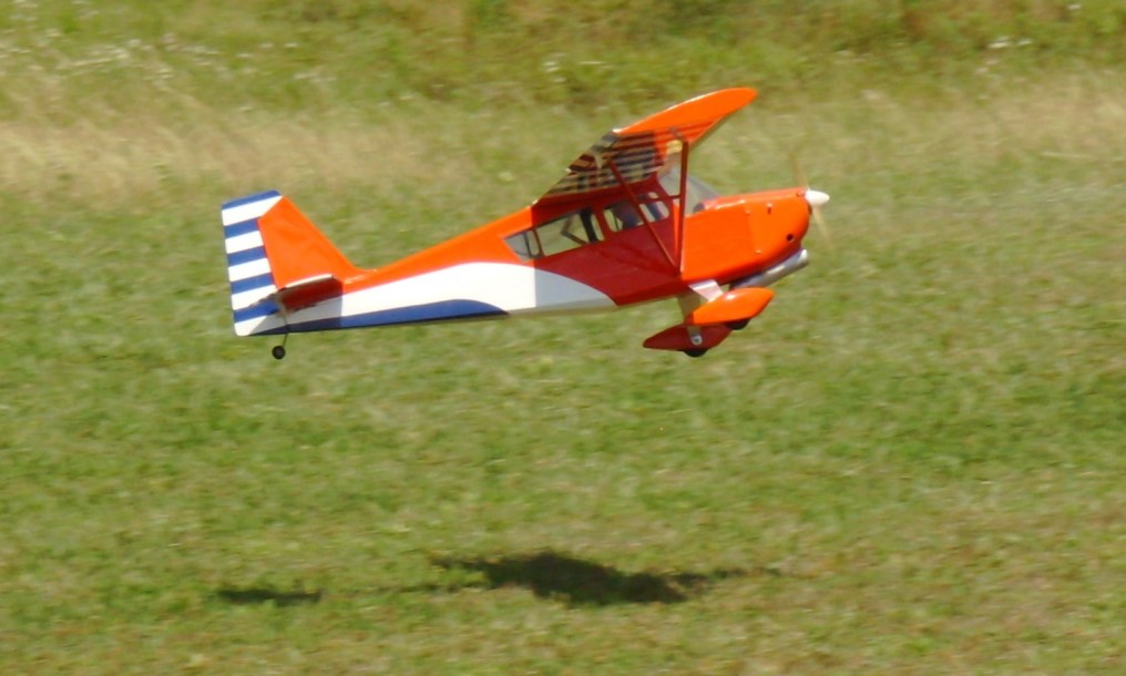

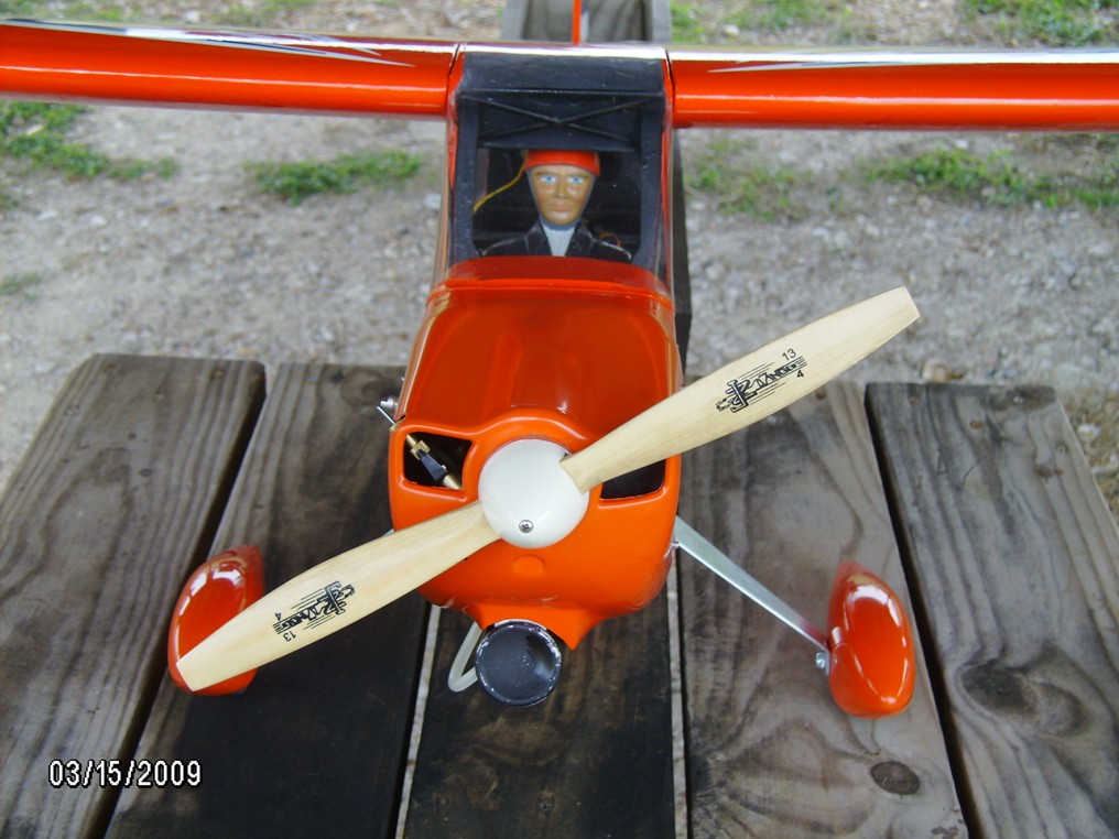

RICKSTUBBZ 10-24-2014 03:27 PM
6 Attachment(s)
Here is a couple pictures of the GP Super Decathlon I built for my son. Built box stock. As in - exactly like great planes said to build it. This especially includes control throws. Too much elevator could spell disaster.
http://www.rcuniverse.com/forum/atta...mentid=2041965 http://www.rcuniverse.com/forum/atta...mentid=2041966
One exception is that the engine was put at such an angle that the muffler was exactly on the bottom and very little damage had to be done to the cowl.
http://www.rcuniverse.com/forum/atta...mentid=2041967 http://www.rcuniverse.com/forum/atta...mentid=2041968
Don’t believe all of the bad press you have read. The airplane when built square tracks very well. Meaning it goes exactly where you tell it. Knife edges like nobodies business. The roll rate is a little slow. But, not that bad.
http://www.rcuniverse.com/forum/atta...mentid=2041969 http://www.rcuniverse.com/forum/atta...mentid=2041970
I think the bad press for this plane comes from people expecting it to fly as easy as a Cub. It is not a Cub! It is a high performance aerobatic high wing airplane. Whatever you might expect from an Extra this size is what you should expect from this plane.
It is a short coupled tail dragger and you should expect it to behave as such. When you have it near landing speed you don’t want to be nailing the throttle. Just ease into it.
