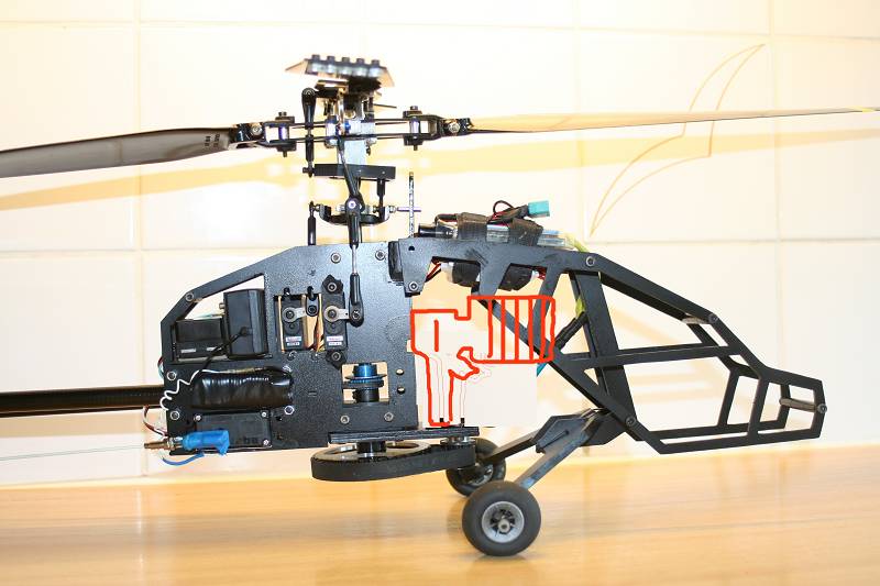

NINO My engine setup came from a RC10 GT car. It is a OS 12 CV and I think the clutch is from Associated as Peter D. has stated. I did have to make a shaft to adapt the clutch to the engine. I would like to see what others have done for the clutch shaft. Also had to make a longer main rotor mast. The whole thing came out a little tail heavy so when I fly it , I keep breaking the stock tail gear housing. I do have one of the CHOPPER-1 gear boxes but I am going to make a drawing of it before I install it in case I can find someone to make another one. Like Peter D, I would like to see pics of what you do as well as anyone else who is doing this.

About that engine, can't you use the engine, clutchshoes and clutchbell as it is ?
If I were you I would definitely get a beltdrive for the tail, It's a real money/time saver and you can use it with brets tail gear housing.
I attached my engine in front of the mainshaft to get a better CG. The design of the crutch is a little different from the original though
I'll post pic once I get home from work.
//Peter

Now I'm home
Here's how I attached my engine. I didn't have a pic. of it with the gasser mounted so I draw it up on a other picture
//Peter
//Peter
