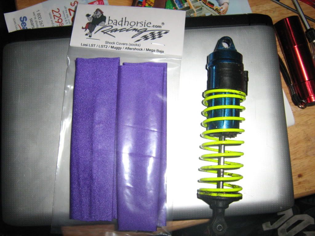

Now I have begun the tear down and cleaning. So-far I found I need to replace at least both the pinion and spur gear for the low gear. Since Losi offers a full package for both high and low will get that and start fresh there. Will replace the gear cover with a RPM setup. Have a new motor mount on the way to replace the one that was broken when I got it. Missing some screws so going to order a whole set,and lots of lock tight. Thinking of going with RC Screws stainless steel set. Will need a few gallons to of fresh shock oil those things are huge on it. Shock covers from Bad horse they are great at keeping the shocks clean and free of debris.

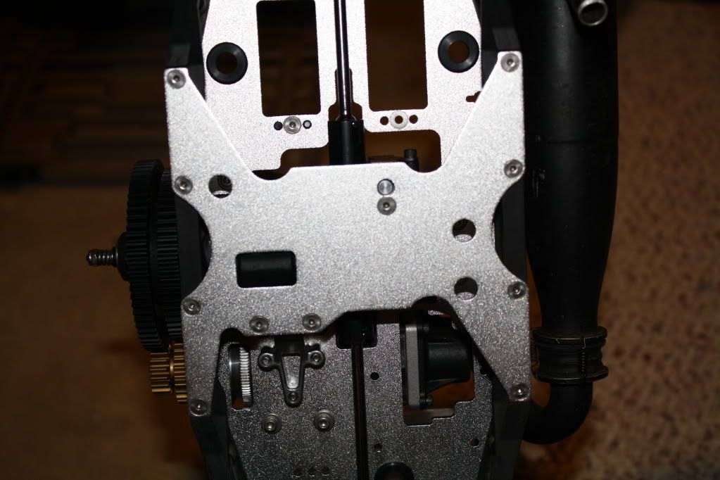

While doing the tear down I noticed it almost looks like it could be set up with rear steering. Was this ever a setup for the LST? Just odd to have a spot for a fourth servo.

Ok great. Might be a fun experiment to convert the rear into steering though it only runs on one servo. Will get it all back up and running before do that.
