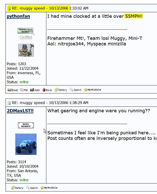

ORIGINAL: pythonfan
I wish, i could'nt even hit 45, i got a girly 44.8mph i am so p[:@][:@][:@] but i can smoke my frineds revo and savage
u get the sts .30 yet 250?

55 seems a little far out for a stock motor

2D, you caught him. He better check himself before he wrecks himself.

PWNED!!!

I am in no way defending anyone, but I think a muggy could hit 55, under the right conditions. If you had him running perfect and took him down a steep hill. I think it could do 55. On flat surface, not without some modifications. I read the same report in rc car action on the top speed. In xtreme rc cars they dyno'd the mach 4.27 with a max rpm of 43,250. If you geared your muggy taller, and used something like a jp-3 pipe. I think that you could get that speed. It wouldn't have anything off the line, but once the rpm's started winding you might see something then.

Spur/clutchbell 46/15 = 3.06
Diff pinion/ring 45/11 = 4.09
3.06 * 4.18 = 12.52 overall gear reduction
40 series tire overall diameter = 5in x 3.14 = 15.7inches
55mph/60minutes = .92miles per minute
.92 miles * 5280ft/mile = 4857.6ft/min
4857.6ft/min * 12 = 58291.2in/min (inches/minute)
rpm of wheel to make 55mph = 58291.2/15.7 = 3712.82rpm
Engine RPM = 3712.82 * 12.52 = 46477.76rpm

hey 2dmaxlst!
Nice blow [sm=punching.gif]
But if u recall in that same thread i posted and i quote
ORIGINAL: pythonfan
ok guys i might have gone over the top with 55! the highest it got was indeed 44mph!
that was done by radar and gps!
like i said before my friend 3dcody had his revo clocked at 50+ a revo 3.3 can't do that can it?
where going to race soon and he sais hes revo is faster than mu muggy true/false?
and then in the muggy toped out at 35 thread and i quote again
ORIGINAL: pythonfan
My muggy stock 44mph, took 250'+ 41-43 i got it up to 44 after 310', Clocked Buy cop, and gps, I will get a vid ad soon as my starter probe comes in from killer. Left the old one in tampa[:@]
Edit: I run 20%, and my temp is 215-260 I don't have a temp gage anymore.[:@]
So i did tell people 44, i just had new truck gitters
And hey for next time if ur going to chalange me be prepared i back myself up ever time![sm=shades_smile.gif]
Good day guys!

Fair enough pythonfan, you regain some credibility with me.
