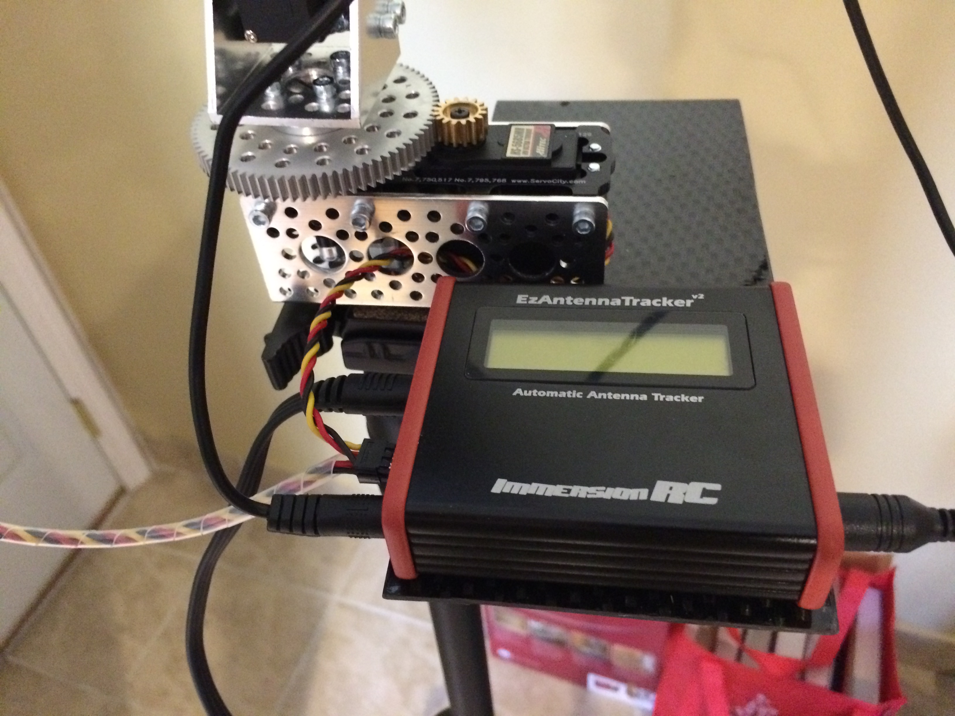

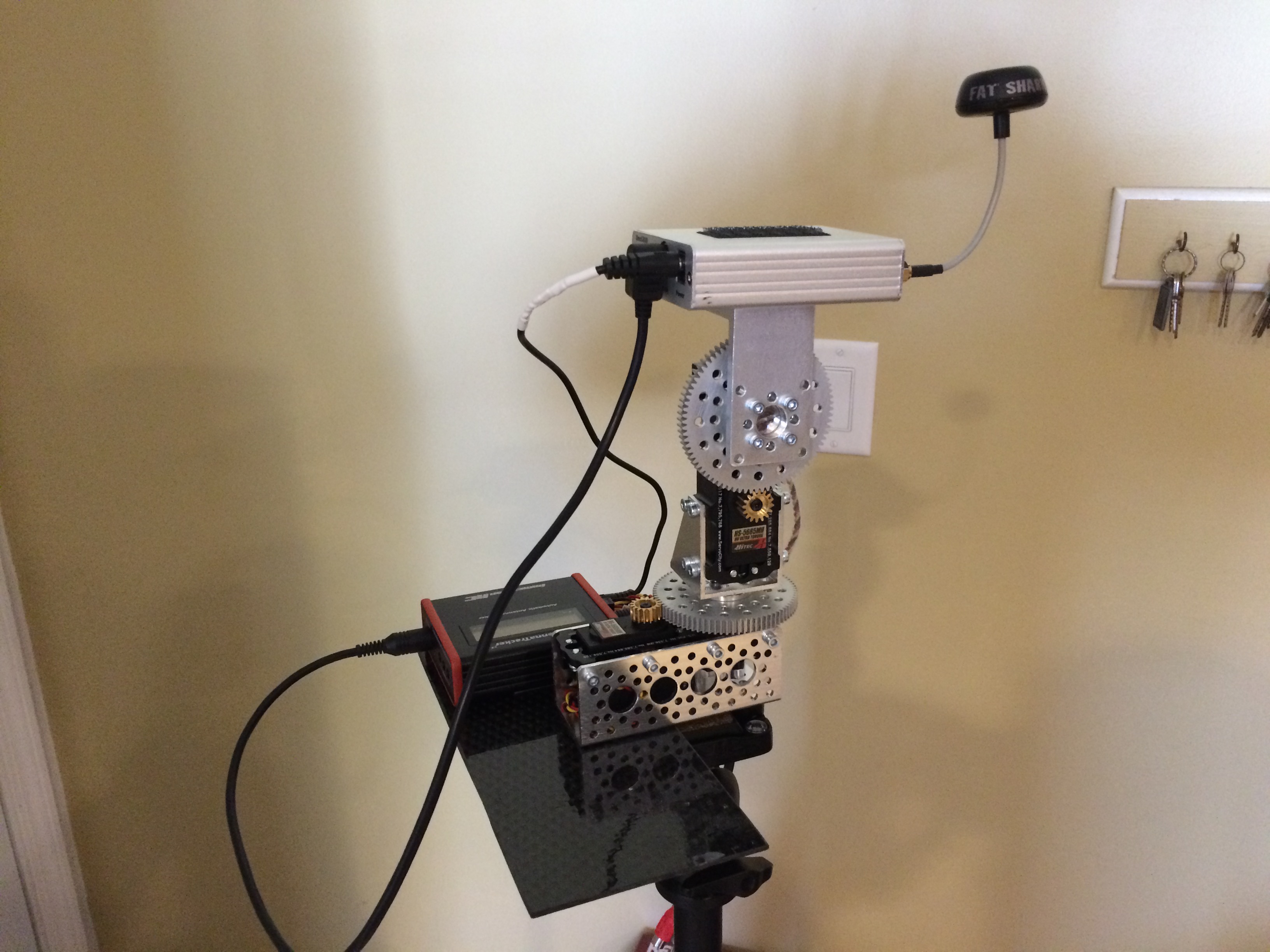

I tried to get this antenna tracker to work, but I have know idea why I can't, so I am selling it. I have $425 invested, but will sell it for $300 + 15 for shipping in the US. Tripod is NOT included.

The Fatshark antenna you have mounted there is omnidirectional. The tracker is designed to point high-gain directional antennas. Won't do anything with an omni antenna because the antenna receives pretty much the same no matter where you point it. Use a different antenna.
randall1959 04-06-2015 04:04 AM
Yea, you need at least a patch antenna.
