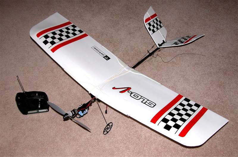

Hi,
The new ParkZone [link=http://parkzone.com/Products/Detail.aspx?ProdNumber=PKZ1300]Slo-V[/link] Electric RTF slowflyer is meant for either indoor gym flying or outdoor park flying. The 45.9" wingspan and geared 370 power system enable the Slo-V to fly very slowly at an all-up weight of only 15oz.
Here are the Specifications:
[ul][*] Wing Span: 45.875 in (1170mm)[*] Overall Length: 36.75 in (930mm)[*] Flying Weight: 15 oz (0.41kg)[*] Motor Size: 370 Power w/gear reduction[*] Radio: FM with 3 proportional channels[*] Speed Control : Power FET proportional ESC/receiver[*] Recommended Battery: 6-Cell 7.2V 600mAh Ni-MH[*] Approx. Assembly Time: 10 minutes[*] X-Port: Yes[*] Charger: DC peak detect
[/ul]
Here are some of the Key Features:
[ul][*] Ready to fly right from the box [*] Includes fully proportional 3-channel FM transmitter, batteries and DC peak detect field charger [*] Mode Change Flight Controlâ„¢ System [*] Fully proportional elevator, rudder and throttle [*] One-piece wing [*] Factory-applied decals [*] 370 motor with gear reduction [*] Carbon fiber fuselage [*] Powerful enough for the park [*] Slow enough for indoor flight [*] X-Port enabled for aerial combat and bomb dropping
[/ul]
While I don't agree that it is "Ready to fly right from the box", it does come with everything needed to get the Slo-V flying in one box. That includes the transmitter, transmitter batteries, rechargable 600mAh Ni-MH battery pack and DC peak charger. All that’s left for the modeler is about 30 minutes of assembly, which can easily be done while the battery pack is charging.
Best of all, the Slo-V is X-port enabled!

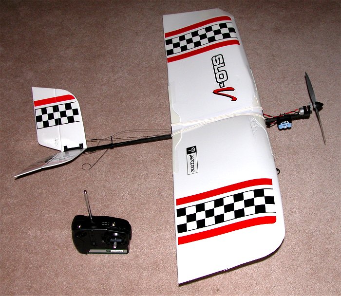

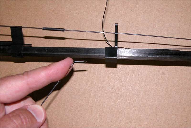

There is some amount of assembly required to ready the Slo-V. The gear mains and tail gear simply press into place but the wing requires some sticky-back guides and tape to be applied. My wing arrive damaged but I had no problem pressing it back into shape before applying the plastic guides that hold the proper dihedral. Although a bit beat up looking, it should still fly fine.
The tail section must be assembled with a plastic "V" piece and two long thumbscrews. The control rods are then connected on the bottom side of the tail. I needed to initially thread my screws in from the opposite side to get the holes cleared in the plastic "V" piece.
The wing is then secured to the fuselage with 4 rubberbands.

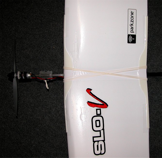

I could not find where the manual said to install the wheels so I put them on last just before testing the control surface directions. The wheels simply slip onto the metal axels and are held on with a plastic cap.
The servos, receiver, and geared motor are all ready to go. I only needed to snap on the plastic option module tray for when I test out the X-port enabled [link=http://www.hobbyzonesports.com/Products/Detail.aspx?ProductID=HBZ6023]Drop Module[/link].

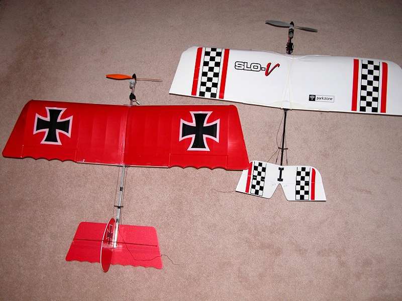

I put my new ParkZone Slo-V next to an old "friend" for comparison; the GWS Slow Stick. The sizes and dimensions looked very similar, if not exact. The big differences here were in the V-tail design and level of integration. The Slo-V comes virtually Ready-To-Fly in a complete kit and is X-port enabled.
