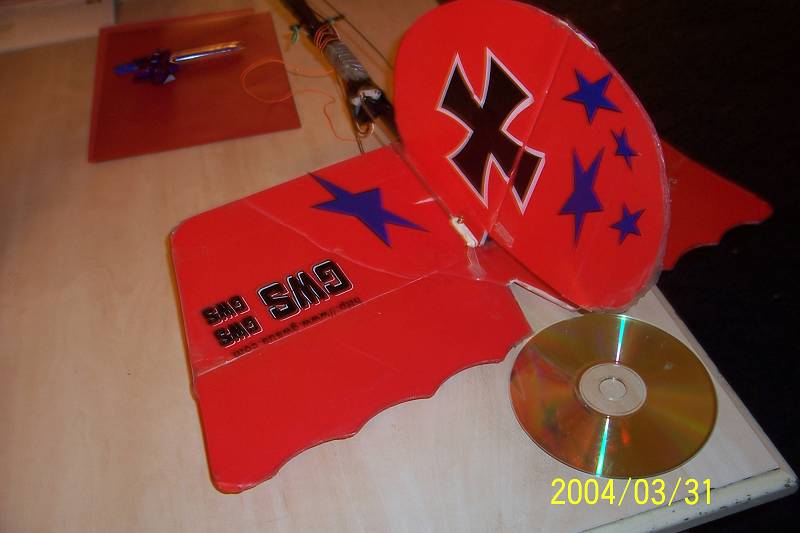

Luv2 - you've got the right idea about the lipo, I used a 2200 3S a while ago, it was fine for high winds cos you could "punch" you're way through the gusts and it flew for 25 minutes (15C). That was fine, but I changed to 1300 3S and got better flights cos the plane turned better and climbed easily. Even my 1700 2S is brilliant at the same weight as the 3S.
The tail: mine is stock but with cut-outs so that the elevator on full up-travel doesn't touch the rudder, which also has about 1/2in. cut-out near the bottom - n chance of the two touching.
My elevator servo is mounted at the rear so that the control rod is only 6in., this makes the control instant with no flexing of the cable. Weight-wise: its only a 9grm servo (Towerpro) so it doesn't affect the CoG too much and is easily rectified. Here are some piccy, don't know if they show the servo clearly. Note the folding prop and the cell-phonebattery holder.....

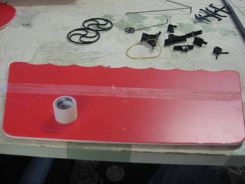

Ok. Got it in today. Right on time. Sooo. First impressions were great. I've had many arf's sent through the mail and this one was flawless. Had it UPSed in 2 day air. The box was undamaged. I also bought some GWS floats with it! they look flawless to!
So, i opened it up, set everything out, and read the manual 4 or 5 times. The manual is a bit unclear but haveing many many arf's under my belt, along with some kits and foamys, this looks like a piece of cake.
After reading the manual, i decided i'd edit the first step. Take a look. I used 3M blenderm for the hinges. Had that laying around. I think it'll stick better and overall last longer. Especially since i plan to fly on water! [8D]

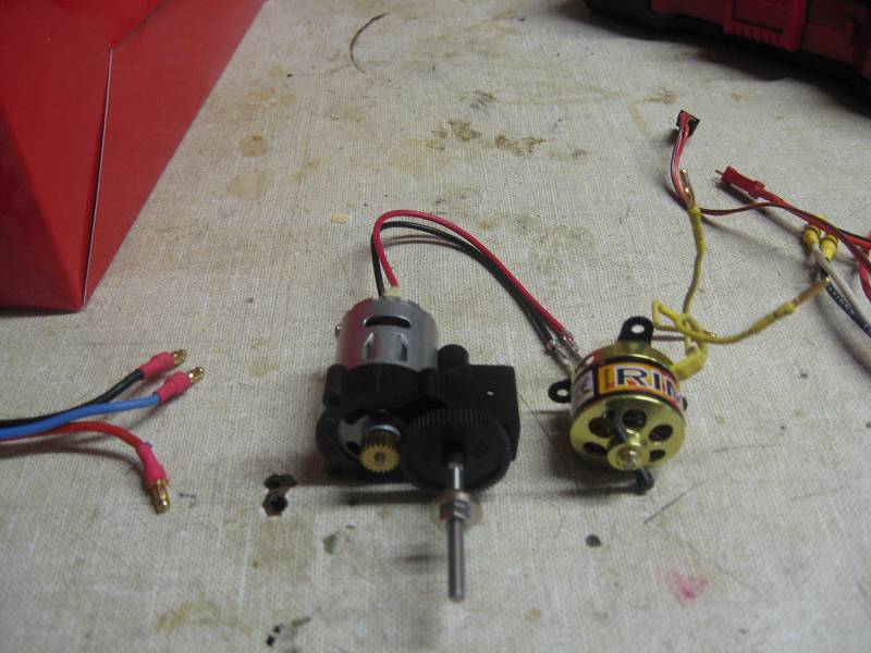

Ok. Here are a few pics. Which of these did you use? Sticky tape or the gusset bolt mount?
Here's my rimfire motor i have. May thow that on there. It's an outrunner with a propsaver built in on the frount and a shaft at the back. Has a tripod style mount.... hmmm how to mount it on the slow stick......

More pics of the motor. Side by side comp. of the stock brushed to the brushless rimfire.

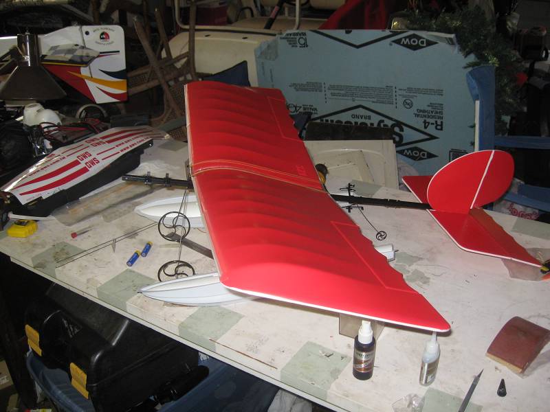

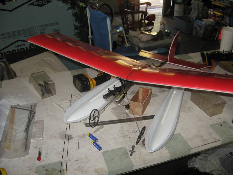

Making some progress....

Old 03-14-2008, 07:11 PM
tam popo
Join Date: Feb 2007
Location: glasgow, , UNITED KINGDOM
Posts: 3,349
Default RE: Slow stick Forum!!
Luv2 - its looking good, won't be long till its finished. Enjoy.....
