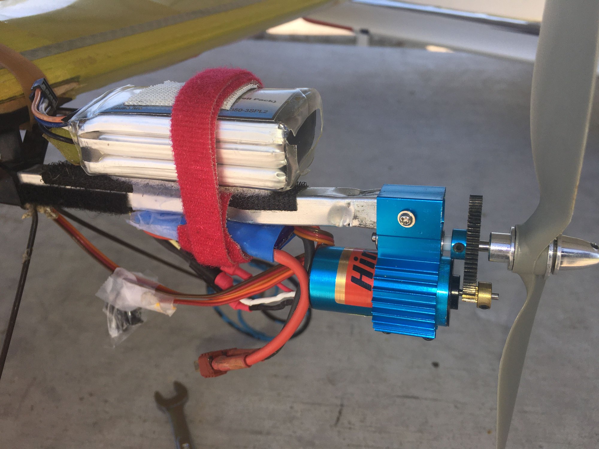

I recently flew it about a week ago (during the weekend) at my RC Club using a HIMAX Inrunner Brushless with the HIMAX gearbox. The issue was I could not keep the propeller on the output gearbox shaft.
I came to a complete circle of sorts and found my original ASTRO FLIGHT mightly mirco 010 14-turn inrunner brushless and found a GWS EPS-300/350 gearbox and installed the GWS "B" Spur gear which makes 4.43:1 reduction.
Placed a GWS Slow Flyer (Orange Propeller) EP9070 which is a 9 X 7 propeller.
Performed numerous repairs on the wing and from a previous crash that occurred over 10 years ago and recorded right here!
Experimenting with the HIMAX Inrunner with HIMAX gearbox.
Just could not keep the propeller on the Gearbox output shaft.

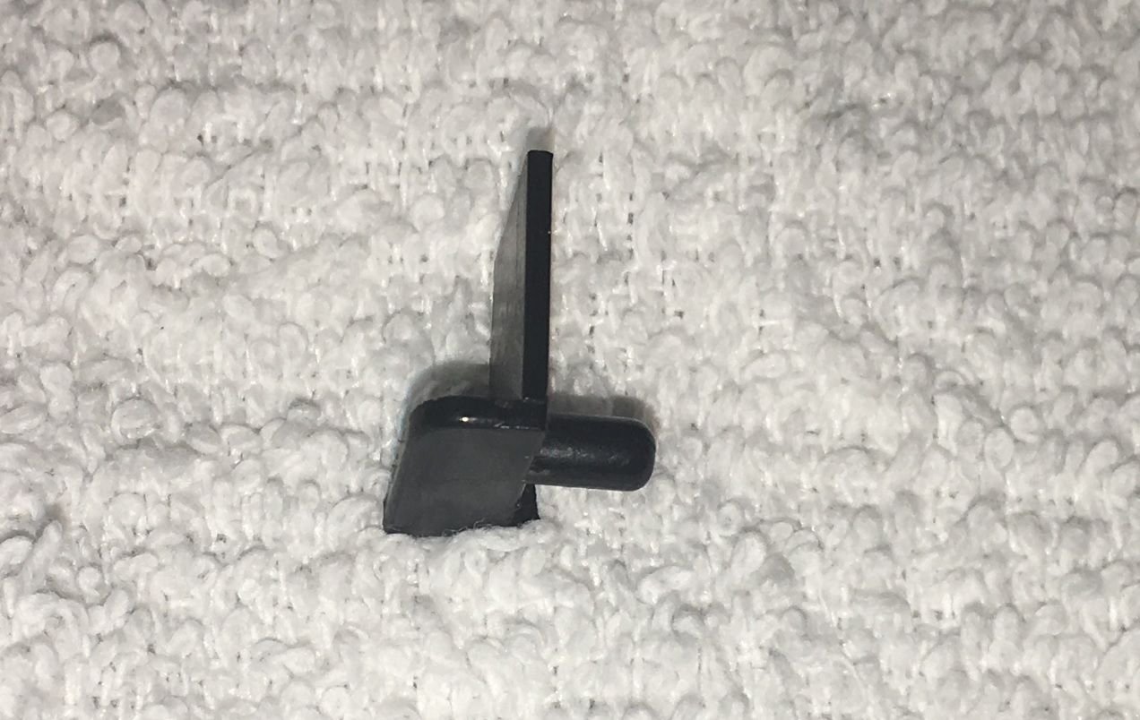

Repaired the Plastic Frontal Wing brace!
Small piece cut-out from spare replacement part for the Frontal Wing Brace and rubber band hold point.
Spare GWS Part from the bin drawer.
