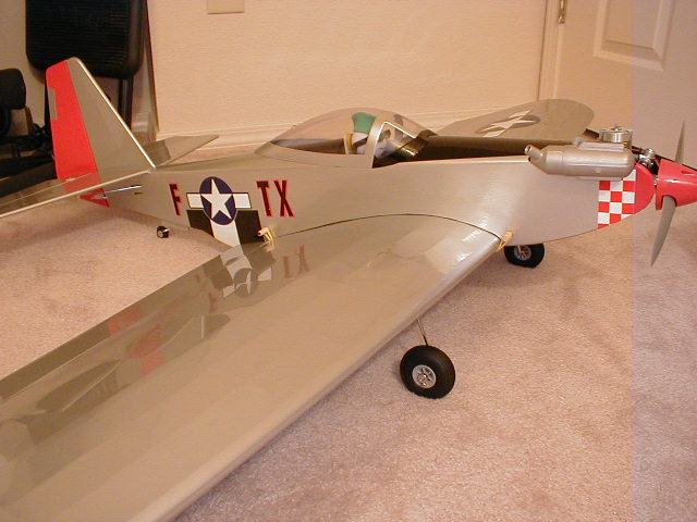

Here's my Lazy Tiger. Just finished it and haven't had a chance to fly it yet. Has a OS .32F in it and Hitec minis in the wings. Standard servos elsewhere. I too put a bulkhead in place to steady the elevator and rudder pushrods. Seems pretty firm with little movement. I don't plan on flying it fast anyhow, just slow and easy maneuvers low on the deck. Has anyone done any spins with it? Interested to know how easily it recovers. Hopefully she'll be flying this week.
Hey Skydude, is that a deep-sea diver in your plane or a teletubbie? Looks good.

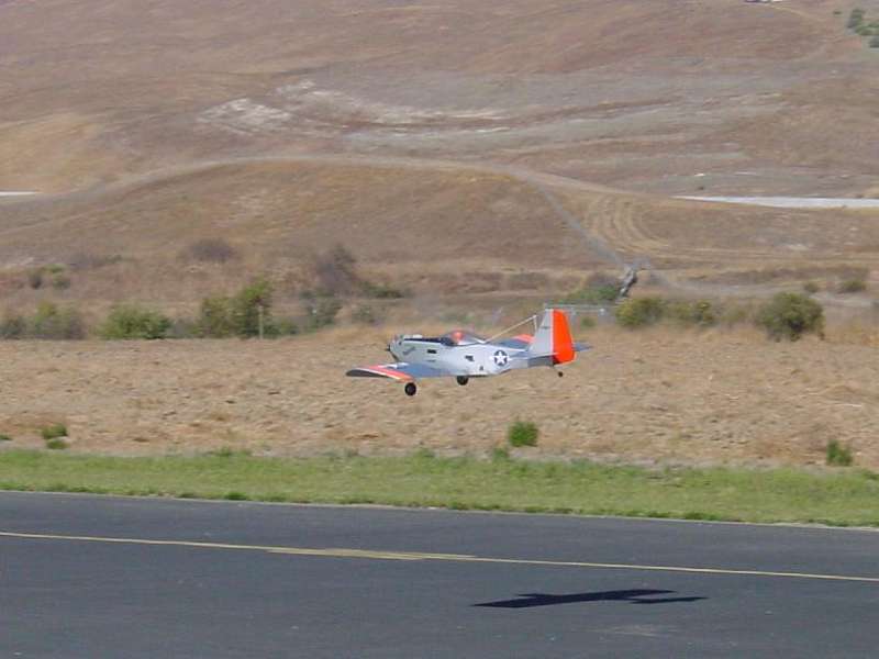

Naw, it's not a TeleTubbie - it's Kenny!

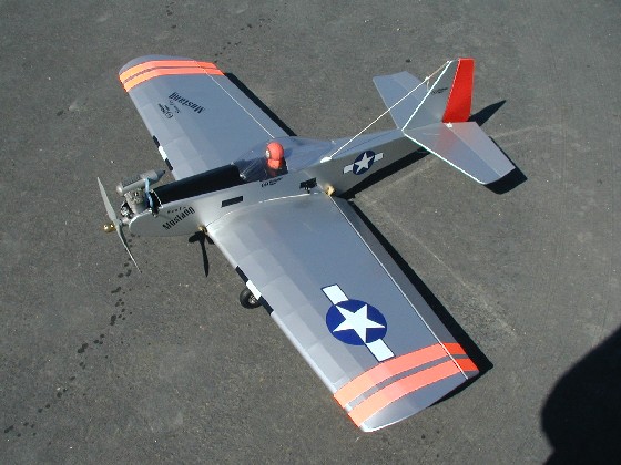

Here's a couple more pics from today. It was pretty windy but I didn't kill Kenny!
