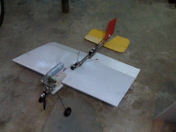

Printed off Might have to find the wire. Do you have the photo link of the your landing gear? I can't remember what size wire you used but it's basically v'd back then bent down and out for each leg and a wire tie and such to hook it to the motor mount.

Here's a photo of the landing gear on one of my McDDDs. Start with a 20" piece of 5/32" music wire. Make the "V" bend in the middle, then the other bends as needed. I used Goldberg landing gear straps but zip-ties though some holes would probably work just as good. Nothing is critical, except the prop shouldn't touch the ground when the plane is sitting on the landing gear. The wire gear works MUCH better than aluminum strap mainly because the wire gives and bends instead of the fuselage rail bending before the aluminum strap.

OK, got mine done. Needs some color but I didn't do anything like that yet as I didn't have 4 mil coro I only had 3. Oh, I THOUGHT I had 4 mil, had the piece all pulled out and ready then opened it up to find a big hunk of it missing (it was a sign). But I had 4 or 5 3 mil signs. We'll see how that works, I'll also have to go get some smaller re-inforcement wire, 1/8 inch won't fit. I'll go buy some tomorrow after test flying like this. Forgot to weigh it. Get pictures tomorrow too.

The pull pull thread was too floppy for my rudder. My Vertical may actually have been the problem it was floppy too. I stiffened that up. The gear ripped right off with a light landing so instead of using wire ties I swapped up to those gear clips. Since I was at the hobby shop and noticed some flex of the 3 mil wing I got some CF rods and stuck those in. Everything is ready for another try tomorrow.
It was a lot more floaty than my PBF. I also don't have a decent prop for the PBF right now. Don't have a supply of 10x4's and really would like a 10x3 as a good 10x4 is too much thrust. I had one of those NEW MA 10x4's that are all noise and an old Kavan 10x4 that was just right but the old MA's or APC 10x4s have way to much high speed thrust.

Looks good Mr. Clean!
The stretchy upholstry thread works great for the pull-pull rudder on a PBF, but DO NOT use it for a pull-pull rudder on the Qhor type planes. On the PBF the Kevlar thread and Spiderwire kept breaking where the upholstry absorbed the shock. Kevlar thread, wire cable, or Spiderwire might work OK for a pull-pull on the Qhor type planes, but I never tried it. A pushrod is easier, and the weight doesn't really matter.
My favorite prop for a TT 42 GP w/MCP in a PBF is the Master Airscrew 10x4. The 10x3 made lots of noise, but didn't really seem to pull well. The 11x4 works OK, but the spool time is too slow for a PBF. The APC 10x4 works good, but it's too fragile. Same for any other APC prop. Which brings us all the way back to the MA 10x4.
But the best prop for the TT 42 GP w/MCP in these Qhor type planes is the Master Airscrew 11x4.
Too bad the zip-ties didn't work out for the landing gear. They would have been a cheap and easy alternative.
To cure the floppy fin, put some short pieces of bamboo skewers inside the flutes where it's screwed to the U-channel. That will keep the coroplast from smashing down and losing it's rigidity.

I cut a corner section of American PVC to fit in the channel and that extends about an inch taller than the channel. Then I screwed through the channel and used a two little backers to screw through and firm it up to the vert. Its heavier than bamboo I'm sure, but stiffened it up quite a bit. We'll see how it works tomorrow.
It's possible that I have a pipe in the PBF's mouse can. It's also possible that I suffered from weird winds today, it sure was harder to fly. Then again, there was nothing for most of my time at the field, then there was some, but it kept shifting. I did end up with an APC which did take longer to spool up. I stuck a 10x4 wood prop on. It spools real quick but that made it zip too quick as well. Stupid hobby shops around here have NO 10x4s. They do have 10x5's. Looks like an order from Tower is in order. I really liked the Kavan orange 10x4. I suspect it was light enough to spool up and rubbery enough to flatten out and lose some of the excess thrust. I could tell the difference between LIGHT wing loadings and my some what more substantial PBF. I do have a 25 LA, maybe a GP somewhere. But I don't have any lightweight servos so I don't know if it would help going to the smaller engine.
Oh I'll get it all sorted out.
