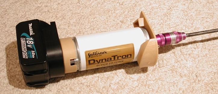

I was not happy in terms of price and/or quality with high torque starters available on the market and I wonder if there are any "how to's" or anybody tried to build a above average power starter.
I think converting a bike or ATV electric motor starter my be a good starting point.
I'm looking to start gas engine between 50 and 80 cc.
Any info will be highly appreciated !
George

Voltage is king when it comes to starter performance, I have set up many portables with voltages and battery types all the way up to 18 and 24 volts. Most starters are rated at 12 volts and at this are pathetic performers but I have used many very successfully at 18 volts.
The only actual starter I known rated higher than 12 volts is the Sullivan Dynatron. This starter is rated for twenty four and is a real performer at that voltage. Here is a picture of my two Dynatrons that I use for certain airplanes and power both in a portable fashion with 18 and a 24 volt drill batteries. One is my homemade gear drive but Sullivan makes excellent belt drive units for the Dynatrons too:
John

One of our locals still lugs around and old auto starter and heavy solenoid big cables and that huge battery. Far better alternatives these days for those of us who choose to use starters.
So George if you do make up something that three inch cup on my geared starter is a three inch hole saw that I ground down and the silcon insert was I believe from Sullivan. I also have a home machined two inch cup that slips over the standard one inch and secured with set screws when the need arises. I think that two inch silicon insert also came from Sullivan but not sure since I bartered for it.
We just had our local Q-500 424/EF-1 race Saturday and during all the practice flying my last 18volt black and decker drill battery went to battery Valhalla. The twenty fours were overkill for the .40 displacement engines But just happened to have a few 5000 mah four cell lipos. Never wanted to experiment with lipos before for the starters because of the deep discharge danger as well as give up a few volts with the four cell and the three cells are just right back to no better than the old batterys we used to all lug around.
Well turned out very well and it worked very well in this application and of course the ability to make several trips to the field without charging is nice. The down side is four cell lipos are not cheap by any means. Since this was a last minute deal I did the simplest conversion yet. I did not want to cut off those oddball battery connectors because I have one airplane that uses those batteries so instead soldered on a pair of insulated alligator clips on the started leads and the alligator tips push into that connectors holes and it works great.
John

I use a miller persuader mounted on a standard Sullivan starter. Because the persuader has a 3:1 reduction I can use 24 V on the starter.I have started a BME 102 with this.
I have had the miller for 15 years

I have a Sullivan Dynatron on a 6S LiPo. I use this on my YS185 when it's frosty and the 12 volt won't spin it. Haven't tried it on anything bigger, but it has heaps of power.
Also made my own using an outboard motor starter. Evinrude starters spin the right way without having to reverse anything. I use this to prime my SuperTigre 4500 which is mounted inverted. I should really try the Dynatron on it.
I hand start all my gas engines.

Hi KW actually it is 4S 5000 mah and about 40c or thereabouts. Been using 18 volts or more for to long to ever go back to something like ll volts with a three cell lipo. One nice thing this starter I have been using several weeks now and for my usage which is almost daily I have only needed to charge every third day.
Normally I am used to charging the starter every outing just as you would the RC system. For the Dynatrons using six cell Lipo to get it up to its rated voltage would be tempting but also quite expensive.
