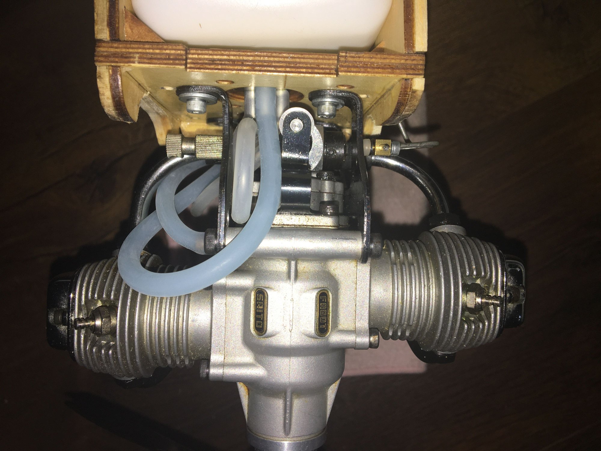

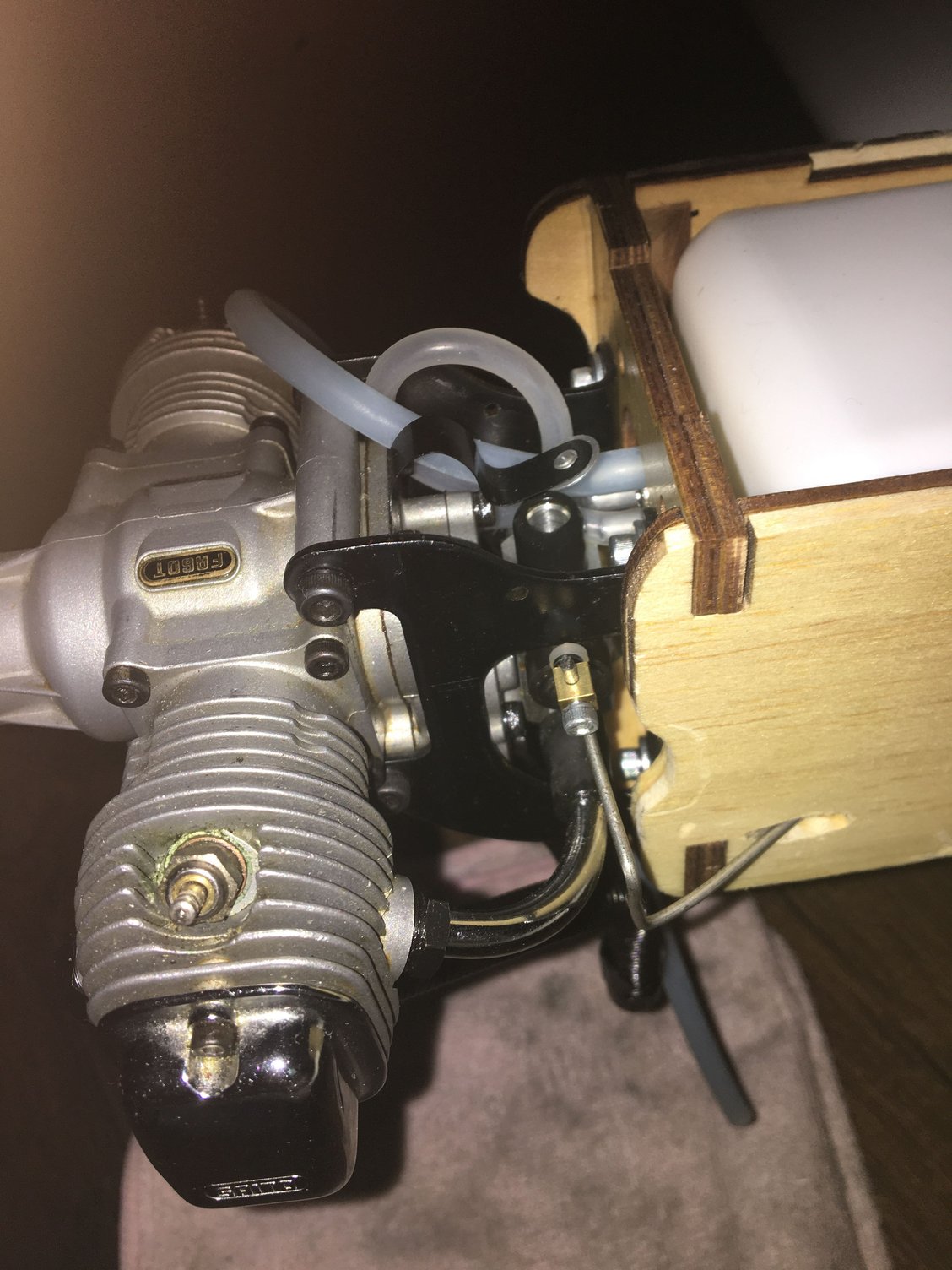

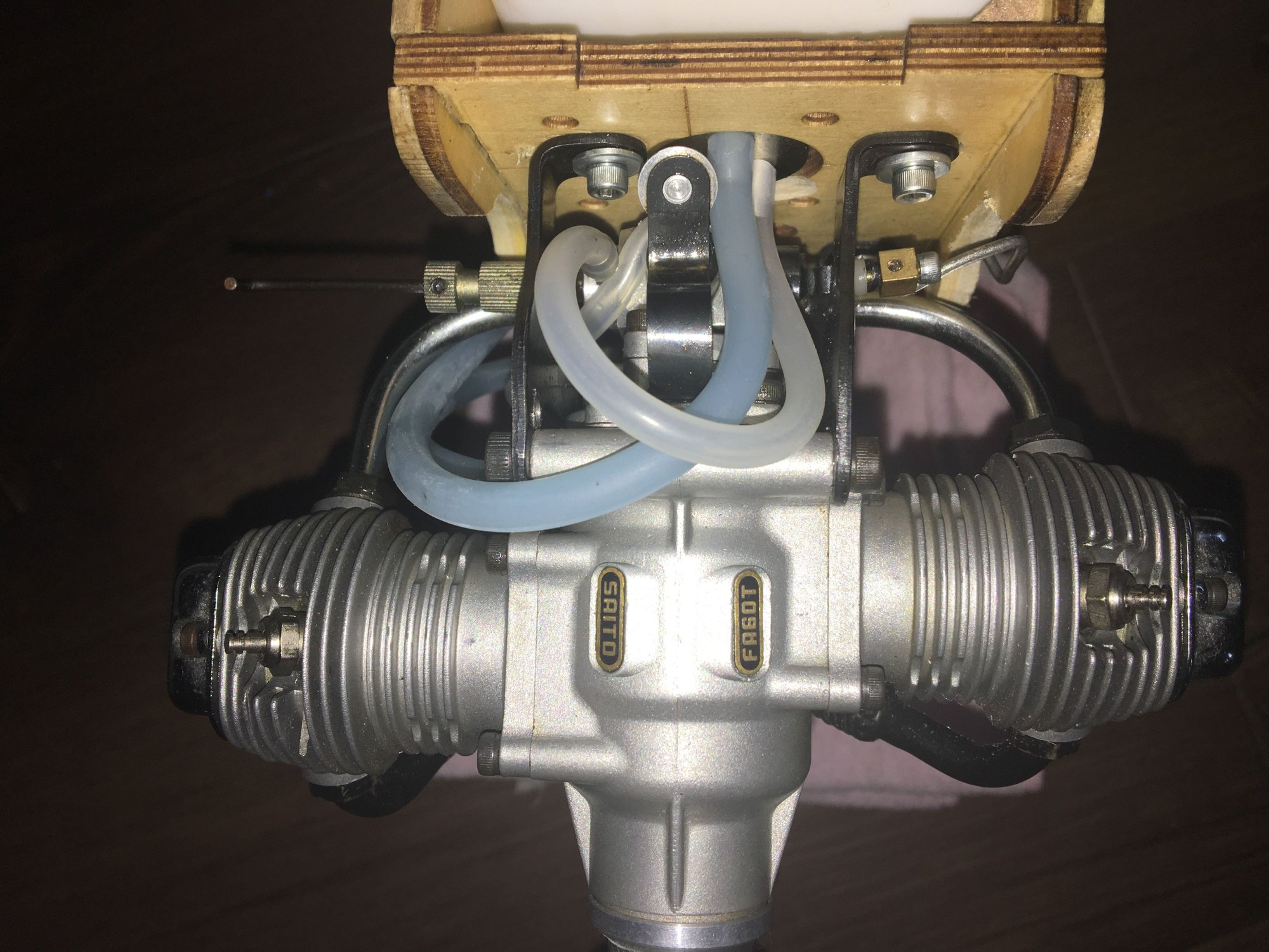

Hello good people, have an issue with the throttle links binding and not being precise. Here are a few pictures of my quick setup. I need something way more robust in linkage and geometry. I have two saito 60t and the tank setup keep from more normal direct link. Please help...Thanks

Going to a 10 oz fuel tank and moving it back an inch or so will give you plenty of room for a Nyrod type throttle pushrod that will line up better with the throttle arm. If you are able, moving the engine forward 1/4" would give a bit more room to use a ball link that would help with any mis alignment.

Thanks, do not want to extend the motor anymore. I will check a smaller tank too.

Was able to get the linkages installed with just drilling a hole to the right of the firewall. Carbs are way better synced now.
