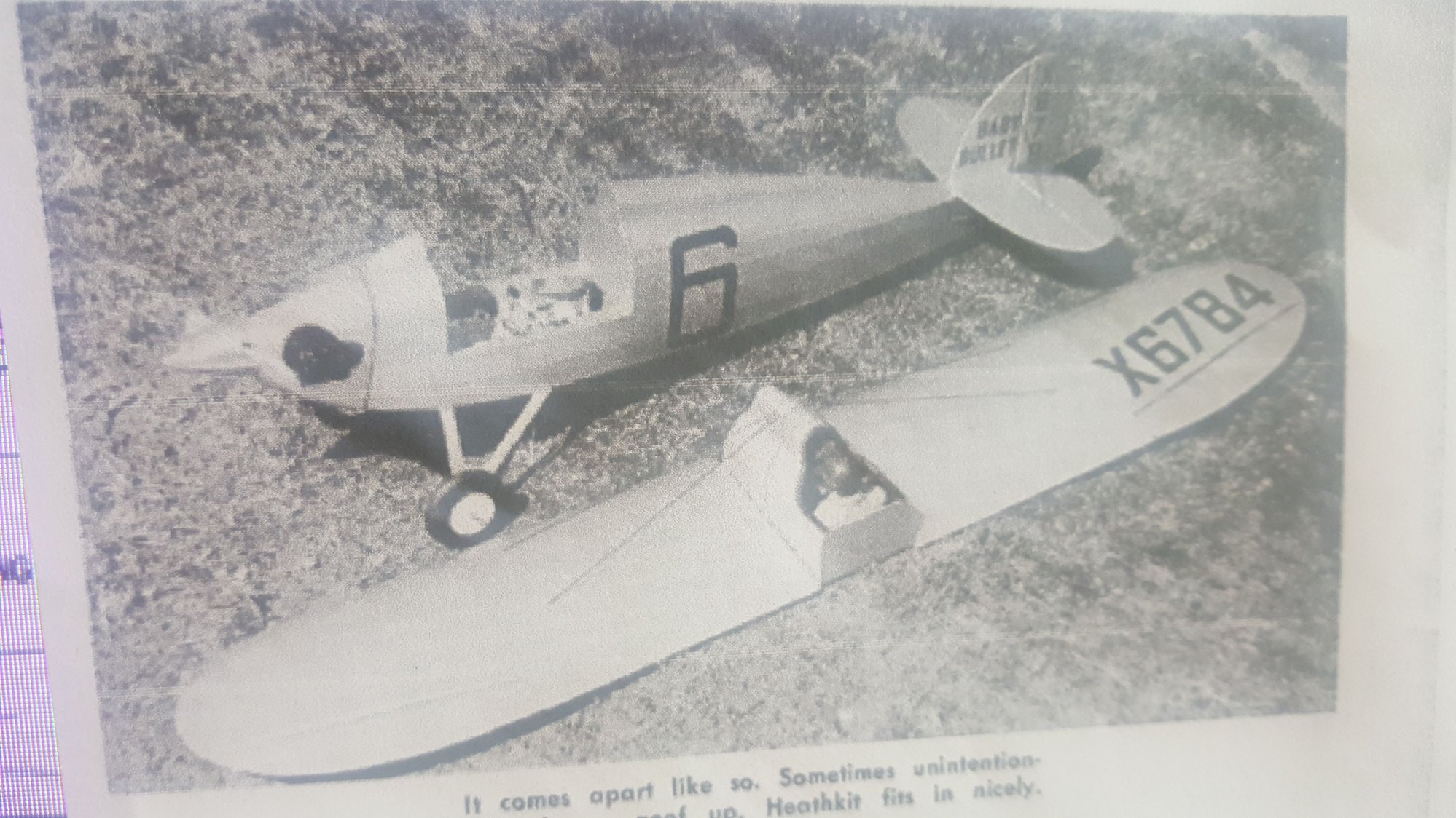

I found the article about
baby bullet, but in the image, the wing is apparently smaller on its leading edge as it enters the fuselage without entering forward.

This one was a toughie. Designed by Nick Ziroli himself. As was stated above, it looks like the leading edge of the wing is going to have to be notched in order for the wing to drop straight down into the fuse. Some careful measuring ought to prove that out. The notch is not shown in the plans. The cockpit is glued to the wing too. The article mentions that it is not for a novice. I guess not if the plans don't show it like it should be.

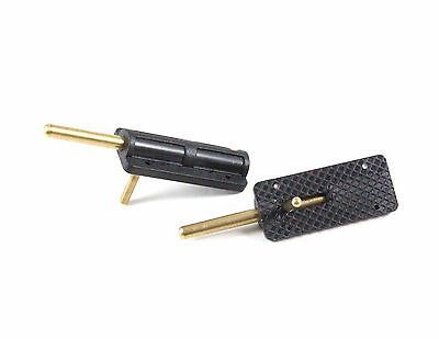

Not a bad idea if going electric power, if going glow power I would look for a different solution. Perhaps bolt the wing on then bolt the cockpit on using additional hard points in the wing. Maybe even use a couple of these latches.

That isn´t the trouble. The problem is that the leading edge does not enter the fuselage. If you look at the image, the leading edge and the wing, it enters almost two inches through the former.

Stearman, a couple of us have already told you that the wing will have to be notched so that section of the fuselage will fit into the leading edge/center of the wing.

This picture may clear things up a bit.

ˇ Good picture and beatiful plane ! Thanks again.
