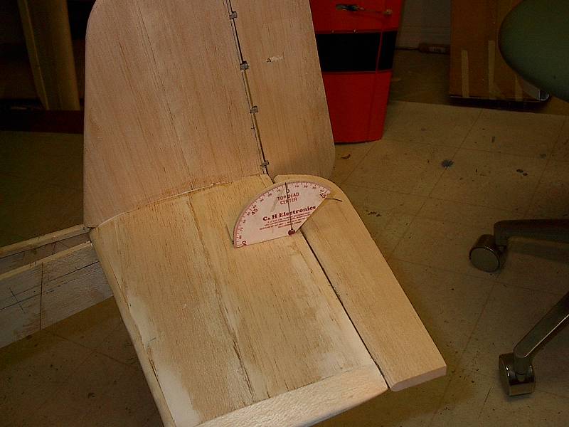

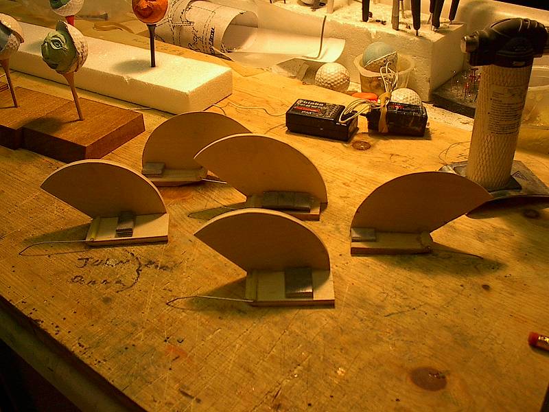

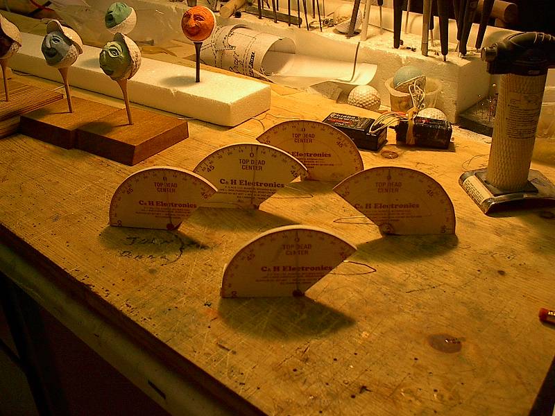

Or you can just use something like this. I make these up with left over wood and use copies of the C&H ignition timing wheels. I make up a bunch and have a few hidden away in my van and when someone is setting up a plane out at the field I loan then one. After that they just have to have one or two of there own, I make them in lefts and rights, for a simple ten dollar bill they can have one!! They really are easy to make and take about an hour with over night setting up of the epoxy.

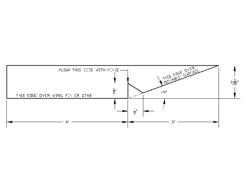

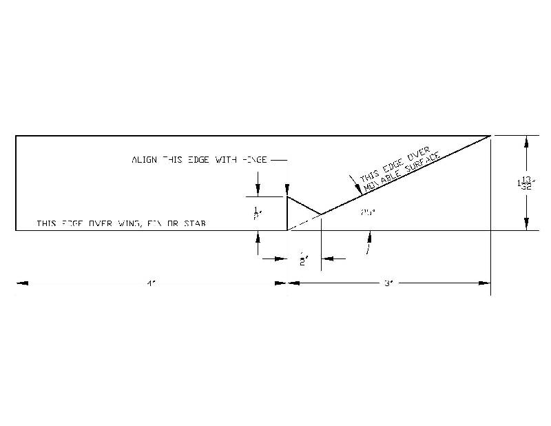

I have drawn three gauges for the angles you need.
If you want, you could copy them in balsa or cardboard.
Note that the vortex of the angle must be in line with the hinge line.
For 15 degrees: 13/16" x 3"
For 20 degrees: 1-3/32" x 3"
For 25 degrees: 1-13/32" x 3"
