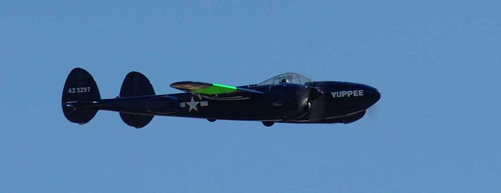

Which kit are those P-38s? They look great and just the right size. Also what engines?

Ralph I built both 38's from wing short kits as the are the best of the best flying 38's in that size (a Hal Parenti design) Built specifically for Warbird pylon racing and I raced them for two seasons, What great fun. Both have TT.46's The Red one was lost to a mid air late in the second season.
