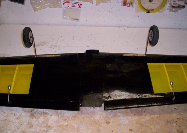

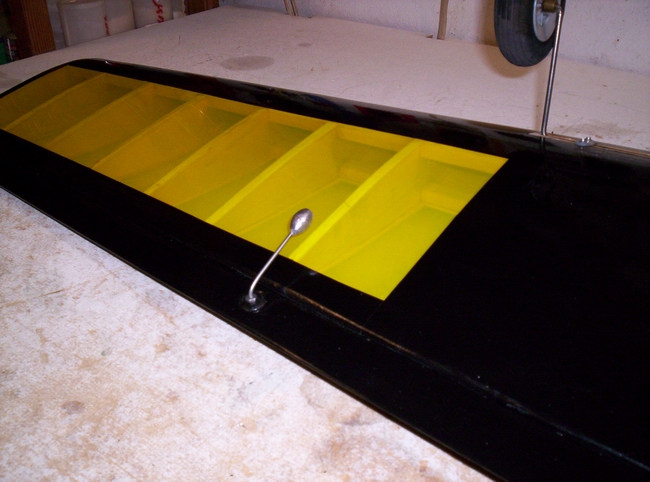

JohnBuckner 01-16-2015 05:44 AM
Excellent AJ First in my opinion your airplane may well be at risk for 'aileron' flutter. Strip ailerons are/were quite susceptible to flutter for several reasons one being loose, poorly fitted or otherwise rocking of the torque rod in the trailing edge cavity. That's the obvious reason and the next that may not be so obvious is excessive flexibility of the aileron stock used. This may have been made even worse in your case since your airplane is an enlargement.
How to test for this and be sure hopefully before you loose a control surface in flight and loss of airplane is that small hole I spoke of in the ailerons for the very simple mass balance that you can make up in half an hour. If there is no more flutter then of course that's the answer and I think your airplane is highly suspect for ailerons.
All that is needed for these balances are two 4/40 threaded rod end wires. Two 4/40 hex nuts, four washers and two lead fishing weights with the hole in the middle and something around a half ounce each. The exact weight is not critical and what mass balance does is to move the airspeed that which the onset of flutter occurs to a speed that our airplane cannot reach.
Mass balance will stop control surface flutter of our models at the speeds we fly them at and it works well. It is a last resort when all else fails. Actually I like when building or assembling an airplane that has had a known history that may have aerodynamic balance area forward of the hingeline I will go ahead of insert some lead in this structure that is forward of the hingeline.
OK its early am now and I am getting ready to head to the flying field and will post some pictures that illustrates this simple fix this afternoon.
John

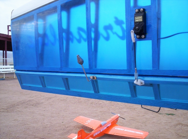

dbacque 01-16-2015 01:25 PM
1 Attachment(s)
Several years ago I had a very fast Hots that had serious flutter problems. Every time I would fix a problem and go faster, something else would flutter. Early fixes were stiffer pushrods, that fixed some of the elevator flutter. Then one side of the elevator was solid but flex in the elevator joiner let the other side flutter. Dual pushrods driving both sides of the elevator fixed that one. A torque rod broke loose allowing aileron flutter, fixed that torque rod with a carbon fiber wrap. Still had aileron flutter, higher torque servo helped that. Now everything was very solid and speeds were higher than ever. But I'd still get flutter in a dive. Finally on one dive the sun was glinting off the MonoKote and I could see that an aileron was fluttering. The linkage was completely solid but as John pointed out, the aileron was flexing. This allowed the root end to be held fast but the tip to flutter. I added a counterweight and the flutter went away. Flew it a few times and finally it fluttered again. I added a bigger weight and flew the plane at ballistic speeds for years. Unfortunately, it buried itself a few months ago. RIP.
Dave

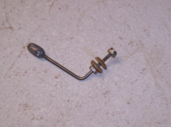

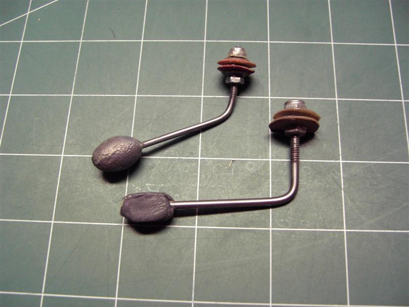

JohnBuckner 01-16-2015 02:52 PM
5 Attachment(s)
Yup:cool:
http://www.rcuniverse.com/forum/atta...mentid=2064264 http://www.rcuniverse.com/forum/atta...mentid=2064265 http://www.rcuniverse.com/forum/atta...mentid=2064266 http://www.rcuniverse.com/forum/atta...mentid=2064267 http://www.rcuniverse.com/forum/atta...mentid=2064268

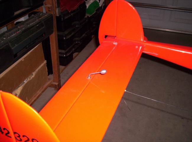

JohnBuckner 01-16-2015 02:55 PM
1 Attachment(s)
http://www.rcuniverse.com/forum/atta...mentid=2064269

JohnBuckner 01-16-2015 08:24 PM
Hi Larry. I just drilled the line hole in the sinker for a slip fit and a few drips of thin CA secured them nicely never had one come off. in some cases such at that blue wing it was done in the pits for a buddy at an event very crudely and just folded, hammered and CA dripped worked like a charm and saved the day.
For a while in the old Scale Warbird Racing Association (now defunct) most of the airplanes being raced were typically popular arf's of the day and engines roughly twice the size of the intended power. These things were always popping off like a machine gun. This simple mass balance works so well and could be installed in just a few minutes at the races that I started making up bunches of them and handed them out like candy at the races.
Back when I was messing with what then were called fun fly airplanes (airplanes that morphed into todays 3D) One type was an arrow shaft design (for the fuselage) with absolutely absurdly humongous control surfaces. mostly powered with various .25's, .32 heck even did one with a OS .30 Wankel . These arrow shaft fuselages were so flexable that you could only use full power in the vertical up line. Any thing over that at any other time the flutter that would be induce was frightening. Have had complete control surface separation many time, Heck any of the controls.
After that on the ships I called the Richochet I installed balances at the tips of all the squared off tips and balanced full 100%. remove a pushrod and that surface float just like it was a cork in the sea. It worked beautifully those airplanes could be thrown around with great abandon and power settings. The 100% balance is overkill of course and for a situation like the OP's its only necessary to use a small percentage, getting the flutter threshold into a speed he cannot reach.
John
