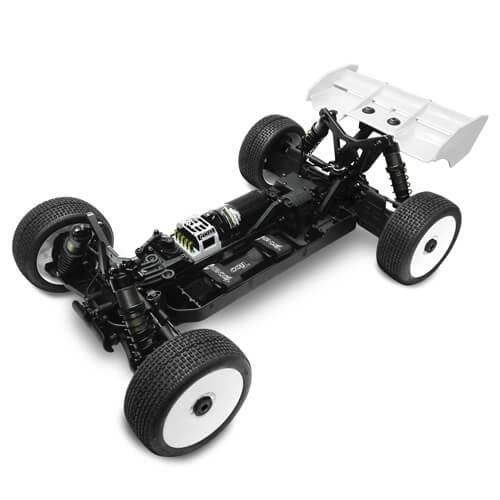

New EB48 2.0 1/8th Competition Electric Buggy Kit From Tekno RC!
EB48 2.0 Features:
  • 4mm CNC 7075 Aluminum Hard Anodized Lightened Chassis
  • Independent Servo/ESC Mount w/ Decoupled Radio Box/Battery Mounts
  • CNC 7075 Shock Towers, Pivot Blocks, Motor Mount, and Caster Blocks
  • 16mm Bore Fluid Filled Shocks with CNC Delrin Pistons and Guides
  • Rear Hub and Arm Insert System w/ Adjustable Roll Center and Toe
  • 3 Fluid Filled Easy Access Differentials
  • Long Arm, Narrow Pivot Suspension Geometry
  • 1-Piece Wing Mount and Ultra-Lightweight Wing
  • Proven Tekno RC Durability
  • All Metric Hardware

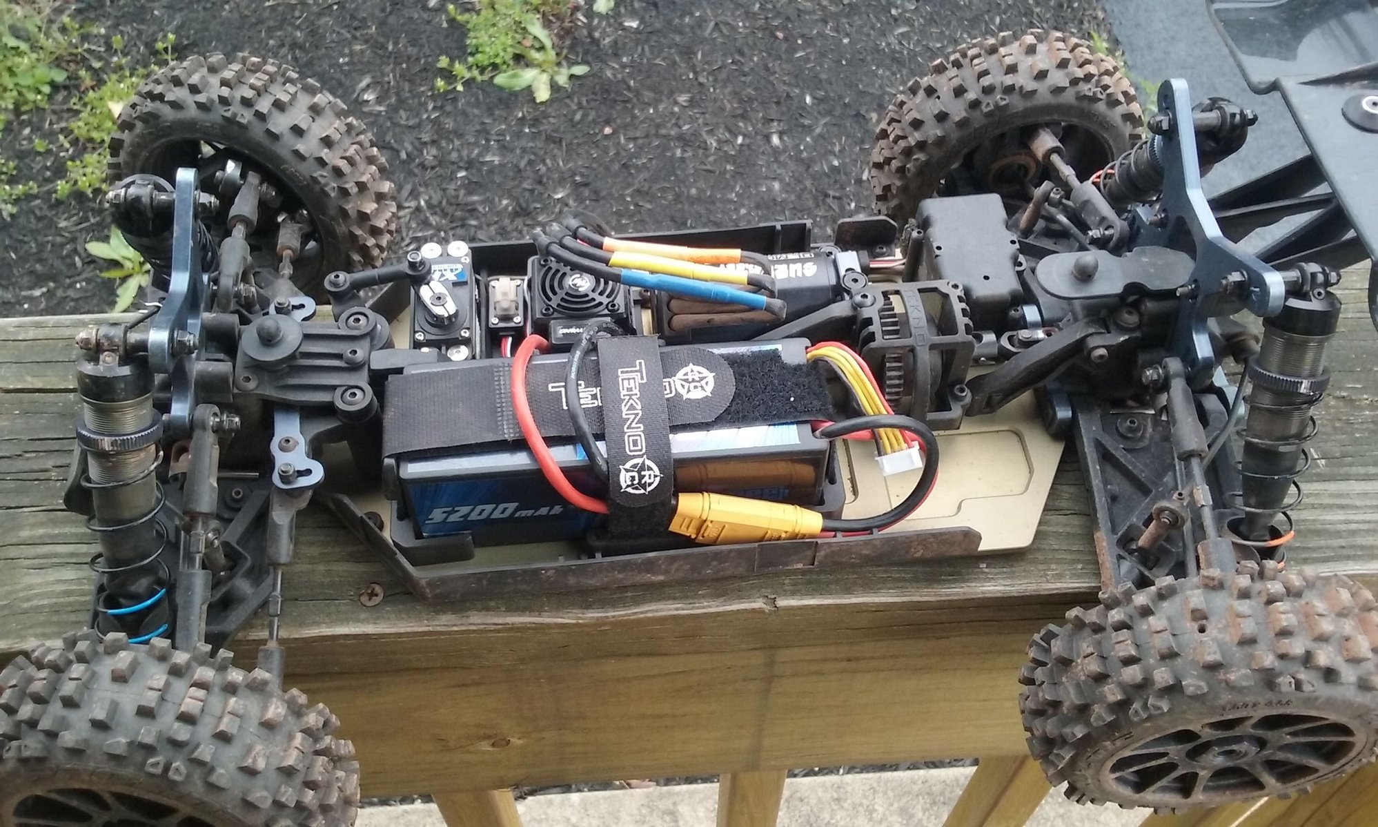

Forgot to post pictures of buggy after paint.

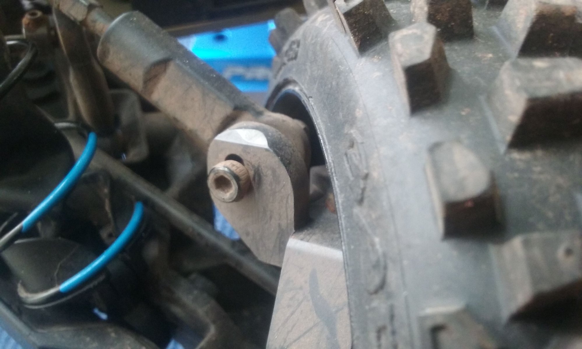

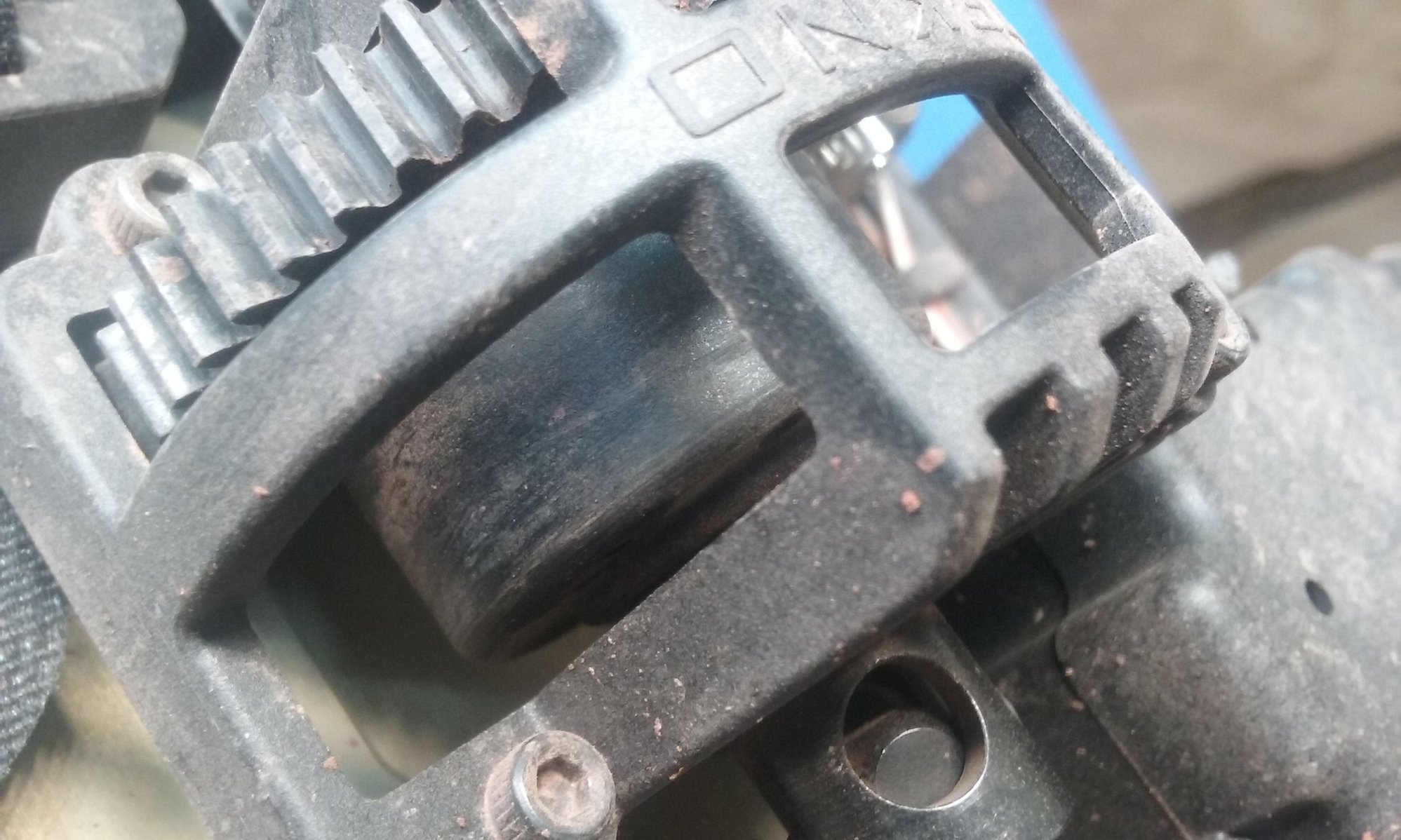

Since I'm the pebble subject, here is some pictures after first run.
Rubbing from rims taking a good amount of aluminum off the carriers.
Smoothing things out...
Rocks got wedged in between center driveshaft and battery...can't keep it pretty forever when running off-road.
Grinding mill.
Another favorite place for stones to hang out.

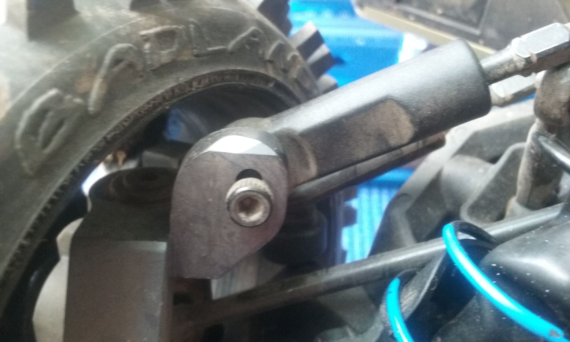

Default Thread Lock Please

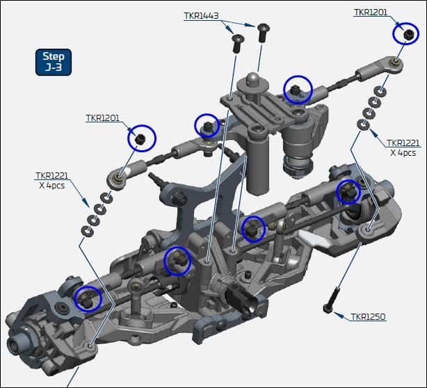

I've noticed the front end's nuts coming loose after about every six, or so runs. That area of the buggy sees the most abuse; I'm sure of that. After last night's run, I am now beginning to put some thread lock on the front ends "lock" nuts (circled in blue).

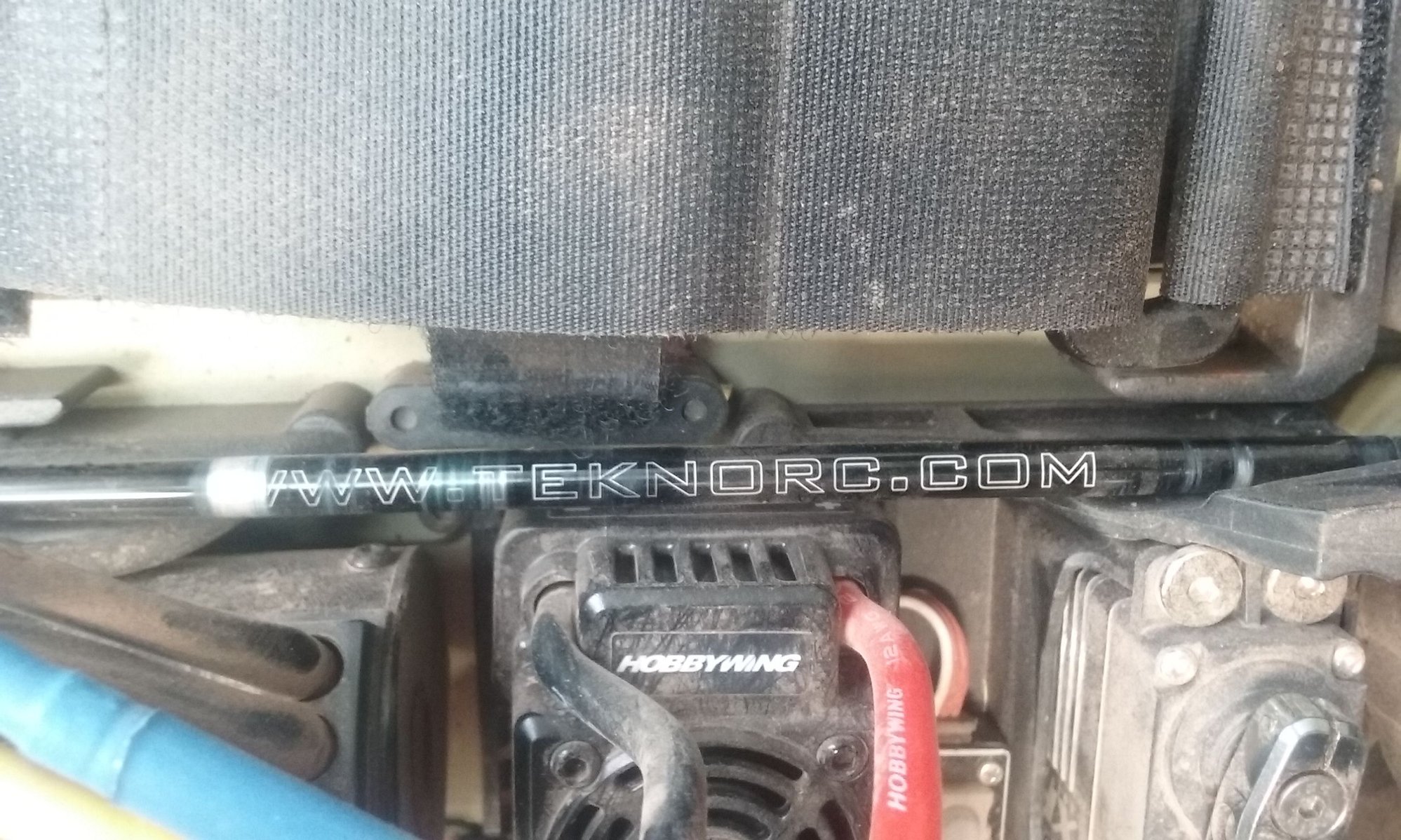

When picking out a battery pack to use in the buggy, I'd definitely suggest a pack that has inboard tubes so as to not have anything get in the way of the wide battery strap. I chose a lower budget 4S pack, but still had to be careful of where the main, and balance leads came out of the case. The balance lead of the Zeee LiPo had me a bit concerned of pinching the wires, so I cut out section of the strap.

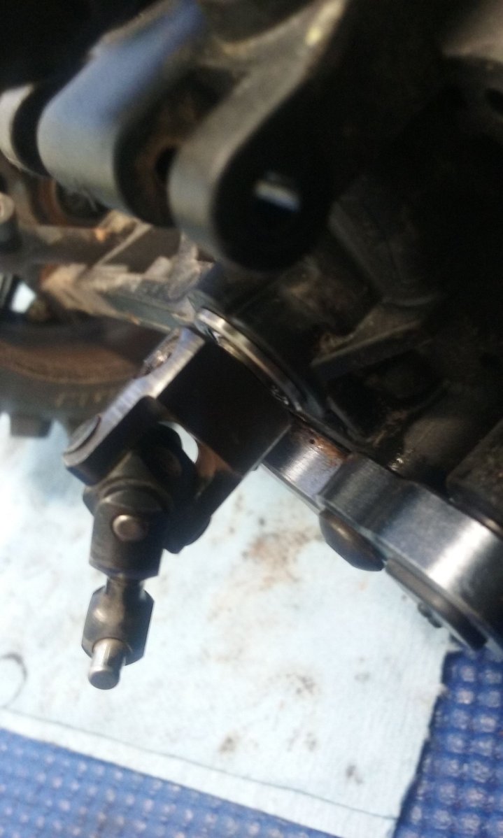

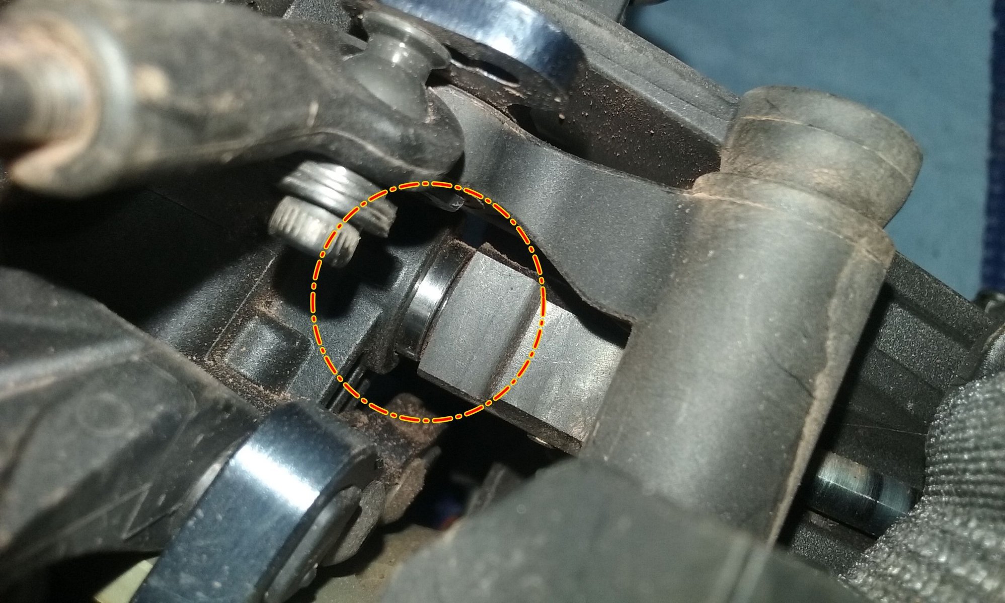

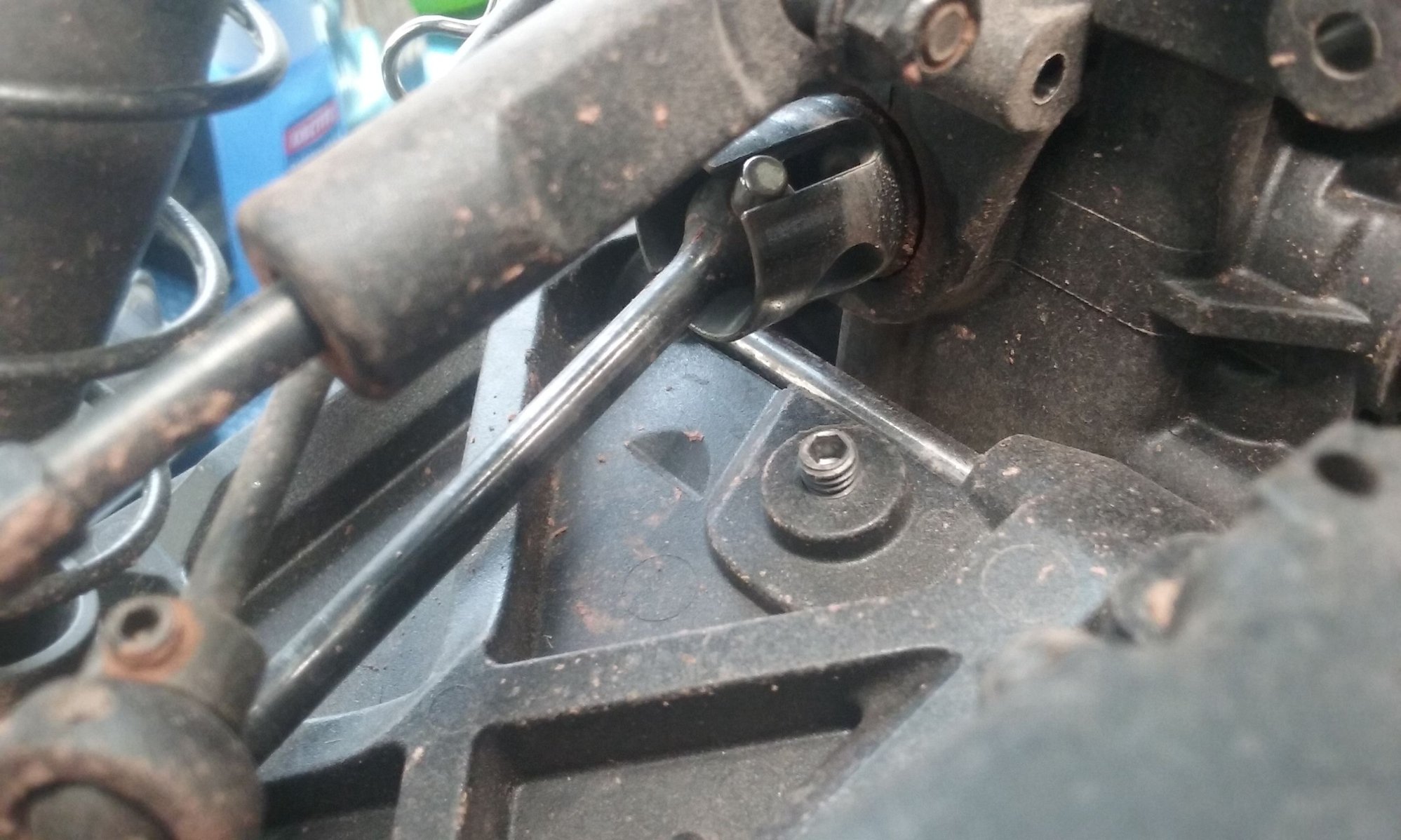

Default Shimming Diff Pinion Gear
When I was going through the buggy and doing bearing maintenance, I found something that didn't look right. Even though I had to use some heat to make the job of loosening the set screws easier, the diff pinion gear started to work its way loose from the grip of the center/rear uni joint, and front diff coupler set screws. There is enough wiggle room for the bearings to start walking out of the gearboxes. They won't come out all the way out, but enough to concern me. Ordered some M5x7x0.2mm shims for the unexpected.

Seems like there is flange bearing mod out there to help with situations like above ^^^. I'm waiting for my bearings to arrive. Apparently, flanged 5x11x5mm bearings are not very common. And, trying to find rubber shielded ABEC 3 flanged bearings in that size are even harder to find .

Yes, Boca is the place to go for those quality odd ball sizes. $11.24 for one SMF685-2RSC #3 PS2 flanged 5x11x5mm bearing . I got some metal shielded bearings to give the gearbox/bearings mod a go. Similar to what is pictured below.

I ordered the metal shielded bearings cause the rubber sealed ones will, more than likely, take weeks to show up. Bearings that face the outside elements...I like rubber seals so that I can clean and relube them with grease. I haven't used oil in my bearings for a long time. I feel I get longer life out of my bearings when grease is used in harsh dusty conditions.

I'm very happy with the flanged bearing taking up the potential slack if the uni joint set screw works its way loose.
5x11x5mm flanged bearings
With three 0.13mm shims between the flanged bearing, and uni drive shaft, only 0.1mm of forward/aft movement is possible if the set screw works its way loose.
Still got plenty of room (hopefully) for any chassis flexing that may occur.
