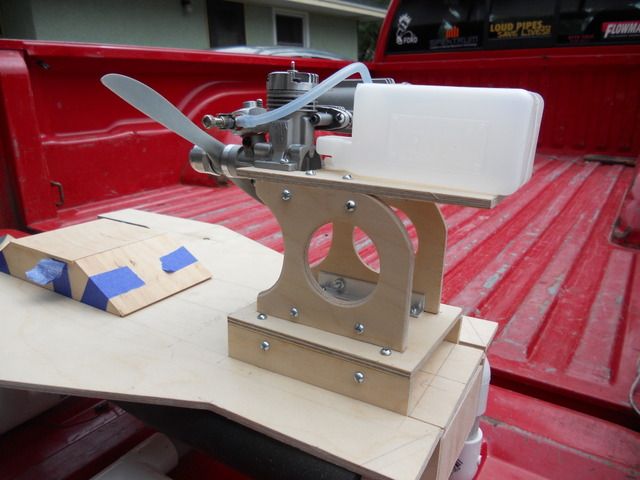

More progress...
Engine Stand:
Radio box and Engine stand mocked up:
I will cut slots in the aluminum brackets to allow the engine mount to move back and forth to adjust CG, but just squaring everything up and getting holes drilled. Radio box is epoxied to the hull now, just need to finish trimming the top of the radio box and get the cables routed. Moving along well..

Engine stand finished..
Hull all glassed up.
She's gaining weight like a mad banshee. Hull as pictured above is 1 pound 14oz. The engine and muffler is 14oz, and the remaining hardware and electronics will add another 6-10oz.. Overshooting my weight goal by a little bit.. I'm hoping I can shave some weight somewhere..
