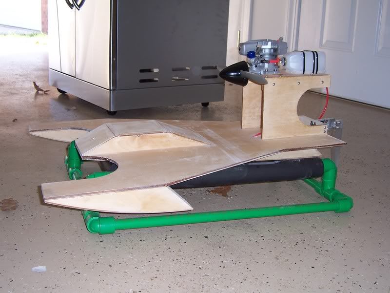

Update: Had a few warm days so I finished the build of the kit. Waiting on a few more to finish sealing so I can install the electronics. Powered by a OS.75 AX.

Alright, Found some time. She is now 95% complete. The engine has 30 oz run thru it and is now ready for some RICH running around the pond. No video of the first running but will vid the second trip to the pond. Planning to run at least 1/2 gallon on the first trip out.

i like that air boat a lot. are you running zero degree wit the angle of the engine in relation to the surface area?
Old 04-15-2008, 11:09 AM
  #42
asmithnc
asmithnc's Avatar
Join Date: Feb 2004
Location: Lexington, NC
Posts: 919
Default RE: Winter project
I always use zero angle. I really have never seen a big difference with engine angles on any(rear engine) puller style airboat. It''s your balance point needs the attention not the angle. There are also differnet ways to correct the attitude but the balance point is the #1 adjustment.

thanks for the help. i am building a Dumas big swamp buggy, and using elec cobalt 40 power. when i saw the SI, and no angle of attack on the motor, i got worried that the 5 degrees on the Dumas was gonna make it do something weird. i can always make another motor mount though if the attitude is weird. but from what you are saying the attitude wont amtter as much as balance.
i heard around 30% from the transom is a good place to start.
do you have any different suggestions?
Old 04-16-2008, 06:23 AM
  #44
asmithnc
asmithnc's Avatar
Join Date: Feb 2004
Posts: 919
I will tell you the Dumas and the SI are from two different worlds. I have never seen a GREAT running Dumas anything. I know for a fact many Hour/days/months were spent with the SI kit. It is well ballanced and there is no need for engine angle. Since I am using a bigger engine than what is recommended I''m sure I will play with the balance.

I finally got a chance to put this boat in the water. The OS.75 AX only had 3 tanks through her at first launch. WOW!.... This boat was fast right from the start. The all stock engine pulled her to a top speed of 56.2 mph. Sorry, but I did not think I would try for a speed run today. So no VIDEO's just a quick snap shot with the Blackberry. I know the picture is not proof but it's the best I could do.
I would like to say a BIG THANKS to CHRIS SELPH. Your laser kit was easy to assemble and easier to to get shocking SPEED!
