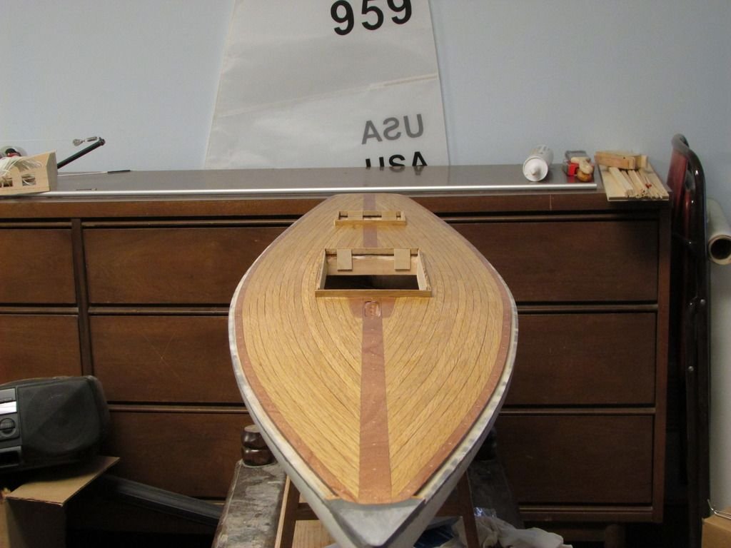

Couple of pics of a sailboat deck I did. Hull is a glass 6 meter so it's 50 inches long to give some perspective. The planks are White Oak, 1/8" by 3/8" by 12 inches long. Outer frame is Mahogany which was placed first. Then staring at the bow I ran one course down each side and let it dry. Then repeat. Took around 10 days but as you can see, was worth it. Last shot is on the paint stand showing off the cabins.

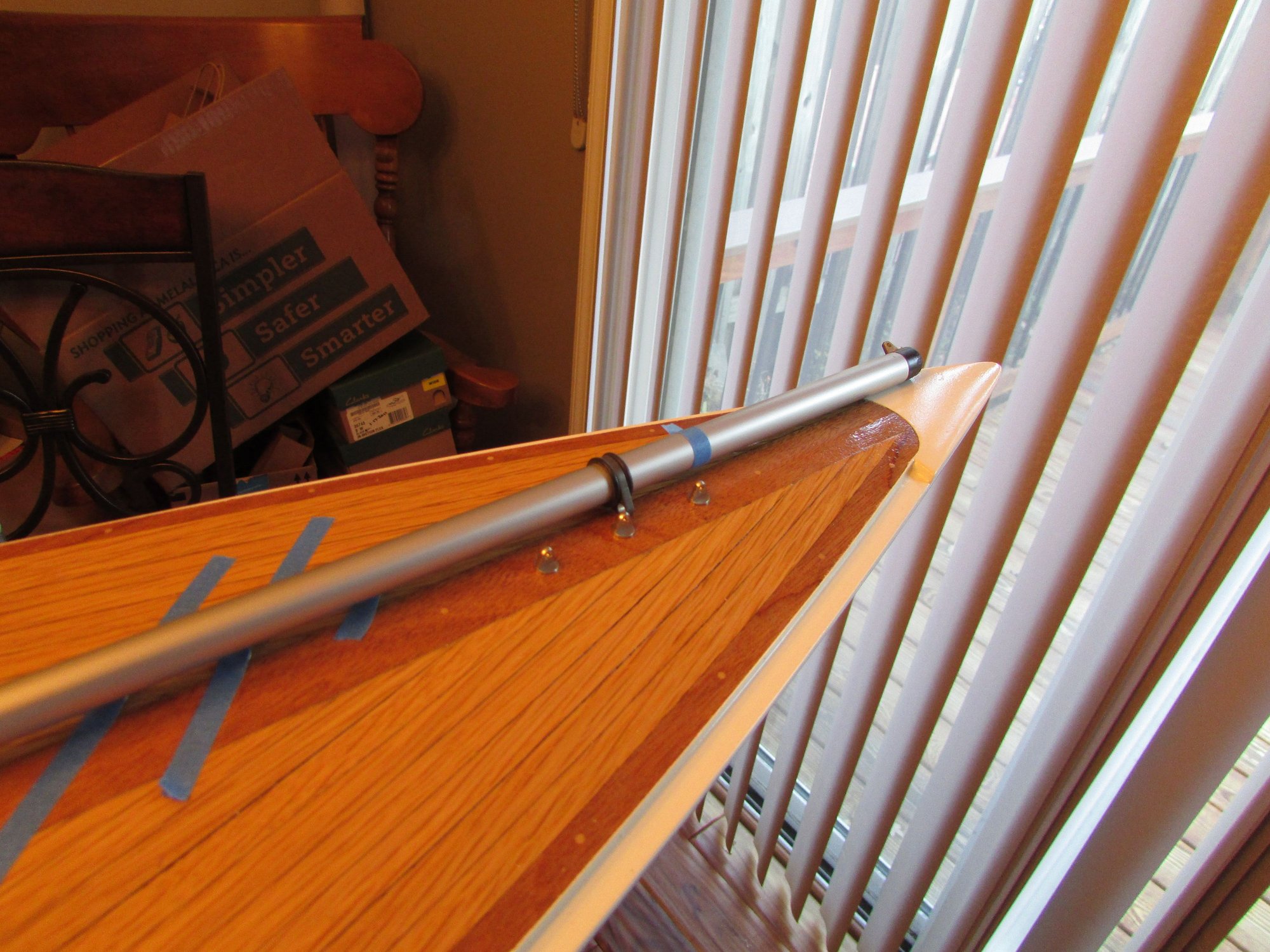

Finished it off with sand paper, epoxy, etc and painted it white. Not unlike you find on some of the full size boats where it has a slight step down from the wood deck.
Here's a pic. Close up on the bow showing the trim of the edge. The very front is solid JB Weld. Pity the hull that gets in the way of that.
This is my first planked deck. Would like to scratch build one of the big 'J's. But at 100 inches plus or minus and 85 to 100 pounds, not sure if I'll ever make it. This one is only 60 inches and has been under construction for way too long. Health issues and moving didn't help either.

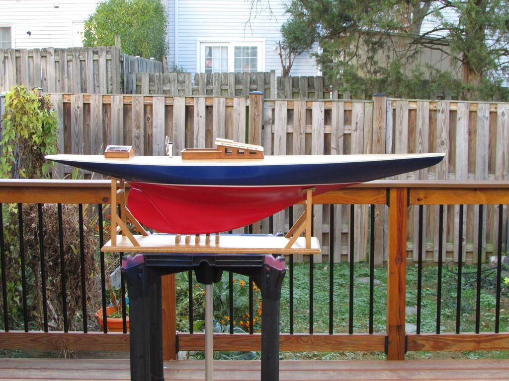

What actually happened is I picked up the hull many years ago at an estate sale. It's not legal for the 6M class since there is no Manufacturer info inside the hull and that class basically is non-existent here in the US. So I've been building it as I would like a real one. Super long project with maybe 10 years of on and off work so far. 10 years interrupted by career, health issues, retiring and moving to another state. I have what I need to complete it I just have to get off my duff and do it.
The cabin and dog house are my own design based on looking at many, many pictures. Sail plan and all is also my own. 75 inch carbon mast and over 2000 square inches of sail.
The deck planks sit on an underlayment consisting of 1/32 ply topped with 3 ounce glass and finishing resin. And of course there's framing under that. The dowel pins you see in the mahogany trim are functional. Did a pilot hole down the strip of wood. Then did a temporary attachment to the hull while I used the pilots in the wood to guide a pilot in the top of the hull. Then I epoxied things down using the dowel pins and clamps to hold it all in place. Gave it 3 days to set. Then went to work on the deck White Oak planks. The Oak is nice once finished but a bear to deal with. It does not want to bend. And once I had all the planks down, I spent 3 days with an orbital sander making everything smooth as silk. Not sure I have enough years left to do a bigger boat.
Anyway, I hope the OP is encouraged by all this. Simply put, quality work takes time. But it is worth it. I smile with pride every time I look at this boat.
