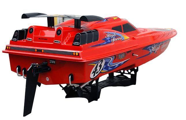

Hi Hydro Junkie, I think that I sent you mixed signals on my last message. The Ocean Queen 3 has a transom style outrigger rudder mount. This weekend I am going to disassemble what's left of the top of the rudder to get dimensions for fabricating a new one. Aluminum sanded down to a thin blade should do the trick I am hoping. If you go on google and do a search for Ocean Queen 3 in google images, there is some pretty nice pictures of the boat and some nice pics of the stern showing the rudder. I did get a message to search for one on the Banggood site. But once again I'm not sure of the size. So I was told to measure from the top of the rudder down to the bottom of the prop wash for length, I am guessing to the lowest edge of the center prop at its lowest point or should I go a little below? Thanks, Marty

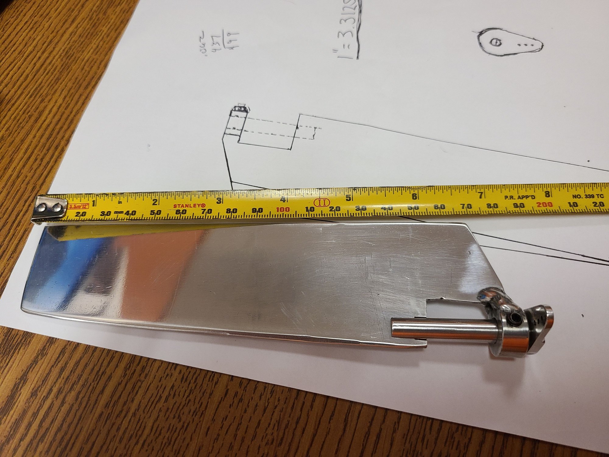

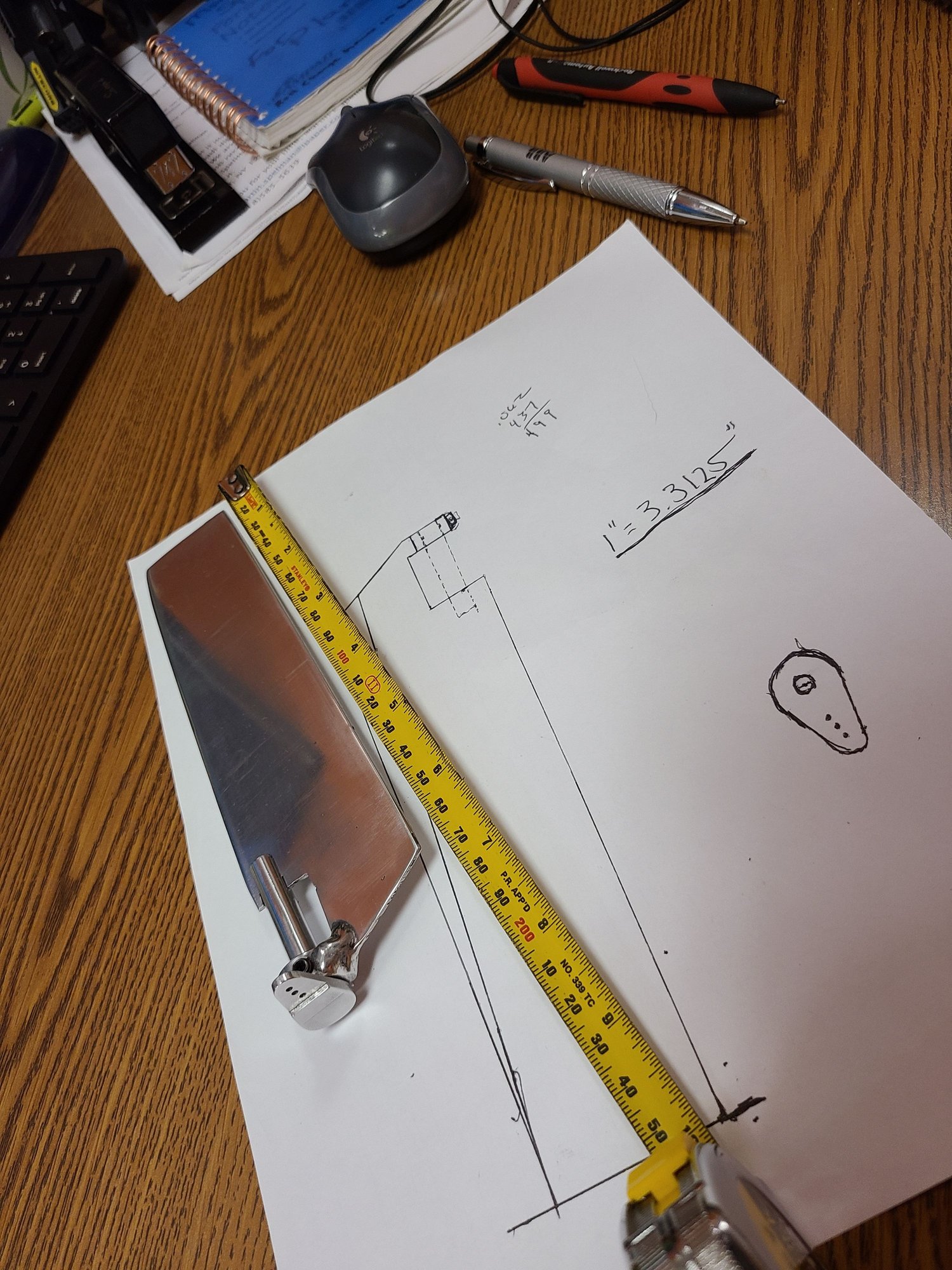

This is my rudder design that I tried to draw up to scale from one of the pictures of the boat. It looks fairly close.
This is one of the google images
This is the actual transom of our boat.

Still working on fabricating the rudder for this weekend. Everything is done and made out of aluminum which should hold up fairly well. The only thing left to do is to weld the collar to the rudder if by chance it can be squeezed in between jobs today. Once the welding is done, I'll polish it and spray it with acrylic spray and when it's dry I'll post some pictures of the finished product and then I'll get ready to install it back on the boat this weekend!

Well here is the finished product of the fabricated rudder made from a picture and scaled from picture for size.
It came out really well, better then expected
All aluminum fabrication, now just have to install it on the boat this weekend and try it out. I'm sure that I will have to do some minor filing for fitment. But least of my worries now!

Looks good to my untutored eye. Sometimes I wish I had done metalwork back in my schooldays....

My competitive eye sees a little more work being needed:
1) The leading edge needs to be sharpened to reduce drag. I know, it's a work in progress, just calling it as I see it. This is the last step that needs done so don't worry about it until after you've finished your other fitting and testing
2) A flat spot needs to be filed into the round shaft where the set screw is located. This would prevent the shaft from working out of the collar and causing a loss of steering
Other than those two, I LIKE IT
