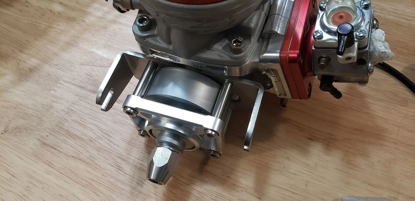

I am running a Zenoah G300pum engine in a 57 inch Enforcer need a new clutch What do you recommend

Bonzi Sports clutch ,although a little pricey will hold up to any engine,even twins and Bonzi has replacement parts like shoes for it.You can buy cheaper but won't get the quality. https://www.bonzisports.com/product/...grated-collet/

Bonzi certainly make a great quality clutch though it is no bargain and is quite large. They hold up to 70cc quickdraws without issue.
Gizmomotors has a unit for under $50 and is about as compact as they get. Holds up well and for the price you can replace the whole thing for not much more than the price of replacement shoes for other styles. https://www.gizmomotors.com/online-s...utch-w-coupler
