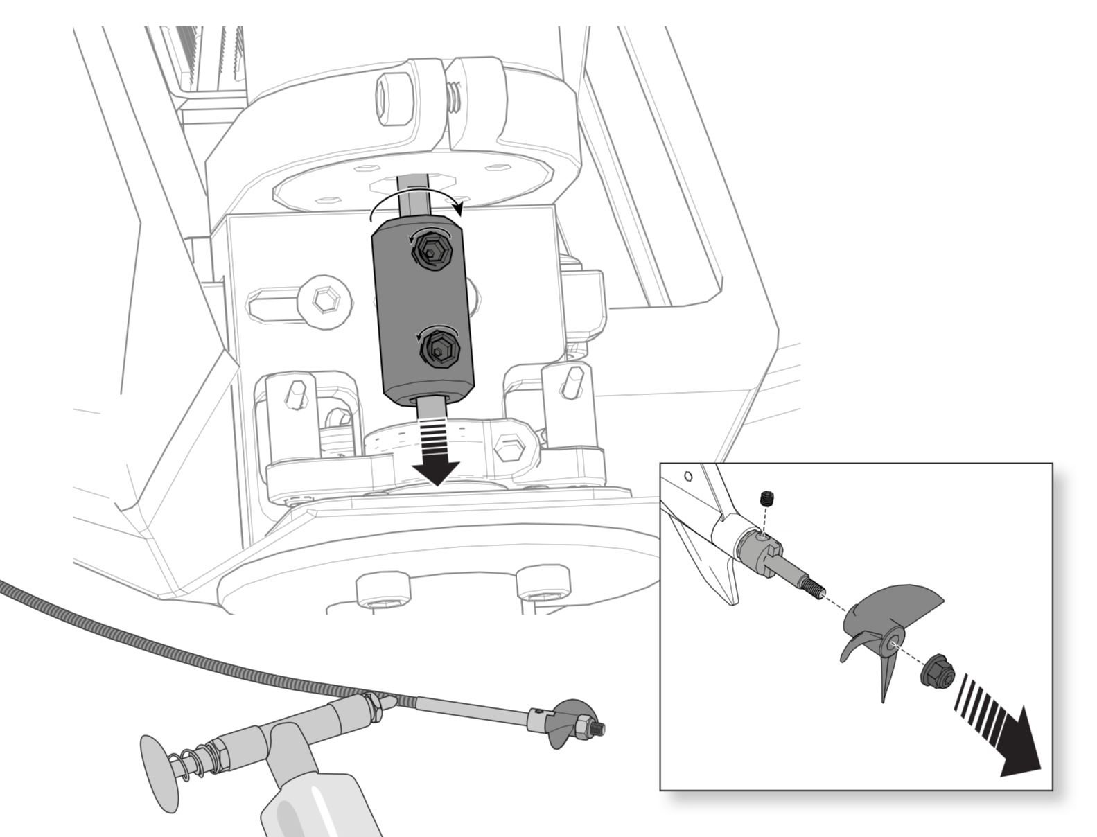

Iím sure most here are quite seasoned but I have a discontinued proboat Valvryn F1 tunnel hull I lost the original flex shaft the new that came is not the correct size however Iím wondering if this boat could be modified somewhat with a different driveline perhaps basically Iím just trying to salvage a boat

Is the collet(the part that connects the motor shaft to the drive shaft) actually too big or too small? Something isn't sounding right. IF it's the original collet, the flex shaft, if it's the right size, should fit like a glove IF the collet outside nut has been loosened enough to let the cable into the collet

I think there is a terminology issue here. The drive dog does not fit in the motor coupler, it sits on the solid portion of the driveshaft in front of the propellor. The original motor coupler which came with that boat is a set-screw type, not what most would call a collet - see below. Perhaps the boat has an aftermarket coupler installed and that is why the flex shaft wonít fit. A photo or two would help us.
