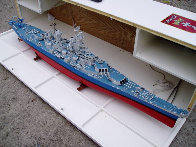

I have built electric RC 1:350 Yamato from Tamiya kit.The drive applied to a kit has undergone to completion (the gearbox is separated into two parts and bearings are inserted into it; in places of an output of shaft bronze cartridges are inserted). The model is controlled by a rudder and a separate reverser of motors.
I use this model more than 5 years and is very pleased with the chosen ship. The only problem - model it is poorly visible on water because of dark gray war painting[]. My friend built Missouri in blue and it's better visible.
On pics:
1) Me with my Yamato on 2003' NAVIGA NS group World championship (in France)
2) Missouri of my friend Dmitry - World champion 2003 (Naviga version)
Alex.
