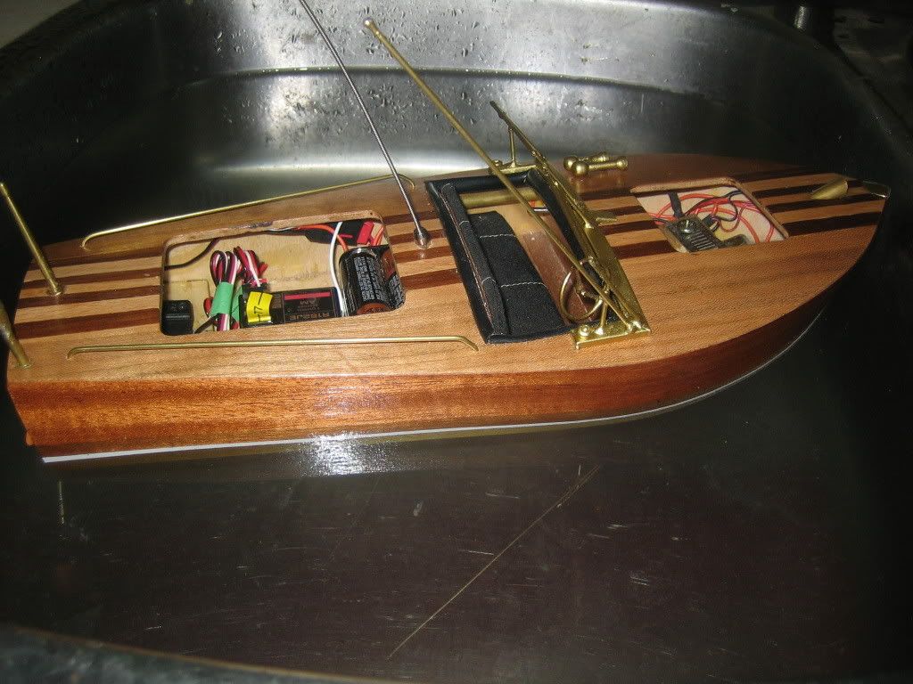

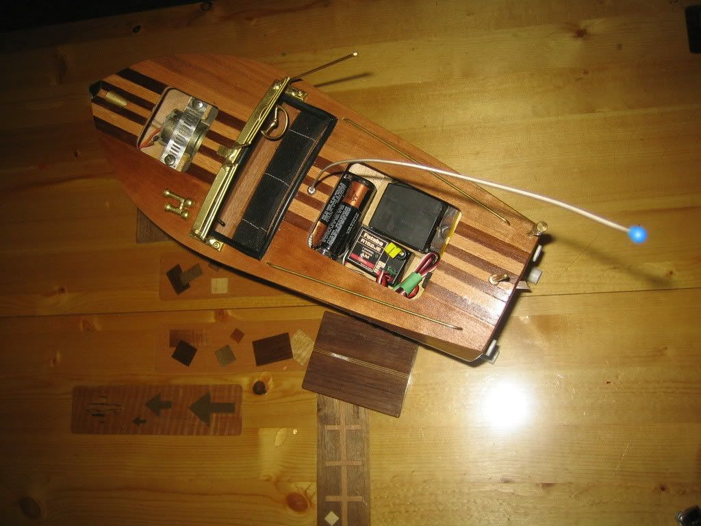

so heres my little boat. it measures approx 13"x 5"x2.5" at its deepest point. it floats!
actually it sits very well in the water. (red paint is pretty much the waterline-back of the boat anyway)
the motor was a $1.99 special from a surplus automotive center. its only marked 12volts. i clipped a 9.volt batt to the boat, and it seems more than enough to power this small model (threw it in the swimming pool)
changing out the motor isnt out of the question, but seeing as this will mainly be for boating around in the pool with my nepthew, it doesnt need to be fast
i did vist the hobby shop to pick up a prop,oiless bushings, dog bone etc for the the drivetrain.
now i'm really limited for space. a friend of mine has a small plane (fiberglass nova?) it houses a small lithium ion batt, a tiny reciever, tiny speed control and servo's. i'd like to fine similar products for my boat.
i'm gonna need a one radio (for both boats),speed control,servo and battery, and eventually the same for the steamboat in the future (approx 3')
i'm not a die hard rc kinda guy, so i dont need the best of the best. i would however like to purchase quality components and not brake the bank.lol. i realize ya get what ya pay for and its not a cheap hobby. other than knowing the items i need, i have no product knowledge. i was hoping you guys could help with the selections and turn my model boat into an rc boat.
i realize this is probably not the sort of models that are made here(speed wise) but any help would be greatly appreciated.

Thats a cool little boat. How did you go about finishing the clears and stains I have a boat Im wanting to leave clear and put a bit of gold leaf lettering on and then stripe around the lettering then clear the whole thing.

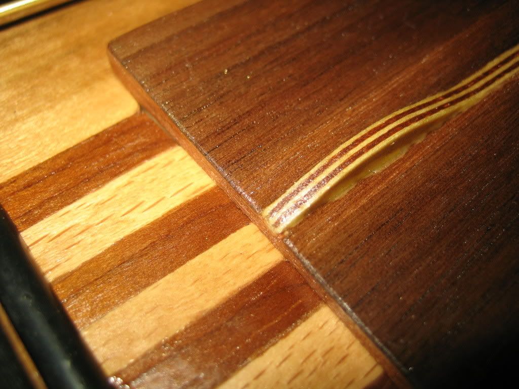

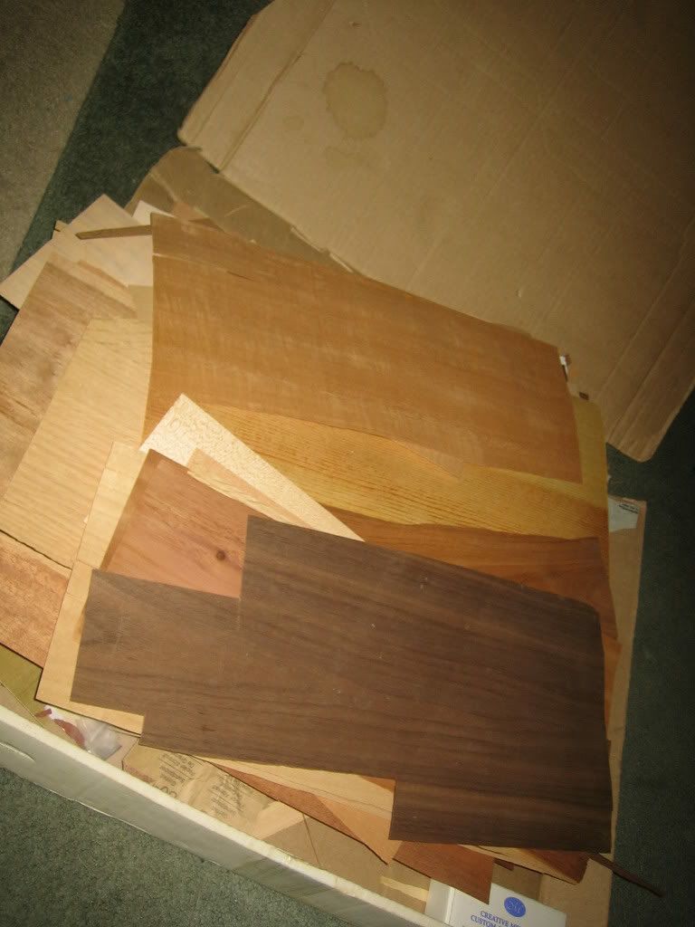

i actually purchased a large pizza box full of exotic veneers a couple years back.
the boat isnt stained. it's been completely skinned in the veneers and clear coated with an exterior lacquer. spar varnish would probably be a better chioce but i hate the stuff. lacquer is easy to spray and dries fast. i doubt its as water resistant over the long haul. the veneer is easy to cut with scissors or an xacto. it was glued inplace with woodglue. the veneers are so thin they like to curl. i used tape to do most of my clamping.
the red white and gold were also colored lacquer. it probably has 15 to 20 very thin coats. (extreemly fast drying time, but its best to allow the lacquer to cure)

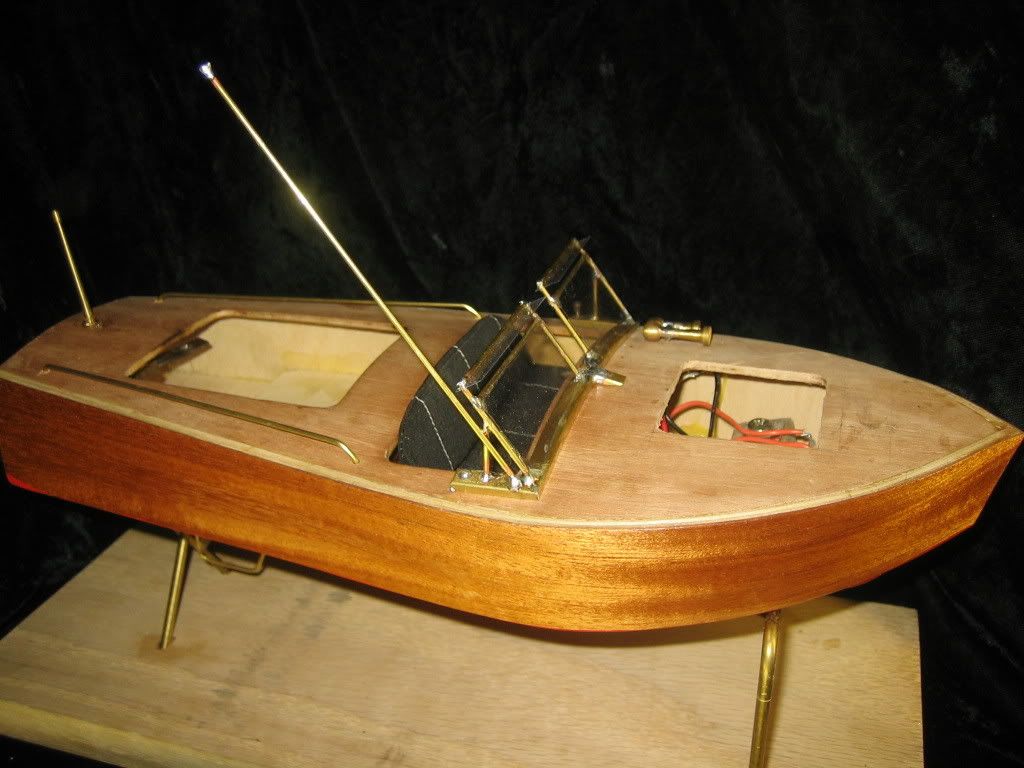

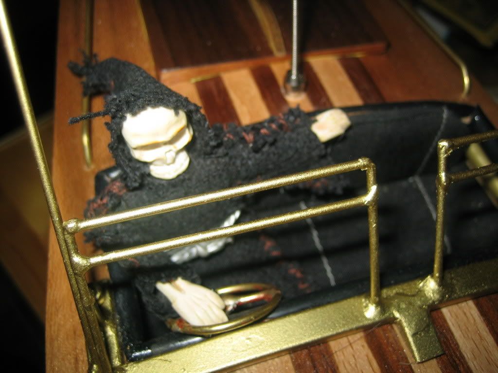

here another shot of the boat before i veneered the deck uncle crash

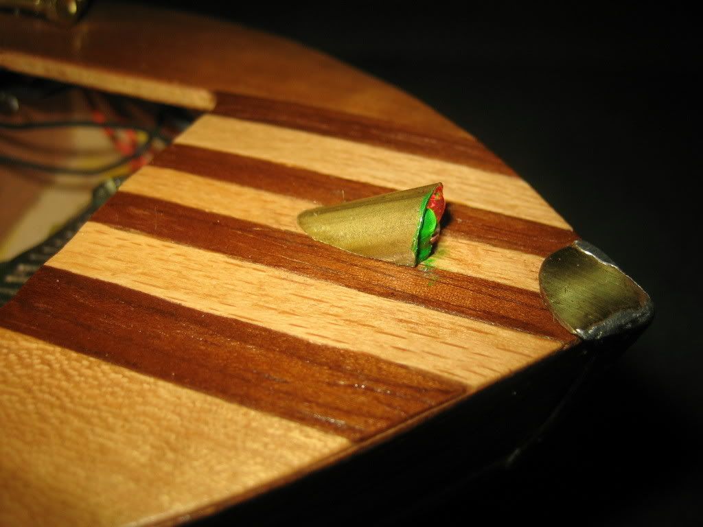

i added lights to my boat on a seperate system and hid a toggle switch under the dash. there powered by 2 rechargable aaa's. it never occured to me they could be connect to the reciever.
still not sure what i'm gonna mount the front lights in, or how i'm gonna go about turning the white led green (couldn't find a green one).

For the lights, you can make simple molds for pouring epoxy resin into, and sinking the lights inside the liquid resin, then painting the metal silver housing on it or using press and stick chrome foil that plastic modelers use, and leaving the lens clear.
Just carve a small master out of balsa, mount it to a flat surface and coat it with white glue. After that dries, use red RTV out of the tube to coat that for your rubber mold. When that is dry, peel it off and you will have a mold cavity to sink your LED into and pour with epoxy.

i ended up fashioning a front light out some brass tubing before i read the epoxy mold trick. alittle green model paint also fixed my color problem.

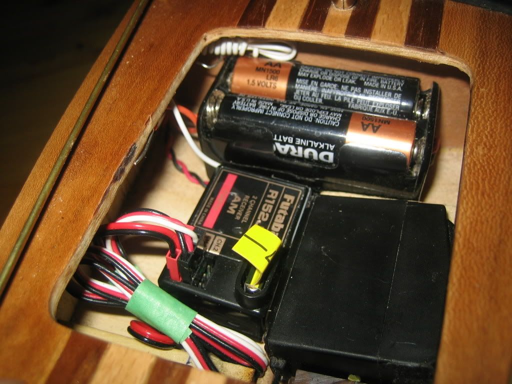

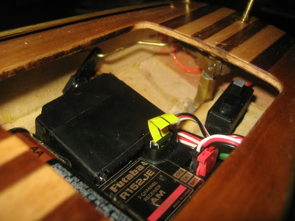

i picked up my radio. its a magnum 2pl am radio by futaba. pistol grip, 2 channels and dirt cheap. figured i'd keep it for this boat and move on to a better radio for the steam ship when im ready (end of the year) my girlfriend always has a hard time purchasing xmas gifts for me anyway.
i ordered a miniture speed control and mini servo. i'm still unsure about the battery and motor though. i need one as small as possible, so i'm thinking lithium ion. i'm still confused how i match up the speed control, motor and battery pack with the correct voltage.
what do i need? thanks again

almost all rec. on the market have bec battery eliminator circuit built in so you plug the esc in the rec. and hook the batt. to the esc and it in turn powers the rec. and the speed control and servo for rudder all off one battery and if your space is aproblem get a cheap lipo and charger just be careful not to discharge it too low (3 volts per cell) try e-flite for [email protected] good luck

It's fairly simple. You should know what current draw the motor 'likes' at what voltage. The ESC would have to be rated to supply that amount of current at that voltage, and the battery should be able to supply both to the ESC. The capacity of the battery Ah/mAh can tell you how long it will last (close anyway). You have a little 'fudge' room with voltages, but there definitely are upper limits. The smallest 'upper limit' is the actual 'limit' of the system and shouldn't be exceeded. Most of those 'limits' just require some thinking and common sense. And from there the choices for each component gets sort of 'huge', lots of choices. And of course, adding a fuse never hurts much...

so after a few attemps at fitting my reciever and servo's, i finally have a combination that works. (i think)
i should have just enough room to upgrade the batteries to a rechargable pack and add my speed control.
my first attempt at placing the electronic's was a complete failure. after fitting everything in place this tiny little boat was very lop sided with most of the weight in the rear left corner of the boat. my battery placement was the problem. i centered the battery and moved it as far forward as possible. heres how it sits in the water.
the kitchen sink should give you an idea of just how small the boat is.
what do you guys think about the position the boat sits in the water? does it look alright? i've considered purchasing single batt cells and fashioning my own rechargable battery (or just rewiring a battery pack to fit my space). theres not enough space in the nose to fit a pack but i do have room to fit a couple/few single cells on each side of the motor. good idea? or should i leave them where they are?
and one last question.
can i use any metal object as an attenna? i used on old bass guitar string and and connect the attena to it. (didn't want a big plastic sleeved attena on the boat) will it work? or will it hinder my reception? it seems o.k. but i just wanted to double check.
i'd just like to thank you all once again. and sorry about all the questions.
couldn't have done it without ya.

Changing the receivers antenna WILL affect your distance for operation .
Each manufacturer has tuned their receivers to a certain ohms and is done so within the receiver itself and is set for whatever length the antenna is set at . ( as is the same with how many strands and how thick each individual wire inside the braid is , OR , how thick a single wired one is )
You CAN leave any excess antenna wire INSIDE the hull , but do NOT wind it around anything , or wad it up . Leave it as stretched as possible .
Think of years ago , before cable TV came about , when you ( or your dad ) had to get up on the roof of your house and mess with a TV antenna .... the higher up the antenna , the better your reception . The lower ... the worse your reception . This basically holds true for ANYTHING that receives a radio signal transmitted thru the air .

ok so how much will it effect the distance? this is a 13" boat and distance is realitive (as i've been told) it small and i cant see this thing ever being more than a hundred feet from me (mainly to play in the pool)
it works at that distance. and seems to function fine the way it is. should i change it back to just the original attena? is it ok to leave it the way it is considering i'll probably never max out the recievers distance? can it cause any other problems to the rec. etc? thanks again.
Join Date: Nov 2003
Location: McAlester,
OK
Posts: 1,768
icyuod2,
Your home-made antenna should work just fine. The length of the receiver's antenna/aerial isn't "life/death" critical at all. Of course, longer is going to have more range than shorter. That "longer" also pertains to 'shape'. The higher you get the thing above deck/water, and the least you 'hide' inside the boat, the better. Coiling an antenna, or wadding it up, etc, is just like cutting the wadded up portion out of the circuit. I may not have a bad affect depending on a lot of factors, but it doesn't really do any good either (the wadding it up thingy).
The receiver's antenna length, no matter what it is, isn't going to affect the receiver's 'health' at all. Usable range, yes. Health, as in letting the smoke out, no.
Wanna 'chop' that antenna down to a sort of 'scale' length on that 13" boat? Try it, but do a range test! If it works at the distances you require, fine. If not, then lengthen it till it does. If it's conductive, you can make an antenna out of anything.
R/C radios are not 'communications' grade by orders of magnitude! They are very simple, uncomplicated things with limited range (primarily from antenna length). Would you really want it to be able to 'hear' transmitters in another town, much less country?
- 'Doc
[Got a TV antenna? If you really get bored, try hooking your R/C receiver up to it with a servo attached. See if it 'twitches'. Bet it does. It isn't 'interference', but misc. signals on that band from who knows where.]
- 'Doc

i finished both hatches and added a couple wraps of yellow teflon tape to make for a waterproof seal.
i also started to add the finishing touches to the boat. i turned some bumpers outta balsa. i used sand paper and just turned them by hand.
i also fashioned some tie downs outta screw hole buttons. i sanded the sides and used a small carbide dremel piece to make the hole for the rope. a little gold paint to finish them off.

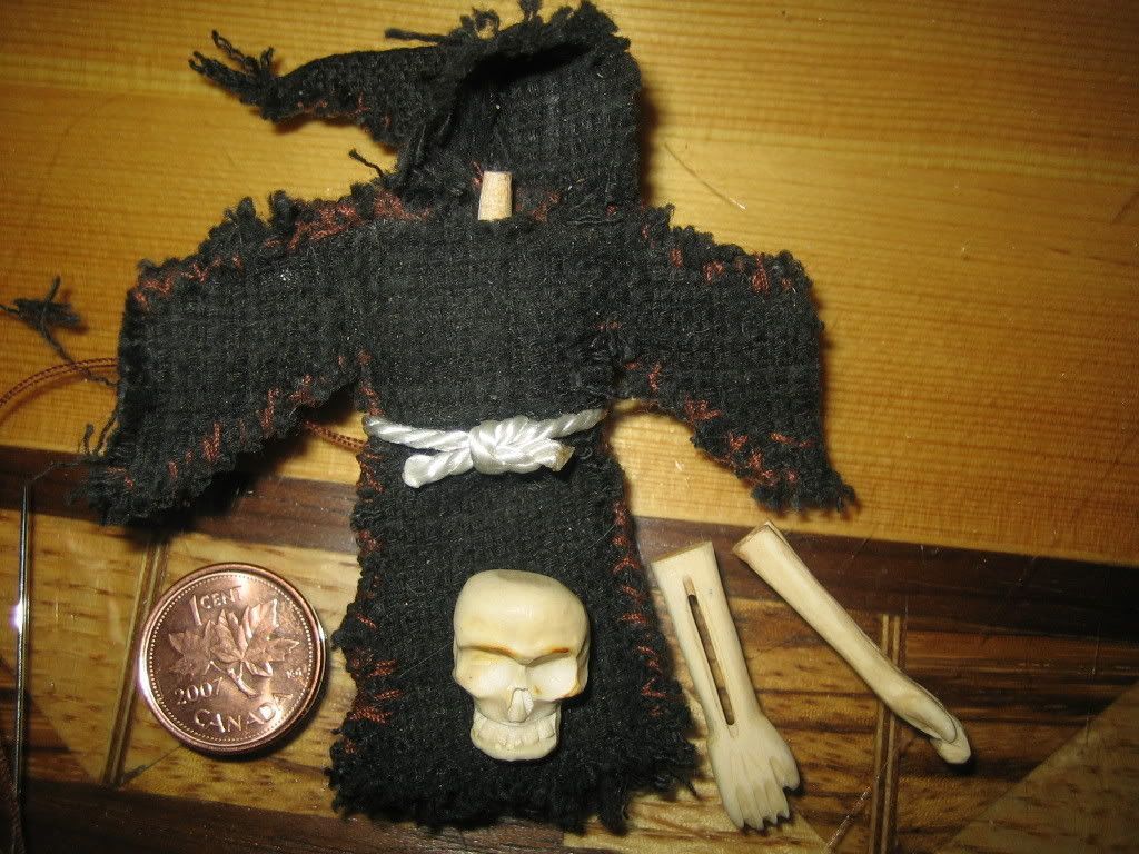

i'm jumping the gun, so back to the model at hand. my boat needed a pilot for the craft. i wanted to keep it a scratch build, but to be honest i dont think i have the skills to fashion a person. i took the easy way out and crafted the master of disaster himself outta some 40 000 year old mastadon ivory scrapes i had in my just draw.
just cut/shaped it real quick with the dremel.
so here it is, the almost finished project (just waiting on esc/motor)
