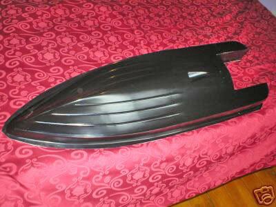

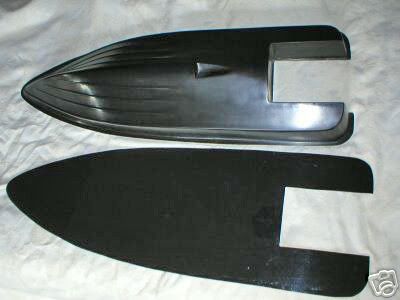

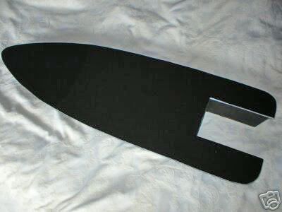

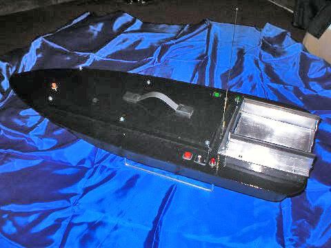

here are some photos of the hull, it measures L = 36" W = 12"
finished boat
when it comes to epoxy, which is the best to get? just your typical epoxy with 30 min dry time so you have plenty of time to work with it before it hardens, etc... because ive used 60 second epoxy before and it hardens WAY too fast.
i will take some detail photos of the inside of the hull, these photos are from the guy who makes the boat so that's all i have right now. i should get the hull probably within the next two weeks im guessing.

Tell us more about this hull and where you found it. Never seen this before myself. What's up with the rear being open?
Old 06-09-2008, 07:40 PM
Big Buffalo
Join Date: Apr 2005
Location: Dallas, TX
Posts: 107
Default RE: resins, sealants, fillers, etc
the hull is from the UK and they're called bait boats, it's for fishing....puts bait out in your area basically. i finally found the proper hull so im going to attempt it. i have no RC experience, but i am learning quick. these boats are helpful because we need large amounts of bait far out....like 10 lbs at 150 yards, etc.. i hope that makes sense.
