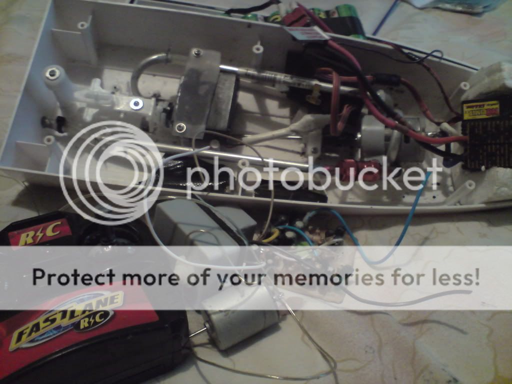

my camera is flat but i dug this up. this is the boat and my "attempt"
at doing it up. "water cooled" upgraded to a 400 size johnson.
all that boat dig was fill my boots up with water from numerous retrievals.
regardless its fixed now and done half well, even if i did waste half a day.
help appreciated cheers.
worst photo ever [:@]

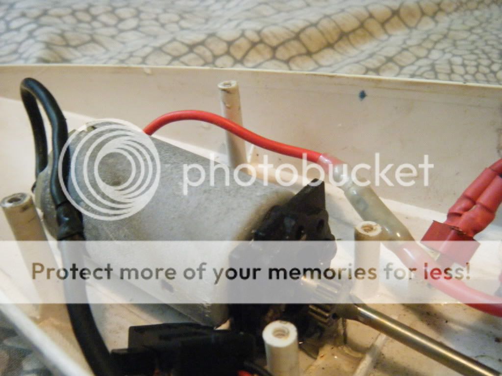

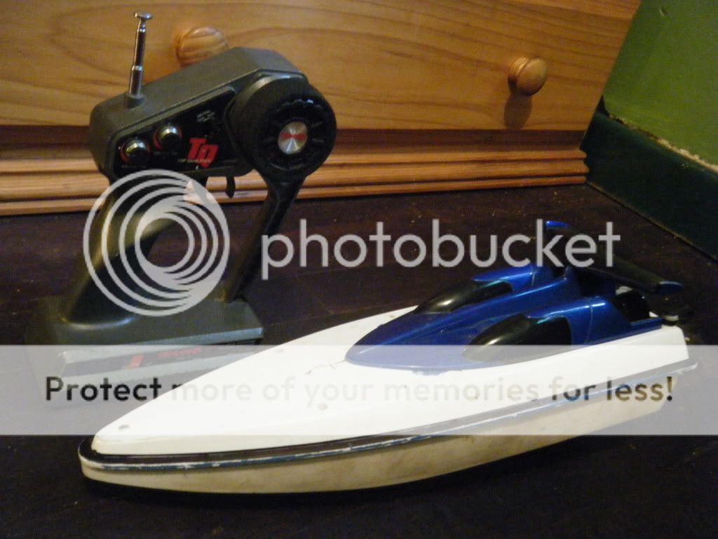

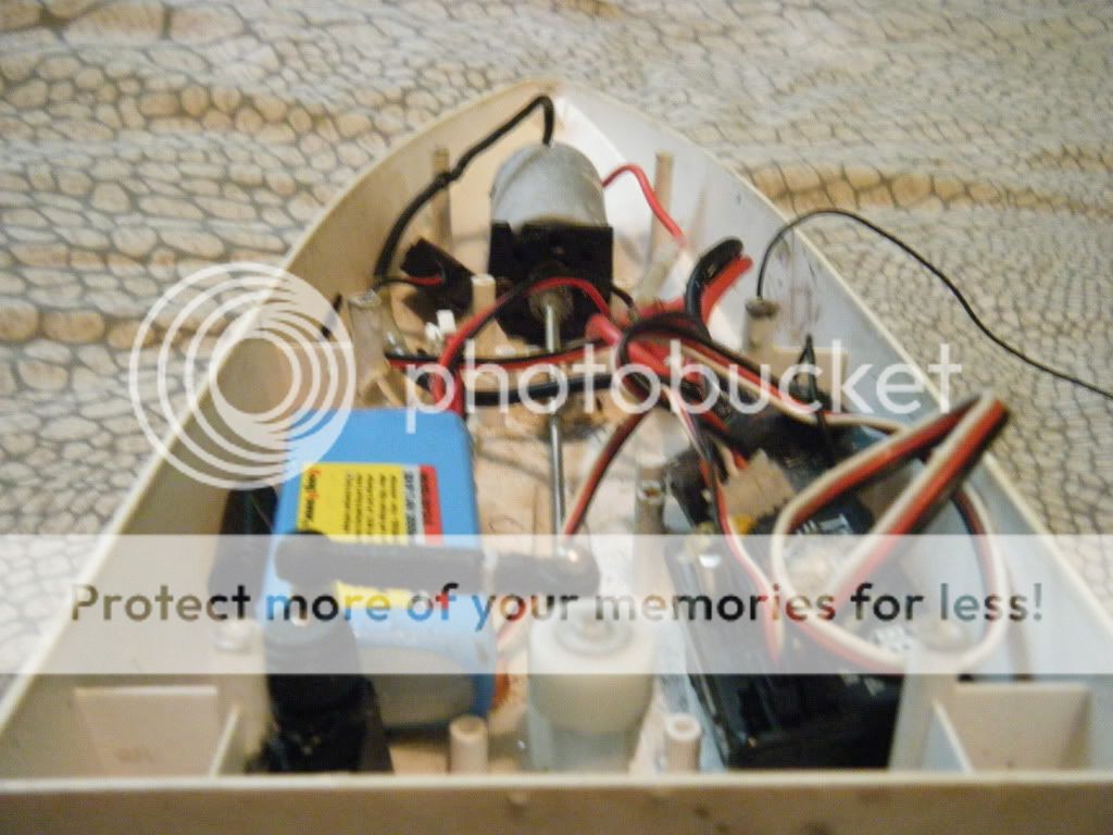

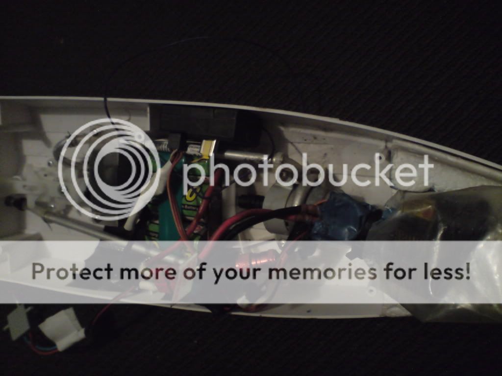

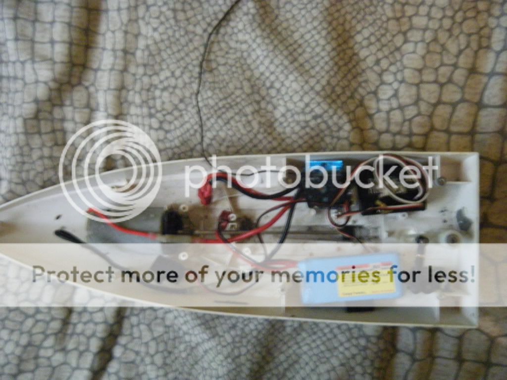

thanks for the comments heres the boat-
(apology's for the ordinary photos) [:@]
top shot-
stern? shot-
the beast of a motor and my homebrew shaft (jb weld,pinion and an old antenna)
the motor mount is off a tamiya drift car.
what she actually looks like complete-
size reference shot with the tq transmitter, pretty small-
and i found another old image of what it used to be-
what a mess -
