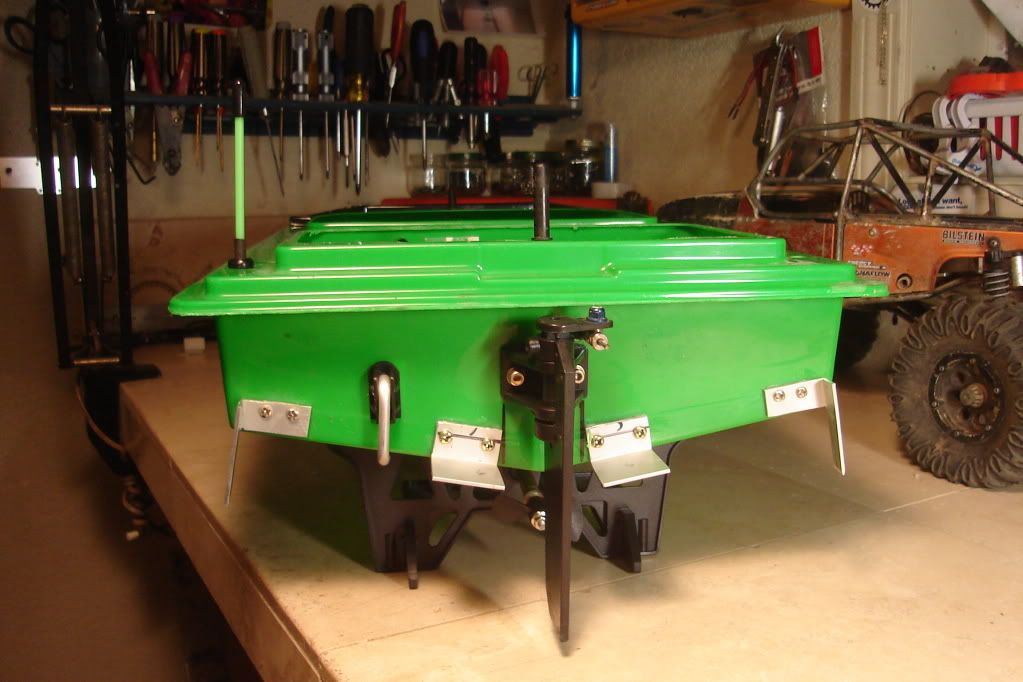

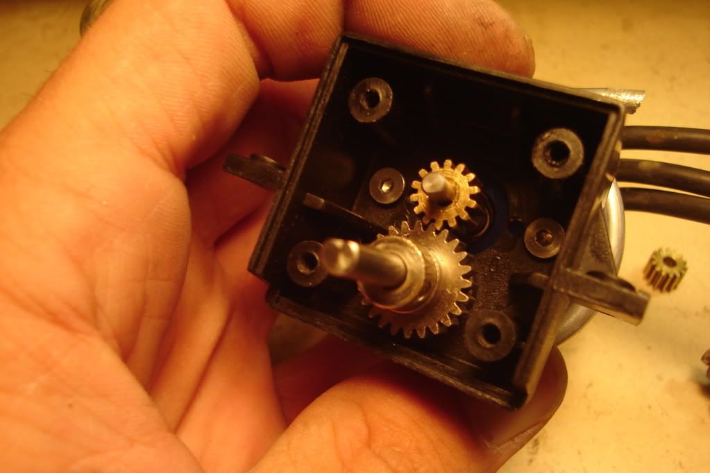

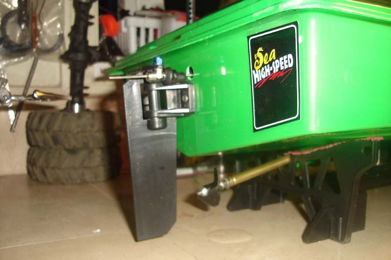

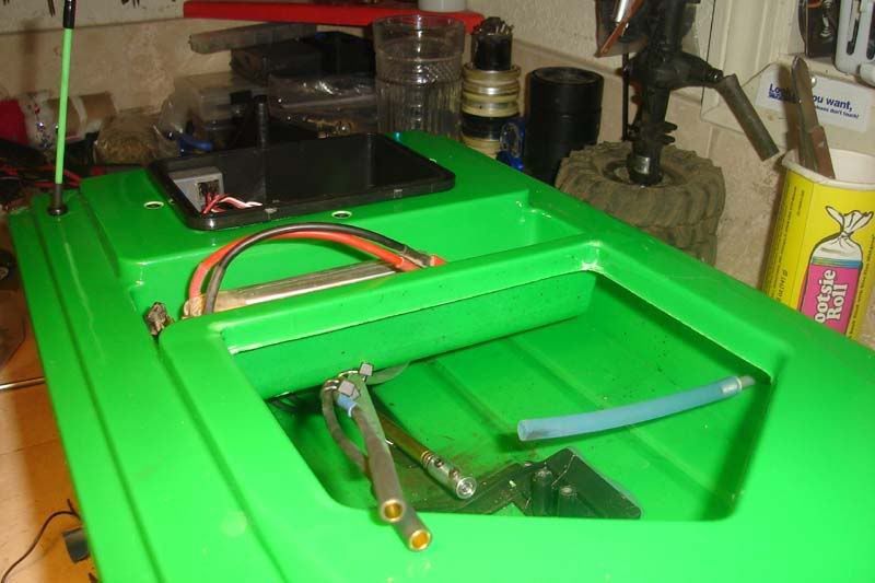

So I went out and ran it some more and encountered a few issues. First the pinion came off inside the gearbox and sent me swimming for it. While i was repairing that i figured i would swap the motor out for a 580 size I had lying around because the other would get pretty warm after a few minutes on the 3s. Back out on the water the boat was a beast. Speed jumped considerably and temps dropped on the motor and esc. Now another problem I'm having is with high speed stability. The boat is very twitchy and the rear wiggles around at speed. Now that its faster it has a hard time holding a turn without spinning out or skipping sideways. So I'm wondering is this an issue I could solve with trim tabs and turn fins? Also was wondering if someone knew or had a rough idea how the weight should be distributed in a boat or this size and style? wondering about my COG After some reading around these all sounded like they might help me. I will try and throw up a video tomorrow so you can see exactly what I'm talking about. Here are a few pics of the boat.
You may think I'm crazy, but I would try it without the gearbox. That bigger motor looks like it's too much for that gearbox. You would only need to reverse the rotation of the motor and make some motor mounts. As for your spin-out problem, try a turn fin . You need to make sure the fin is at 90* to the bottom of the boat and not parallel to the boat's side

Nice pics. The more info available the better to help you out. Go with Hydro Junkies advice....lose the gearbox. Weight and COG is going to be trial and error if no one else has modded this boat. Realize this also....the faster you make it go, the more unstable itmight become.

Thanks for all the info guys. Today I finally gernaded the gearbox altogether so it got tossed in the garbage. I built a mount and turned a new coupler on the lathe as the two shaft sizes no longer matched. Its all in back together now waiting to go back out in the morning. As far as the high speed stability what can i do to give the boat a more locked in feel? Or am i fighting a loosing battle there. IO have also added a turn fin into the mix but have yet to have tested. I will let you guys know how It turns out. This is a fun learning process so far.

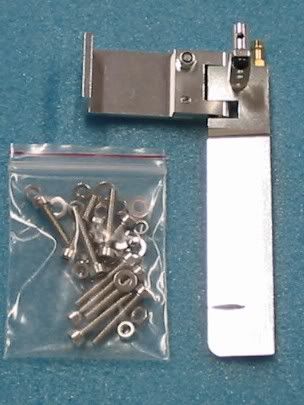

The turn fin should help a little trim tabs too. With a submerged drive at high speed and the shallow vee hull it's going to be a hand full.

along with this flex couplerhttp://www.offshoreelectrics.com/proddetail.php?prod=grp-3344. Between those pieces i should be able to make it happen. But with the flex coupler I'm thinking I will need to secure the end of the prop tube. Is this correct? I was also wondering what would the effects of raising the end of the tube about 1/16" or so? I realize it will change my prop angle also but am not sure if it will cause poor handling or lifting?

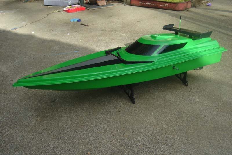

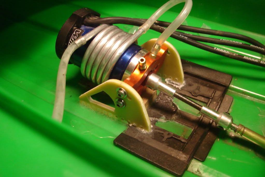

I got all my parts in and put on and wow what a difference. While I was at it I added a Velineon I had spare at the moment. I have been reading and researching a lot about different handling characteristics and hull setup. COG was way off for this or any boat for that matter. Ive been playing with balancing it at around 30%-32%. With the turn fins on both side and a pair of trim tabs toward the center of the transom the hull is glued to the water now. All hopping and porpoising is now dialed out. We ran it on the river today and bested 26mph up river and a few passes down at 31
. Its pretty amazing now to watch fly by (for a novice boater). I have a new lower kv motor coming and a ton of props to play with from OSE. I'm also thinking of changing out the rudder to a better quality alum. unit with a water p/u and fill the hole in the transom. Any recommendations? I am thinking of this 3" one from Kintech

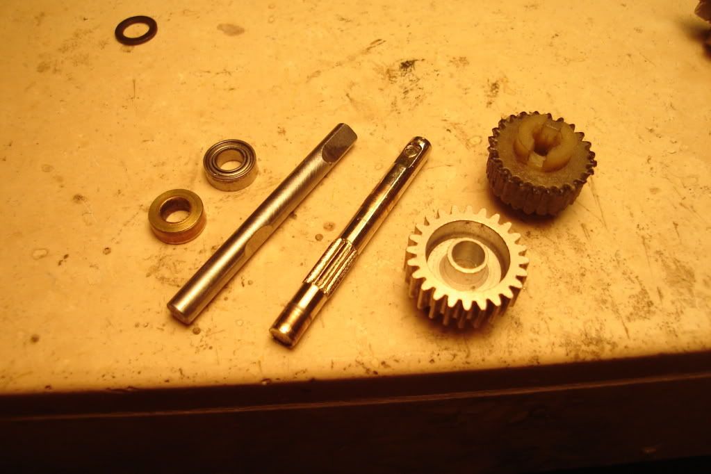

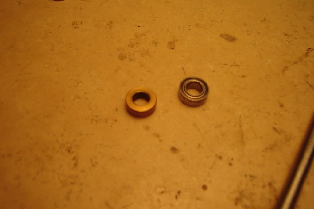

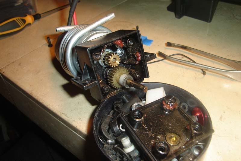

One of my good buddies got a cheap deal on this same boat. He blew out the tranny in his even faster than me. He didn't want to drop more money into it as he just bought a new ul1 also. I decided to see if there was a way to fix up the tranny to make it a little stronger and live for a while
. Everything about it stock brings the suck pretty bad. The shaft is bowed and midsized, the gears are plastic, and all this rides in egg shaped bushings. My solution was to scrap everything but the case
This shows the parts new and old.
I turned down a piece of stainless stock to 4mm and put on a couple flats. Next I found some gears that are the same size, pitch, and count. Pretty easy they were maxx gears i think. I bored one out to fit on the new shaft and key to the flat spot. Next were those darn bushings. I kept feeling like I had a bearing of this size somewhere???? I looked around in my parts forever and found them. They are the exact size of a Losi mini t bearing for the front wheels.
So with that find I pressed them into the case and had all my new parts. I figured with all reliable pieces on the inside i would beef the case a little also in case it wanted to flex under heavy load.The case is held together with screws threaded into weak pegs. I drilled them to 1/8" and through the back of the case. I used long 3mm stainless screws with nuts on the back to squeeze it all together and keep it there. This setup will also give him the option of different ratios. If he was to run a 19 to 19 he could have a 1:1 drive with the stock case. Would be a good mod for anyone else that might buy this boat

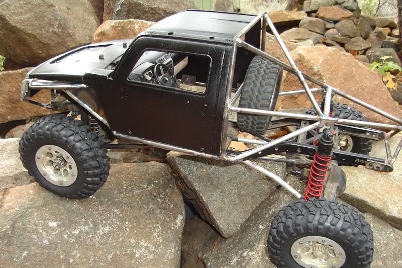

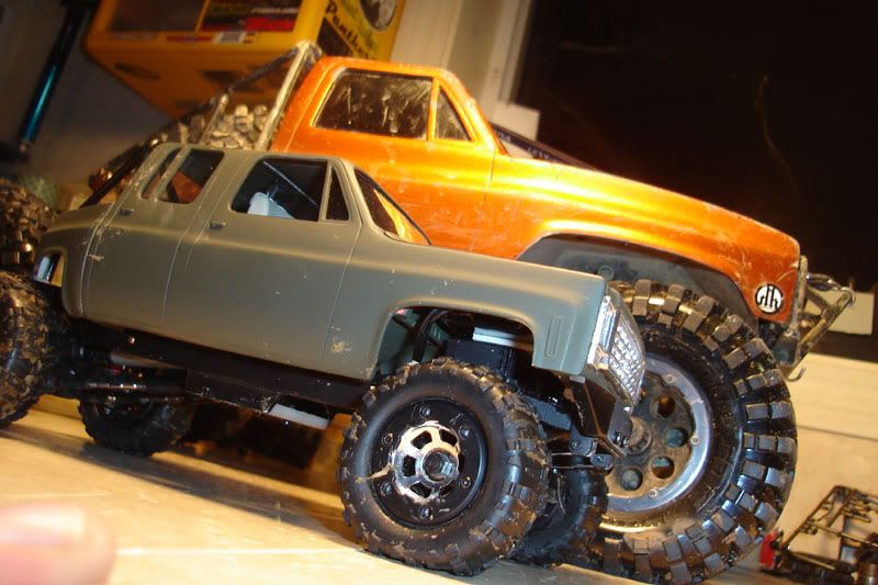

Here area couple of my other land based projects
