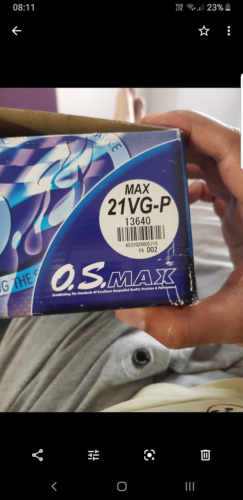

Hi all new to the forum...and hoping I can find a soul out there that can advise on replacing the engine on an inferno MP6. Totally appreciate that it's very old and will be a little fiddly to do. I did order an OS.21 engine from ebay with mounts however these did not fit all, fortunately the seller was very accommodating so managed to return it. Any advise is greatly appreciated, I have tried searching the forum but not been able to get clear direction with this. If anyone can help please message me. I can post post pictures if needed. Thank you, Hiren.

should be any big block be able to fit, was the O.S. engine that you had purchased an O.S. .21TM by any chance? the .21TM is what is considered a small block, though its displacement is of the "big block" category, the actual crankcase size is that of a small block.
do you still have the old engine? maybe post a picture of that. (you will need 10 posts in total to post pictures though).
if it wasnt a .21TM, what engine was it? and what/how was it not mounting correctly?

Thank you so much for the reply. The new engine i bought was called " MAX 21 VG-P"(picture of the box attached. The issue centres around the mounting holes in the engine, the old engine as the front 2 closer together than the back. I have included pictures of the hold engine. Any help greatly appreciated.
Regards Hiren.

ahh i see, yeah forget that Kyosho did those type of mounts back in the day.
check this out, they dont have any in stock but give engine models that have that same mount type.
RC Car and Truck Nitro Engines
is the engine just low compression? or other internal issues? might be able to send it out to get re-pinched, (i hear good things about Rayaracing.com, and RW-mods.com
sorry not much help on a new engine.
another option but definitely at your own risk, would be to get a different engine mount from another buggy and drill holes in the chassis to mount the other mounts too.
maybe something like a Kyosho MP7 engine mount? just a thought.
