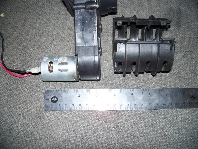

The stock motors are just cheap 540 cans-I would think even a 1/8 brushless would move them pretty good.
Having played with more than one power wheels, though, I'd say the body is about the only useful part for an RC application. No suspension, and no solid way to really mount stressed parts. I'm planning to build aluminum suspension chassis for these ones, and to make them 4 wheel drive using another gear box assembly, some HF1012 one way bearings and 1/4" drive extensions & universal joints.

probly is 540 in the smaller wheels. in larger power wheels, its more like a 700. If a titan 775 can be made to fit, that will up the torque a bit.

Drive unit for the 'lil Wrangler:
The 'lil Wrangler uses only one of these drive units on 6V, but the larger 2-seaters use duals on 12V. The spare unit pictured I bought to do the 4x4 conversion.
Small as they may be, on the 3S LiPo, it was enough to startle my kids. Top speed probably only 5-6 MPH, but with the LiPo discharge, it's right now, especially with a non-differentiated solid rod rear axle and the screws I ran into the wheels to give them traction on dirt. That's why I want to retrofit a variable throttle system.
