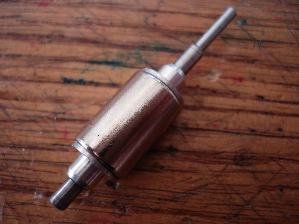

Here is the thing to do.
Can you turn the shaft in a complete rotation or two when the motor is unpowered?
If so, the coil is damaged. Fixing this isn't worth the cost, just get a new motor.
If the shaft cannot be forced into making a full rotation, your rotor is damaged. You can likely open the motor up, remove the rotor and any debris, get a new rotor, and you should be good to go. Unless the rotor breaking caused some additional internal damage. If you do have an ohm-meter, check each coil like the guy did earlier up the thread before taking it apart.
And the one way to prevent these mishaps is to not run the motor too hot, ie. > 200F. Sometimes you may need to replace a bearing instead of (or in addition to) the rotor.

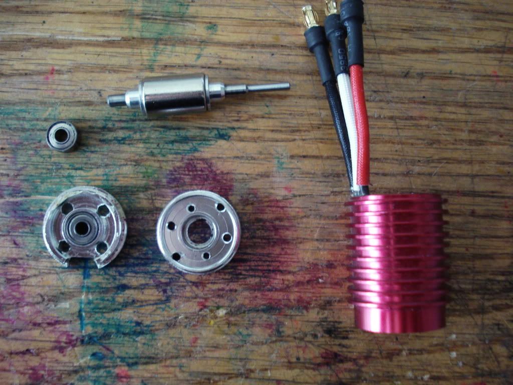

i can turn the motor fine
and when i open it up its clean
rotor is not cracked or over heated
i'll post pics later ,..

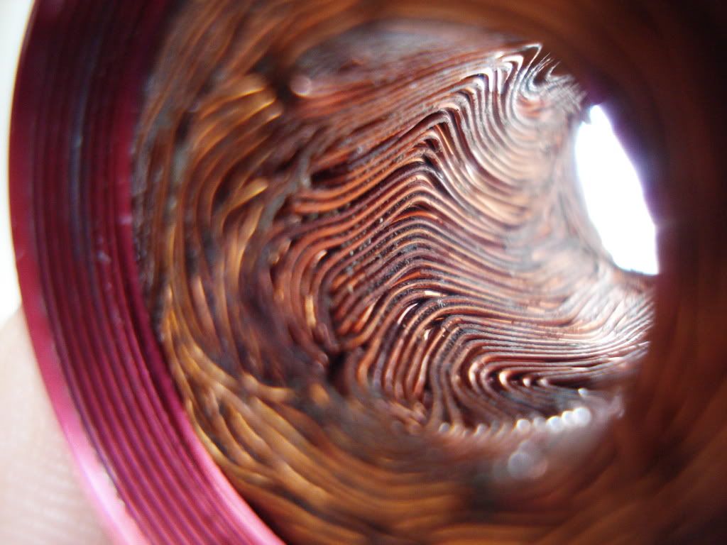

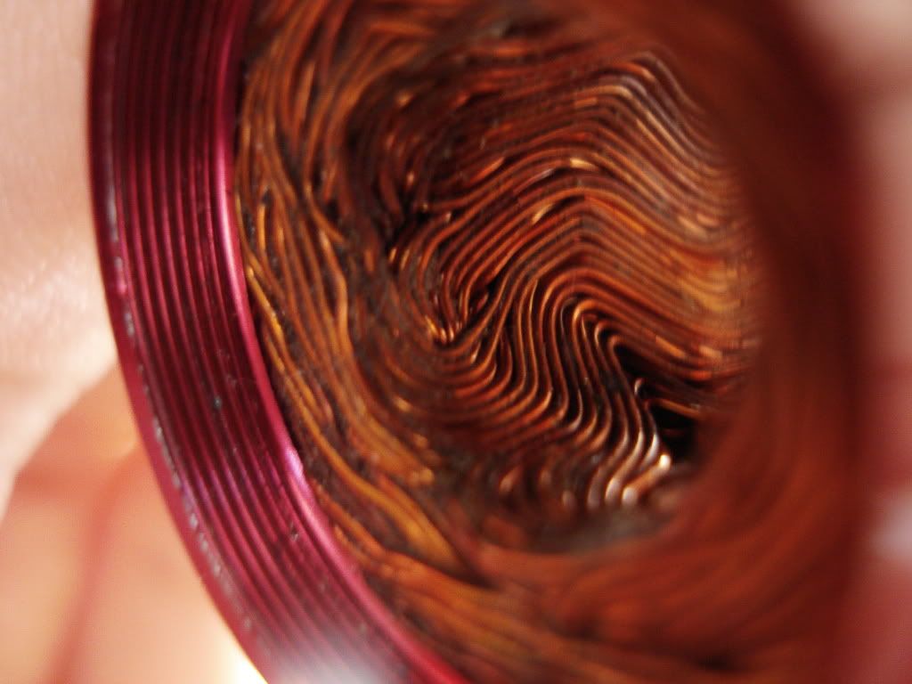

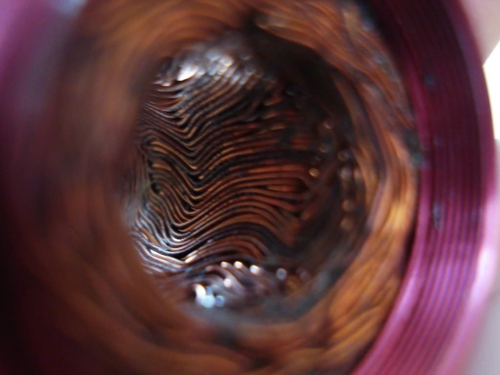

Join Date: Oct 2007
Location: , CA
Posts: 361
pics
http://i159.photobucket.com/albums/t...g?t=1248659324
http://i159.photobucket.com/albums/t...g?t=1248659332
http://i159.photobucket.com/albums/t...g?t=1248659341
http://i159.photobucket.com/albums/t...g?t=1248659351
http://i159.photobucket.com/albums/t...g?t=1248659360
one thing i dont get is
why can all the copper wires INSIDE the can touch each other BUT NEVER SHORT?
is there some clear coat of paint or sumthing on it ?

The wires have a special coating on them so they dont short out. In one of the pics it looked like there were some blackened windings. There is more than like likely a good chance it got just hot enough to burn away some of the epoxy and short some windings.
Yes definitely your windings are shorted out. The coating looks charred in some spots. With cheaper materials your motor is more likely to "smoke" as the electronics world calls it. (even if there is no smoke)
Join Date: Oct 2007
Location: , CA
Posts: 361
well its not broken anymore
i took it apart and resoldered the plugs and now it works fine ,,
and the
ohm reading are the same as the other motor
lol
and the
lol
