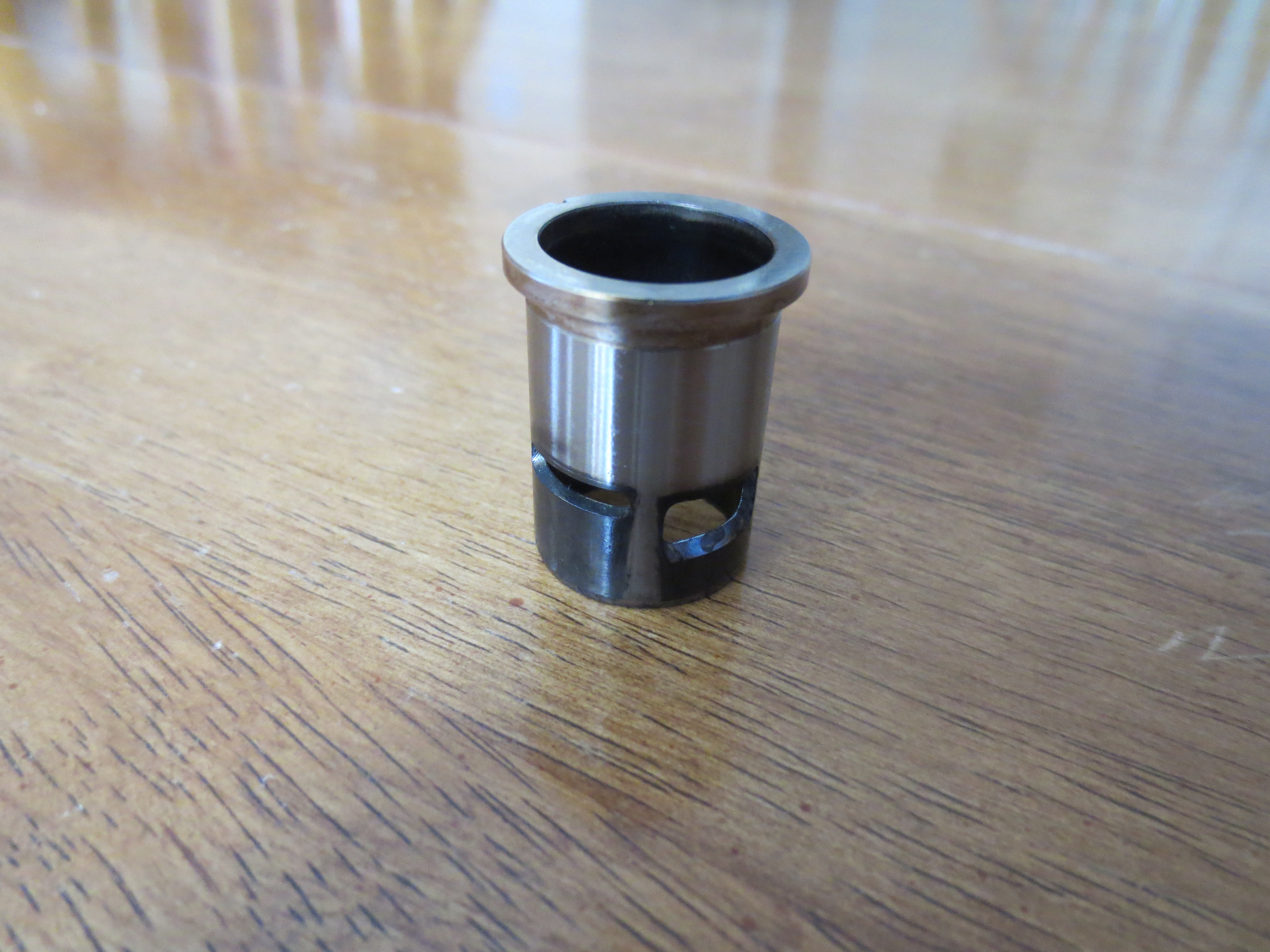

You got any pictures of this black sleeve? The only time I've seen or heard of an engine wearing out in less than a gallon is if it was ran too lean and overheated a bunch. Too rich and the engine takes forever to break in. Most RTR engines aren't machined very tightly so they tend not to be real "pinchy" and thus rich running doesn't bother them too much. Poor quality fuel can aggravate a poor tune. What fuel and glow plugs do you use? Fuel with too little oil or poor quality oil will not lubricate well enough and can cause erratic running and excessive heat. Also, different fuels have different oils in them and as such each fuel will smoke differently. Fuels with all synthetic oil tend to burn more gray and fuels with castor oil in them tend to burn more blue (smoke color). Just because you had a lot of smoke doesn't mean the engine was running properly with adequate lubrication. I'd highly suggest finding out what oil is in your fuel and if all synthetic, add some castor oil to your fuel. Adding 6oz of oil to a full or nearly full gallon of fuel will raise your oil content by 3-4%. I'm a big advocate for running extra oil for break-in - to the tune of 16-20% oil. After a dozen tanks or so, switch to a normal running fuel with about 11-12% oil works well for me. A quart bottle of airplane fuel would fit the bill nicely. It's messier, but the engines last much much longer. I run SH based engines, Traxxas, and a few HPI engines which all are known for being "cheapies" and having inherent flaws, but they all run and run. I tried "race" blends - 30% nitro 8% oil in the cheapies and didn't like the results. The crankcase was bone dry inside at the end of the day when set to a nice clean running tune. Using 11-12% oil left some oil inside. If you use some castor in your fuel, you don't really need to use any after run oil as the castor has a chemical affinity for metal and sticks to metal like no other oil available on the market.

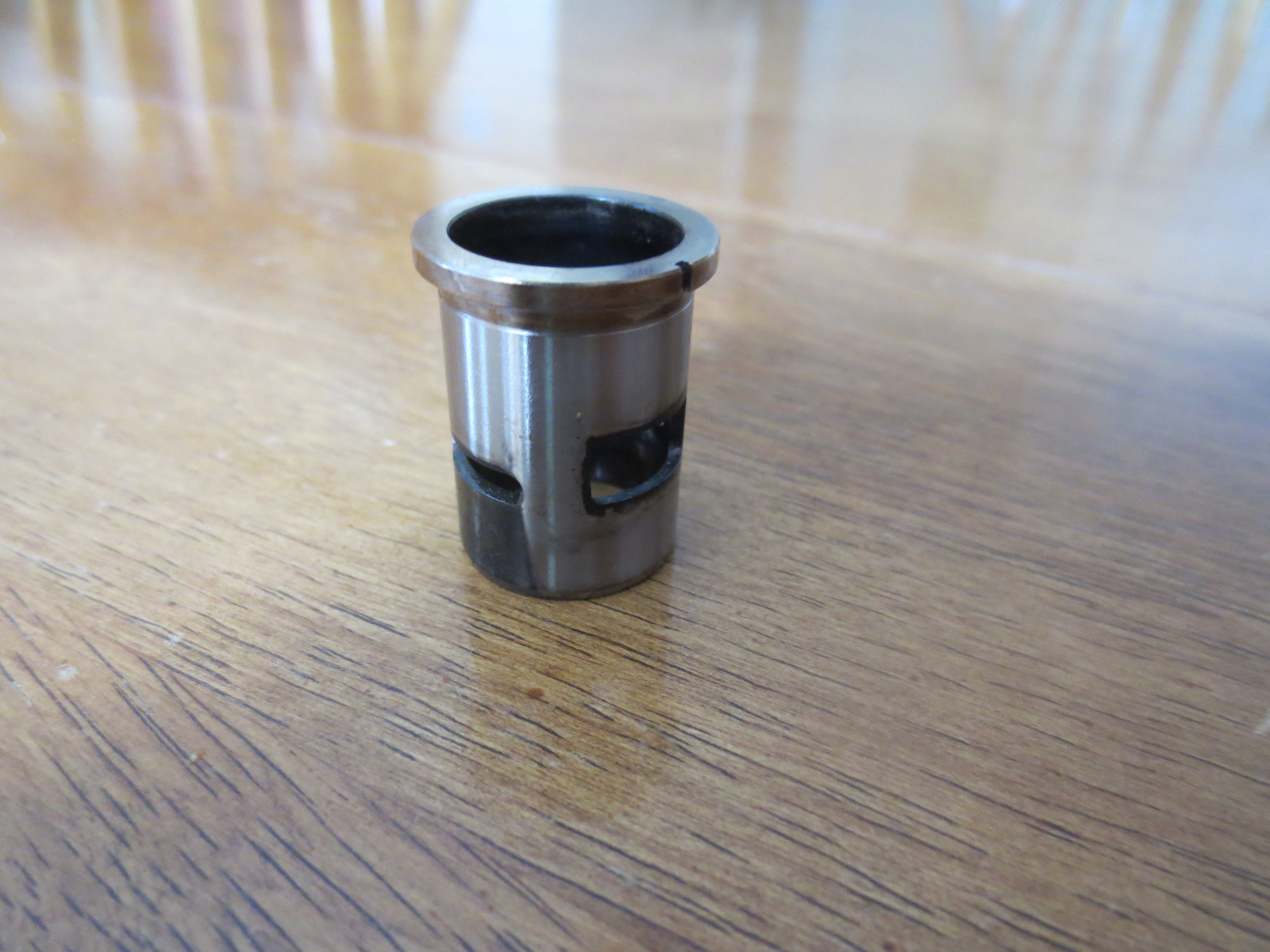

krokodyl 10-10-2015 10:17 AM
gphoto2://[usb:001,003]/DCIM/127___10/IMG_3636.JPG
gphoto2://[usb:001,003]/DCIM/127___10/IMG_3637.JPG
Here are some pictures. I am using byron gen 2 race fuel. Its 20 percent nitro and 12 percent oil. The smoke apears to be white not blue.

1QwkSport2.5r 10-10-2015 12:01 PM
It could be the lighting, but that liner looks like it's nickel plated and not chromed. Is the whole liner inside and out all the same color metal (except for the black areas)? The areas that are black is a little darker than normal, but regardless, those are stains from the fuel. The fuel is corrosive and etches the liner a little bit.
krokodyl 10-10-2015 12:06 PM
Yes the inside looks ok. However now i have another issue. I took the starter plate off to see if every thing is ok there and pushed the hex in since it came out a bit. Now i cant turn the hex at all. This means i cant test the engine. I now have 2 problems. :-(
