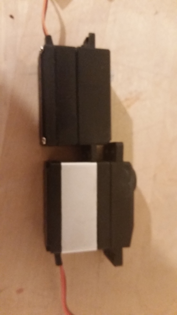

Menaceofri 08-13-2016 10:41 AM
1 Attachment(s)
width they are the same however height are different here is apicture comparing the two. the servo can fit between the two posts and lines up properly for the screwshowever the new one is too short. http://www.rcuniverse.com/forum/atta...mentid=2176736
was thinking i could shave the post off a littlebit on the wire side so that it could fit, dont know if that is a good thing to do or not, does it really affect the servo even if i switch to a longer one or anything as long as it still screws in and all that?
sorry i dont have anything to measure themwith, but you can see from the picture it is easilly a third of an inch taller than the new one. and that third of the inch is why the wiring from my new one comes out still on top of the block the servo screws into on the chasis.
RustyUs 08-13-2016 01:53 PM
Looks like a low profile servo you got there. I don't know what the servo looks like inside, or what kind of tools you have. So the simplest solution is to get a standard size servo. Servo mounts come in all shapes and sizes as well. That would be another possibility. Some are made of plastic, and some are aluminum. Finding which one would work the best for your servo...that's a different story. Lastly, get out a Dremel tool and start hacking away until the servo wires clear the mount (just don't mess with the side of the mounts that attach to the chassis).
RustyUs 08-13-2016 02:17 PM
I know the Amp's servo mounts probably have a little "indentation" on the bottom where they mate up with the chassis' raised area. If worst comes to worst, grind the chassis' bumps (where the servo mounts align with) and maybe use something like this: http://www3.omnimodels.com/cgi-bin/w...I=ASCC6337&P=7
I'm sure you can find something similar in black, and easier on the eyes, but the servo mounts linked above was the first ones that come to mind. I know, they are so old school. Right? Simple, yet effective though.
With Dr. Emel (dremel) and a little ingenuity, good things can happen. I'd probably start with trimming the stock servo mounts and see where that gets you. You only need to trim a few millimeters off to allow the servo's wires to pass the servo mount.
