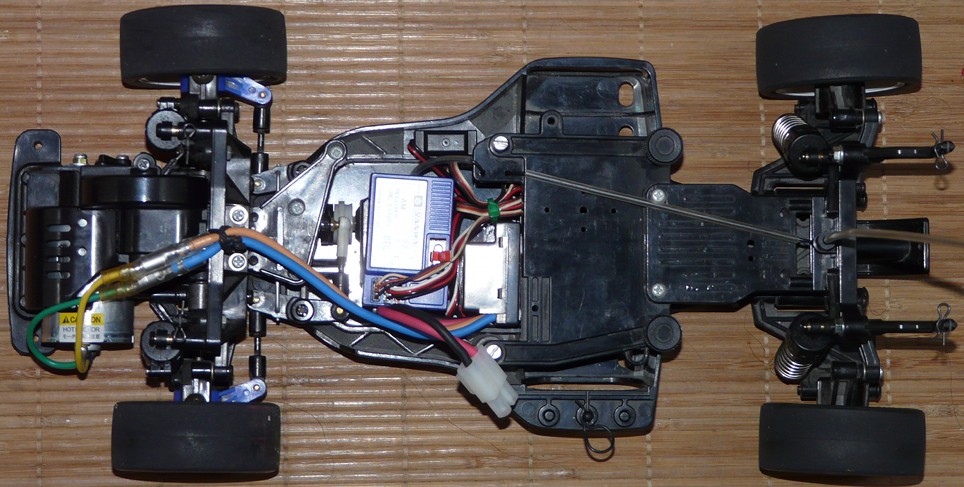

I'm new to the RC car world. I bought a chasis from somone a long time ago and never follow through building it. I forgot all the spec and do not even know where to begin. I would love to build this RC and give to my son. I can take more picture if needed. I do not even know where to begin.

It looks like it could have been a Tamiya car kit. Not sure which one.

Looks like some carbon fiber plates on there, Good start !
And do the build, Your son will love it !

After further research (thank Brian for the lead), i believe it may be a FF01 chasis from Tamiya. This may be a stupid quest, but what do i need

Heres a pic of a FF-01 that pretty much shows the components where they sit.
Attachment 2248135
What you need....
An " ESC" electronic speed control, Brushed motor, Steering servo, receiver & transmitter,
