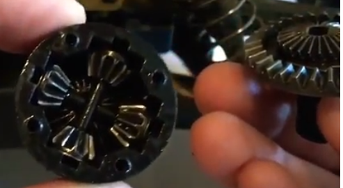

Sorry. some of the cars. Cheetah by JLB.
I read last noght after the post and found a few topics here via outside search engine. Looking to just put in grease and place on oil. not doing this for professional stuff... a simple grab the car go out to the paved street and lap back and fourth no bashing just back and fourth runs.
I will have to read the Online pdf (read it) manual, the diffs and 4 wheel shaft all get "grease" nothing of weight was said.
1So more or less all I am looking to do is lube for general maintenance the gears. it has been way to long to remember from the years I been as a kid. why I asked. for some advice.
Jlb cheetah looking to lube the revolving parts? Hope my questions was not to off in ways. back and fourth easy passes no bashing no racing just relaxing stuff.

I just looked up the manual for your car and I confirmed that it has a sealed diff:
https://jlbracing.en.made-in-china.c...AGE-SEVEN.html
Personally I would used diff fluid just to play it safe and ensure your gears are properly lubricated and offer some level of tuning to make your car easier to drive.
You can use any automotive grease, I like to use Green Grease brand for all my rubber seals to prevent leaky shocks/diffs, but using the same grease on the planetary gears (as the manual shows) will let your car "diff out" and feel very inconsistent (twitchy) in corners. Grease will be more likely to gum up with debris and cause your gears to wear out more quickly.

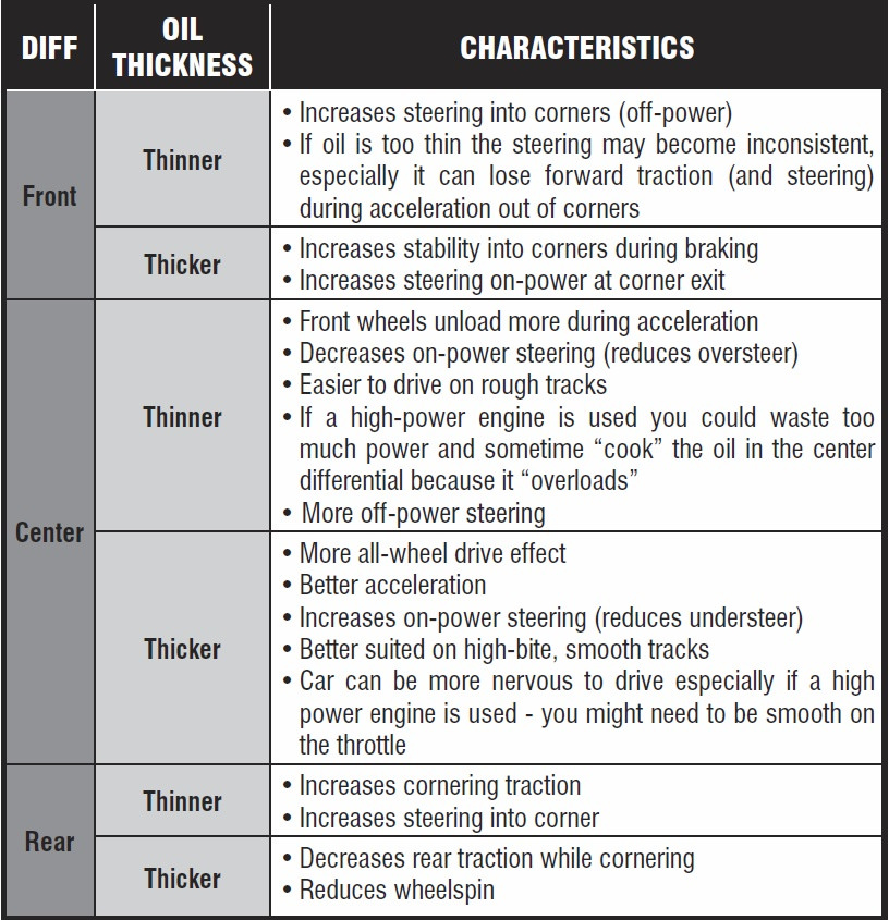

For a Monster Truck I would go with 15K Front, 15K middle and 10K rear fluids in your diffs to start out with and then use this guide here to make any adjustments if desired:
https://ptrcracing.com/product-category/diff-oil/
