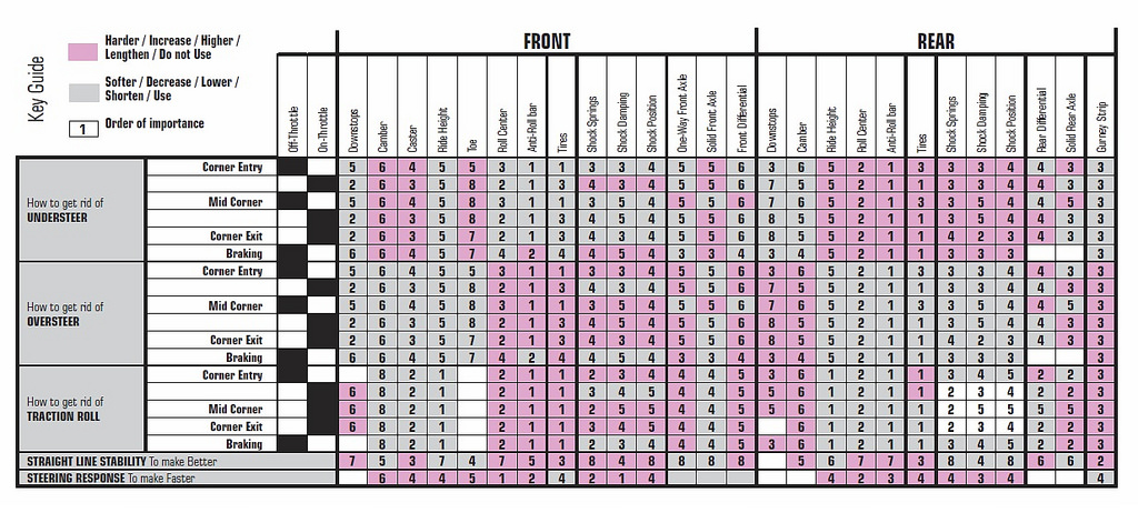

What specific car are you trying to tune?
It would be a lot easier to start with a baseline setup for your given track condition and then make minor tuning changes from there. To get rid of "traction roll" there is a really nice chart provided by Hudy which shows you the priority of changes you should make... once you've maxed out a given option for your car, then go down to the next item in the list until you get the car working as desired.
Keep in mind that there is always a give and take.... for example tuning out traction roll tends to take away steering so you might discover that the car can't make as tight as turns as it used to, but with the benefit of not traction rolling.
Attachment 2260175

bill_delong 04-24-2018 04:46 AM
Originally Posted by phmaximus (Post 12425893)
...if needed you can use nitro fuel line under the shocks piston to limit the shocks range.
This is a really nice trick for many 2WD cars which don't have droop tabs, but most 4WD cars already include this tuning option, so be sure to only go this route as a last resort. I also favor using plastic spacers instead of cutting fuel tubing because it's difficult to cut perfectly equal lengths which is very important for consistency. In contrast, most of my car setups have me extending my droop by backing out the shock ball ends a few turns.
Traction roll is typically mitigated with ride height, which was listed as the #1 priority adjustment in the chart I linked earlier. These guys should start with a good baseline setup before blindly making any other tuning changes, they could have their cars so far out of whack they could easily create bigger problems elsewhere. It's better to start in the center of the tuning window rather than in a far corner which will drastically limit your options :(
