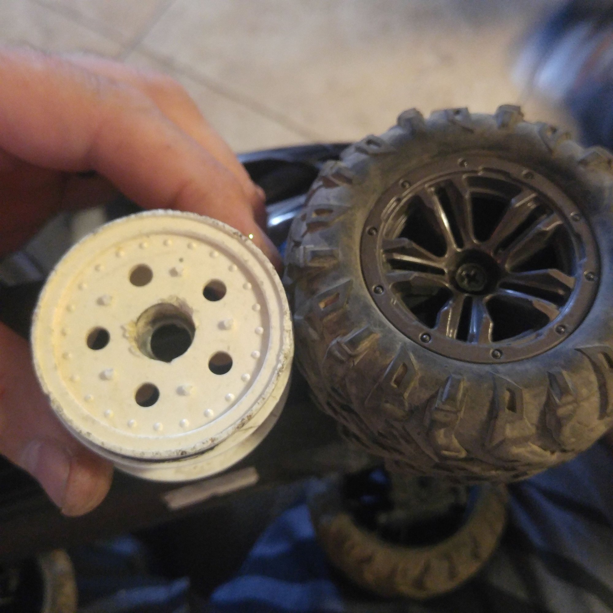

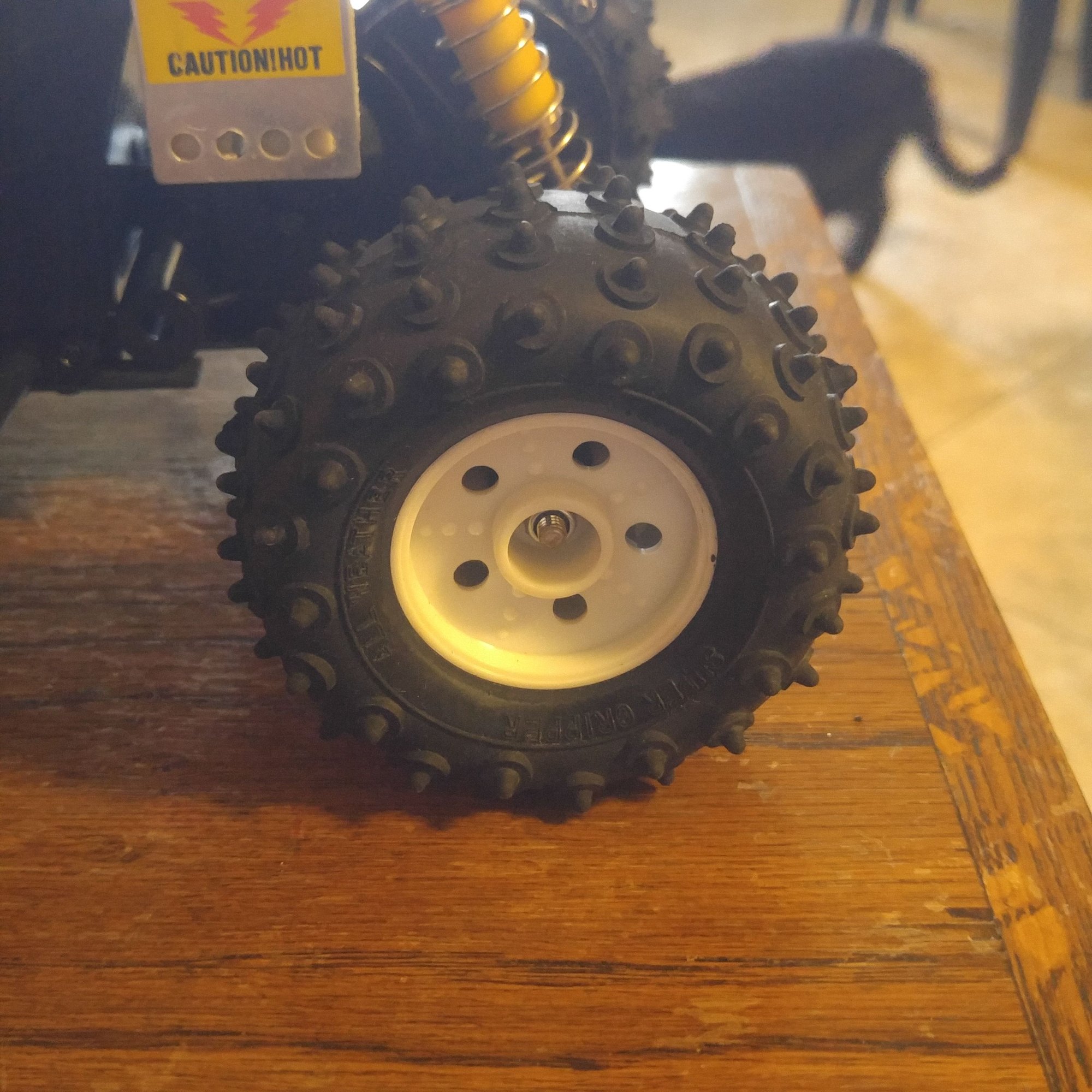

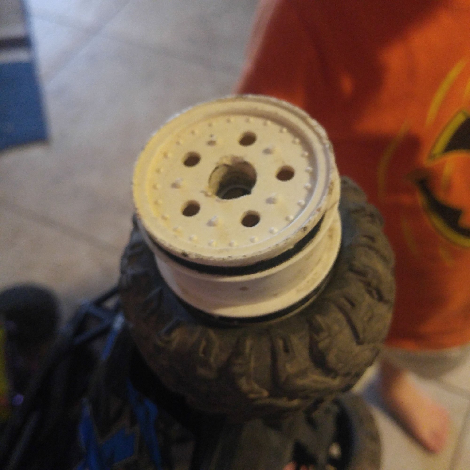

The Tamiya tires fit perfect and look good too, going to be crossing the finish line soon on the restoration. The tires do not fit the Golden Arrow wheels however, the GA wheels are the same size as whats on my kids Remo 1/16 truck. I may try them if I can get the truck away from him. Top two pics are of the GA wheels and last pic is The Cat with Tamiya tires.
