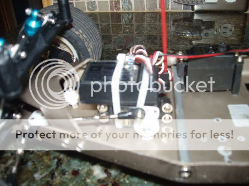

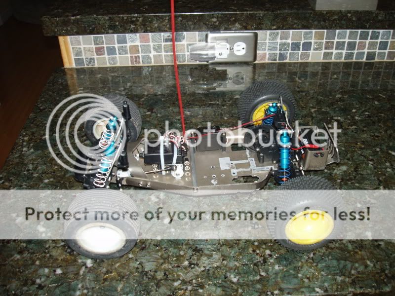

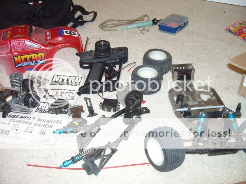

yesturday, i forgot to post this up so here it goes, my nitro hawk build, stay tuned for updates tonight or tomorrow
scuff-tastic!
TRX .12 wow what a rustic style engine
still not sure how im going to approch this, the tranny was in tip top shape (uses srt, eagle, pede rusty bandit gears), and really despite the dirt everything was in pretty good shape, even the bushings were almost wear free! i do plan on dropping in all n-rusty stuff like hub carriers and front axles along with mip cvds and a few other things besides. i may or may not drop in a nitro rustler tranny since with the stocker and a new engine it wont have breaks (who needs them anyway) also for the body im thinking muscle but still undecided, if you think of a good body that fits this car post it up!
im going to soak everything in my super secret mix of tide and hot water tomorrow and see if i cant get through the thicker layers of grime...
today
the bath worked great, scrubed ttt every ttt single ttt part ttt and ttt screw
this thing has been a pain to build, took close to half the day to get this far and i have not even got to breaking down the shocks or cracking open the engine. i did get the steering done, the tranny is done and in great shape. i need stuff though, screws, bearings, and an mip cvd part (all i need is one stupid peice to get them assembled) got the nitro rustler front knuckles and carriers dropped in place of the old 1932 and 1637 style assembly (along with the propper length hinge pin and some new e-clips)
anyway heres pics
im waiting on dropping in the tranny till i can either get the TRX .12 to run again or till i get an n-rusty tranny dropped in its place

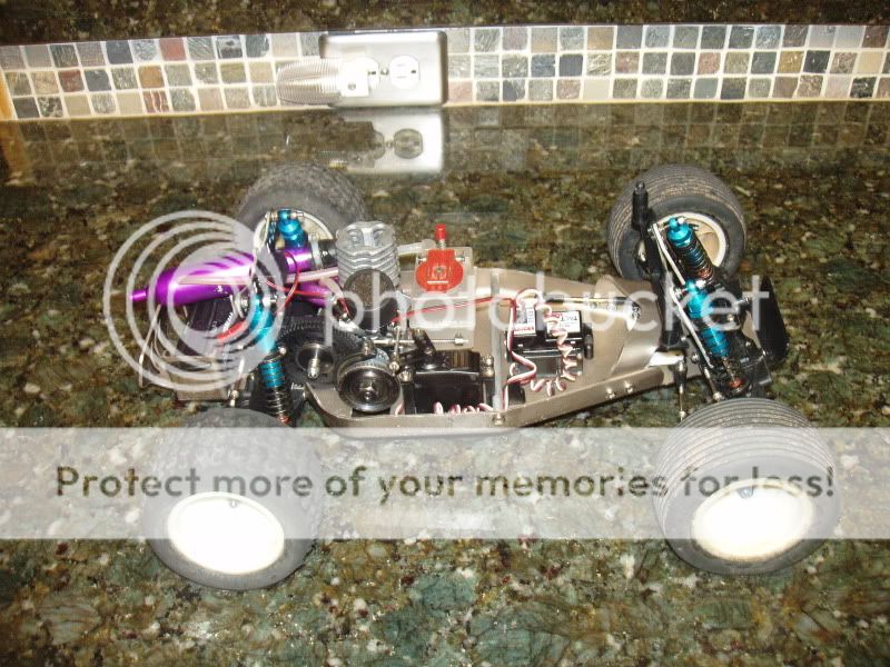

got the tank mounted after i got back from the track and a buddy loaned me his O.S. CV-R .12 so i tried fitting the engine, not good, maybe if i dropped in a tigerdrive and or went with a newer trx.15 with the longer shaft.
this build has really been kicking my butt, took a good hour to just mount the rear shocks. the whole rear end was missing all the screws and a bunch of stuff besides.
il get pics up in a bit, tired from holding my dx2.0 all day, its hard to be a racer
also, i think im going to mount a hpi ford (ewww) bronco body, i think it will look pretty fly

well i got bored while cleaning my rs4mt so i decided to tackle the engine on this bugger and it seems that all is not lost, the bearings, depite the surface rust, seem to roll good enough but i will replace them regardless. the crank shaft is also rusty but not beyond serviceable. the piston and sleeve are also in pretty good shape, maybe if i could find a chemical that breaks up rust that isnt wd40 i might be able to get everything running.
ill update after i do some homework on which parts are compatible with the trx .15

yeah i know but than it would be a .15, i want to keep it a 12
cleaned everything and got all the grime and crap off the rod, case, everything! it has pretty good compresion. i even got the bearings completely cleaned and spinning smooth! and the carb as been broken down and cleaned completely as well.
pics

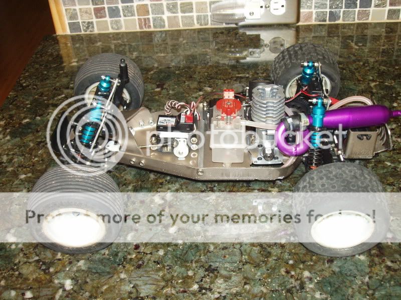

got the links mounted to factory specs now saturday im going to hand the whole car off to the nitro guru and see what he can do with it.
pics of completed car. all it needs now is all the stuff to start/run/maintain/and operate a nitro engine
