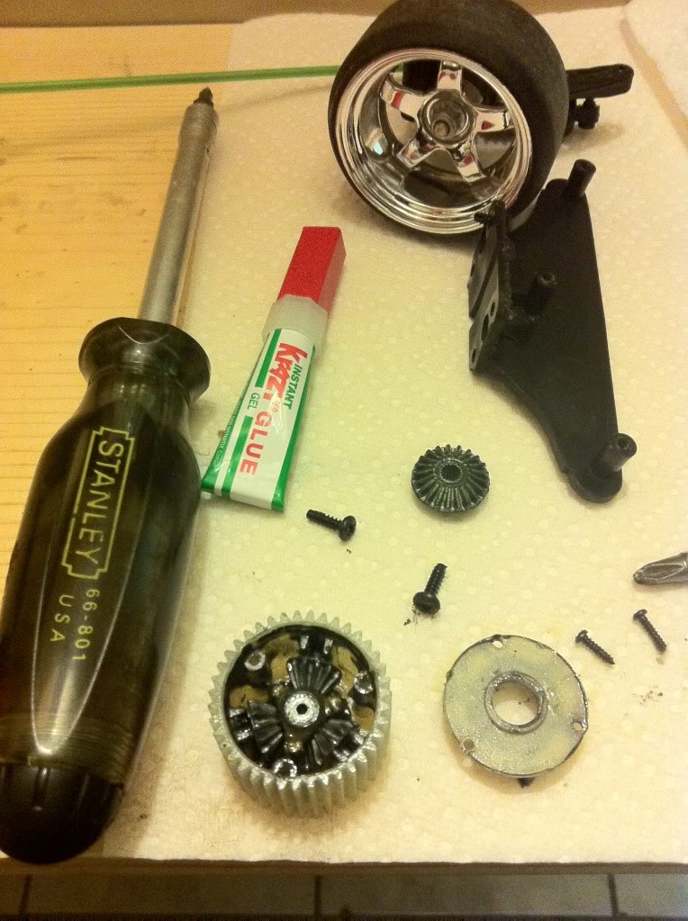

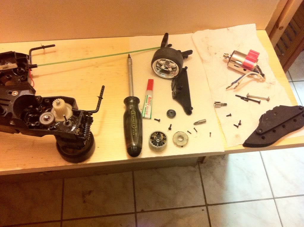

Just locked the rear diff on my tamiya tl-01 and man it made a big difference on the drift! heres some pictures!

keep an eye on it, eventually crazy glue will start to crack under the impact of on off throttle and you will have some play in there as the play gets bigger and bigger the gears grind away at the glue and pulverized it. I saw this happen to Sprint 2 diff and you were able to get a lot of movement at the wheels.
If you still have it open stick a more solid based glue like JB Weld.

Yeah I actually took it apart again and added JB weld to secure the lock.. But quick question for you guys, the rear diff works the way I want it to but I noticed in the front that the front right wheel has alot more power then the front left wheel?Like, I would pick up the car and rev it in the air and notice all the power is going directly to the right front wheel and the left front wheel is getting very little power.. And also, I can do a 360 easy if I hold full throttle while turning the wheels left and when I turn the wheels right and hit full throttle I get no 360 at all except the car drifting outwards left.. Any ideas?is my front diffs damaged?I never touched it at all yet? Please help, thanks!

Alright, so I took the car apart and found no problems what so ever. All gears and bearings look good. I inspected everything precisly and checked the groves on the gears and everything is all good. I still dont understand why one front wheel gets more power then the other.. I even lubricated the gears and everything to equal it out, still no normal results. Here are some pictures. Oh yeah, and after I did a test run, I burned the MSC haha.. Oh well, that isnt even meant to be used for drifting anyways.. Tell me what you think?

Disassembling the rear chassis is so easy to lock the rear diff!Theres even a video on youtube to give you a step by step idea on how to do it!
