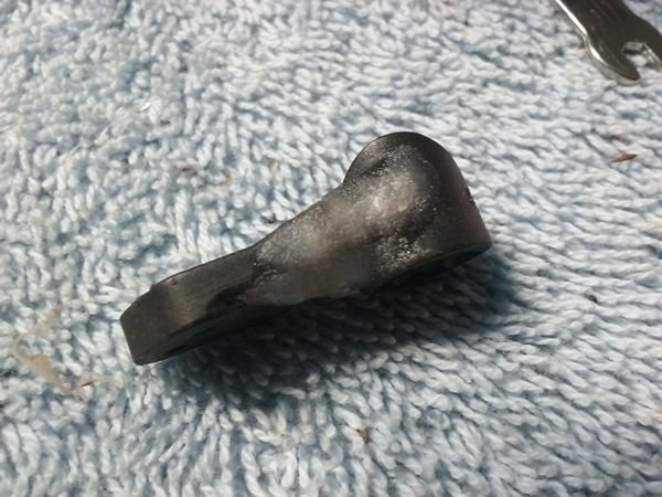

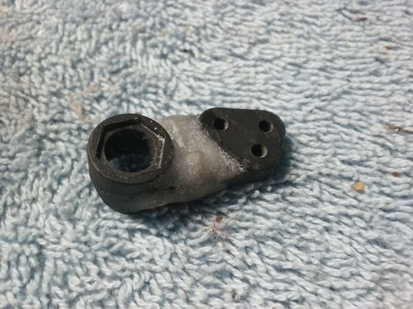

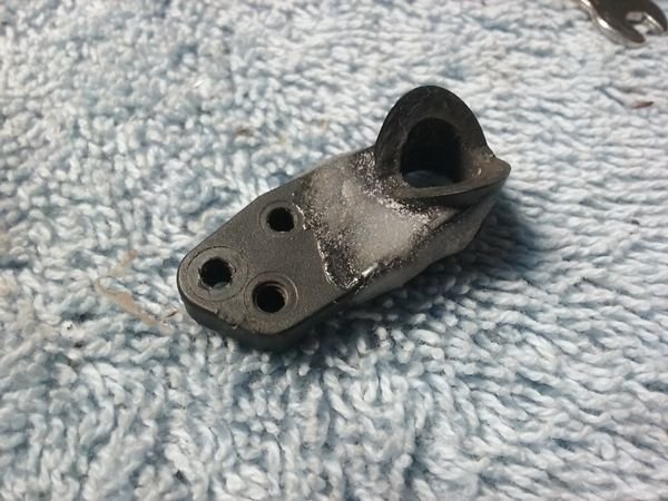

Default Repaired Lower Servo Saver Arm
Eventually I will put another layer on the top and sides of the arm. Stuff is rock hard. I can't remember ever using CA/baking soda filler on a longer piece, like the arm shown above, that needs to put leverage on something else.

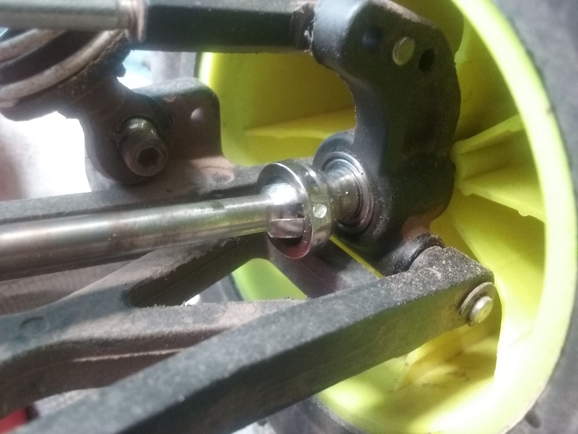

After about 17 runs, the CV joint's pin decided it had enough. I would have, more than likely, lost the bone if it were not for the chrome reflecting the sun into my eyes as it went flying.

Default CV Joint Pin
I now know why I have two tubes of 1.59mm tungsten carbide rod in my pit/parts box. I just couldn't remember what pin I was going to make out of the rod. Hopefully the stuff will last longer than what was used for the stock pin.
