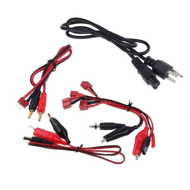

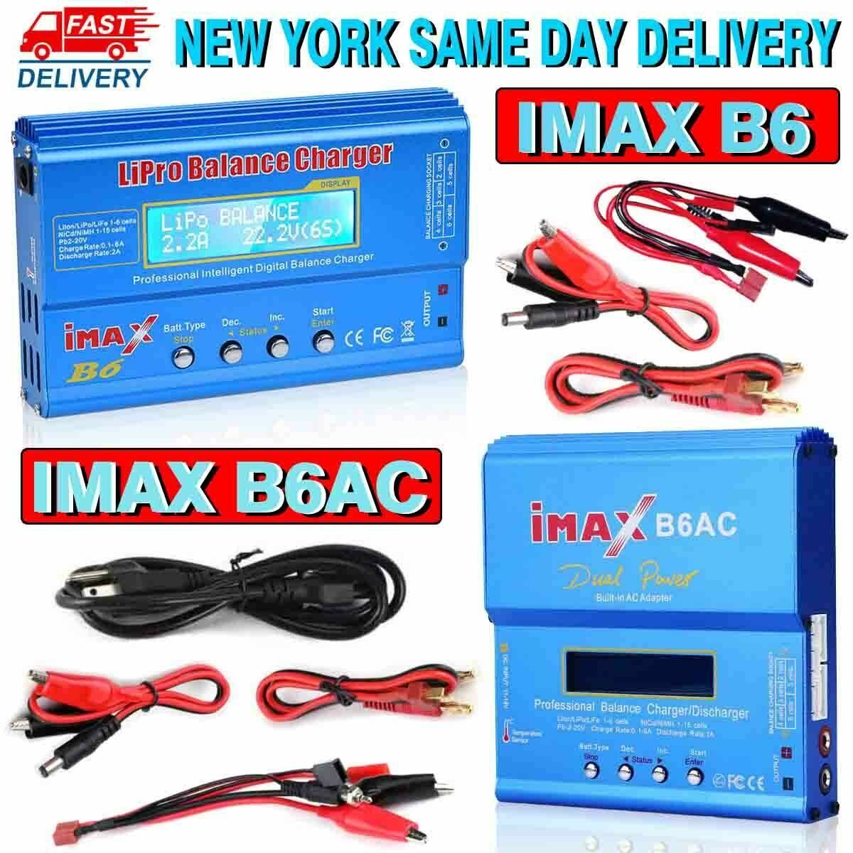

If you click on the product page for the IMAX B6AC , also note that the AC in the name indicates that it's an AC charger, the B6 version without AC in the name does not include the AC supply/adapter, here is one of the product pics showing the AC cord included:
Both versions of the charger:
