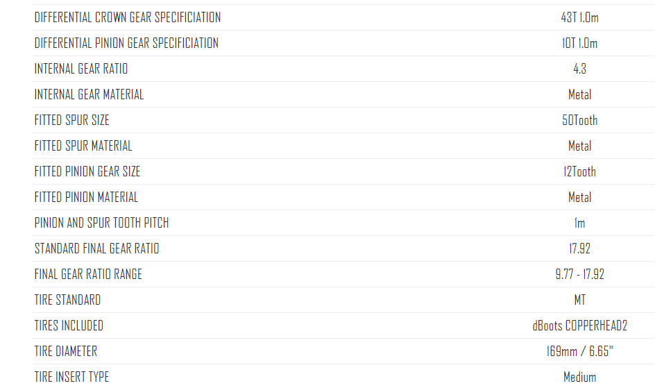

YIs the ex’s kraton roller. Is the spur gear a MOD 1,,,I’m looking for a pinion. Want to be sure before I order and what’s the difference between a32 pitch and A mod 1 are they the same,,,,some list the 32 pitch as a mod 1,,,,I’m confused,,,,thanks guys....

Mod 1 and 32P are not the same .
Mod .8 and 32P can be used together according to some . I dont have any Mod .8 or 32P so have never tried .
Personally , I would not mix them .
Is this a 1/10 4S or 1/8 6S Kraton ???
6S Mod 1
4S Mod .8

Arrma lists specs on their website for each and every platform they have... https://www.arrma-rc.com/exb/kraton/
From the web: "...Simplified, 48P, 32P, 0.8 mod, and 1.0 mod are measures of gear tooth size and are referenced to one inch or 25.4mm of pitch diameter. They express a ratio, with the P numbers being the numerator (top number) of the fraction and 25.4 being the denominator (bottom number) OR the mod values being the denominator and 25.4 being the numerator. So:
48P/25.4 = 0.5288m
32P/25.4 = 0.7938m
25.4/0.8m = 31.7653P (32P)
25.4/1.0m = 25.4P ..."
