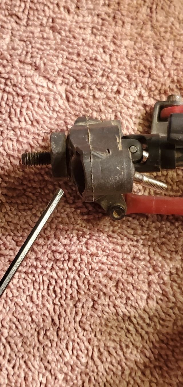

Hi, bought an e-Revo 1/16 years ago, and someone wrecked it while using it.
I decided to take it out of "deep storage" and try to get it operational again with this quarantine fever! I already purchased the 2080 Steering Servo which will be here next week...
I'll provide some pics and questions below, please help! THANKS

- 1. Why won't my front axle stay in the assembly (see compare/contrast pics)
- 2. What's the best method to fix the dislodged red positive wire on my primary battery lead terminal (see pics)? Please lmk any other part(s) I need to get for functionality
You should be able to pull the metal tab out of the connector , they just clip together . One part has a bump that fits in a groove . It will be a bit tight .
They only go in 1 way so make sure you solder on the same side .
As for the axle , there should only be minimal play . My best guess would be the inner bearing has failed . It could have damaged the hub carrier if it siezed .
Take the hub apart to check .
If 1 bearing has gone bad , best to do them all .

As for the axle, your hypothesis was right! Would you be able to shoot me over the part #(s) I need to purchase, and if you're willing a website or two I could check (if that's allowed)? I want to make the order asap to get this machine operational once again after years in hibernation!
You can search specifically for a "TRA7020" but basically any 8x12mm ball bearing will fit. I say basically because there is a width dimension but off hand I don't know. It's somewhere around 4mm.

That ebay set is everything you need to do all 4 corners ! Nice find !!!
Should fix your problem , and get rid of any wheel wobble on the others too .
Traxxas part numbers =
#7034 - 4 x carriers ( 2 x left , 2 x right - front and back are the same ! )
#7033 - 2 x sets of pivot ball / caps ( you need x2 of these to do all 4 )
# 7019 - 4x8x3 ( x2 of these )
#7020 - 8x12x3.5 ( x2 of these )
